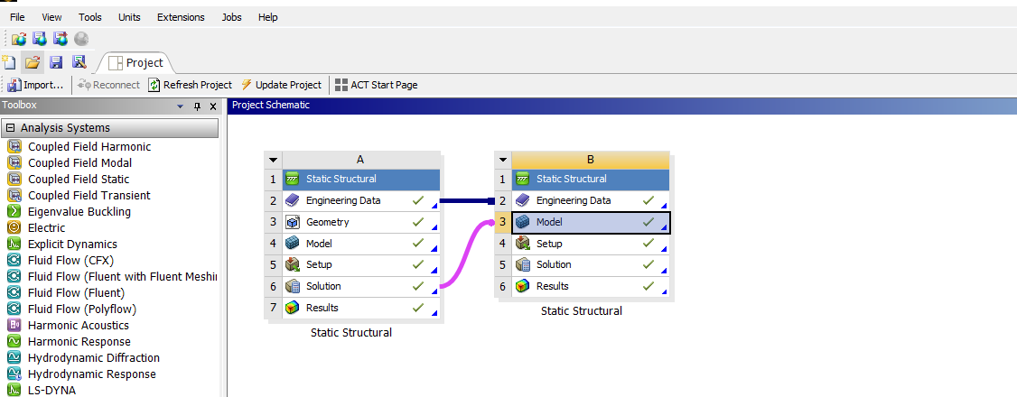

I'm working on an analysis that requires residual stresses created from an autofrettage process.

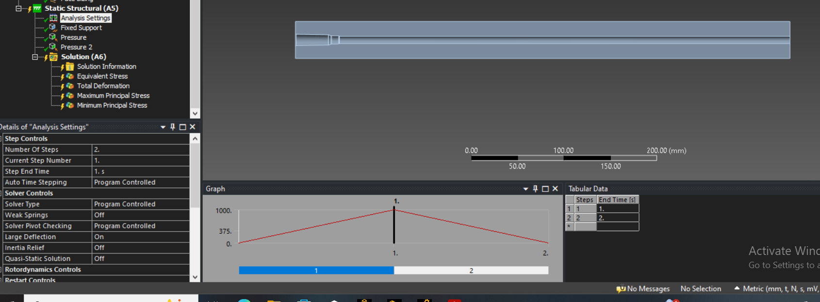

I've seen how it is recommended to using multiple steps instead of linking two static structural analysis.
So i've simulated the autofrettage part just to feel what kind of results to expect.

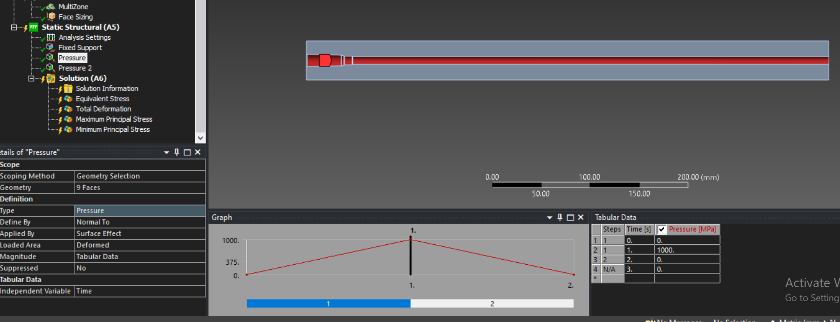

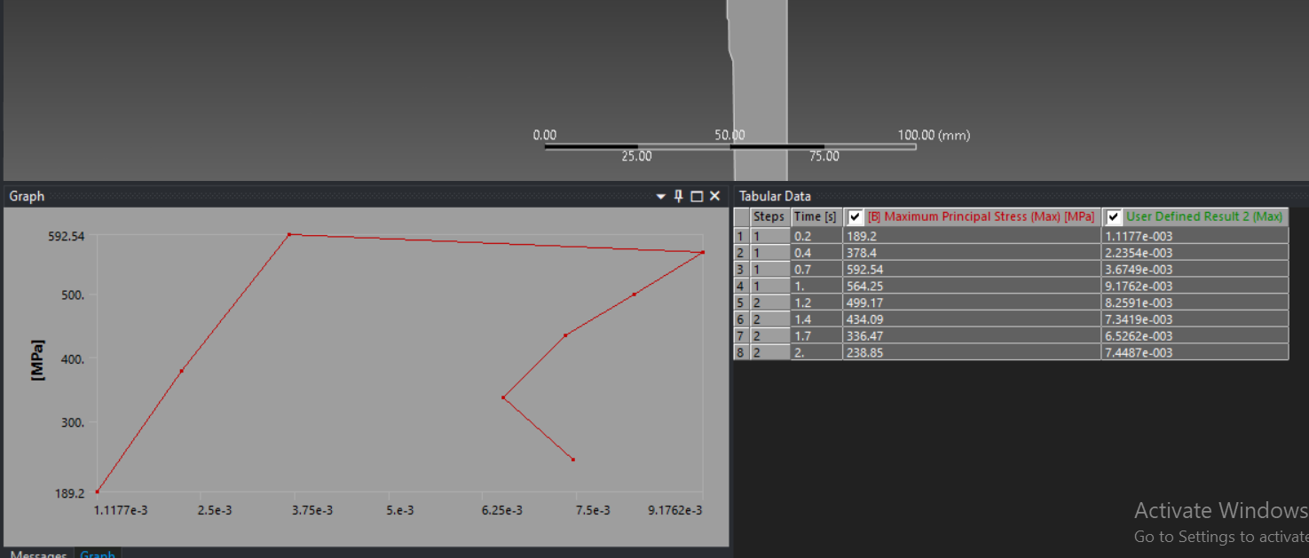

Created 2 steps. step 0-1: ramp the load at 1.5 x the materials yield streng; step 1-2 remove the load so that it is 0MPa at step 2. analysed the results.
Created another sim with 4 steps, adding on the previous sim, step 2-3: zero load; and step 3-4 326MPa (maximum pressure that the component will be subjected to in real life).
In real life, the pressure is loaded by cordinates (x & y) where it varies with x. I feel like I'm messing up somewhere because i'm not getting the results i though i would. Not sure how two pressure loads (step 1) loads the pressure using steps but load pressure 2 (intended to be step 2) using tabular data can meet.

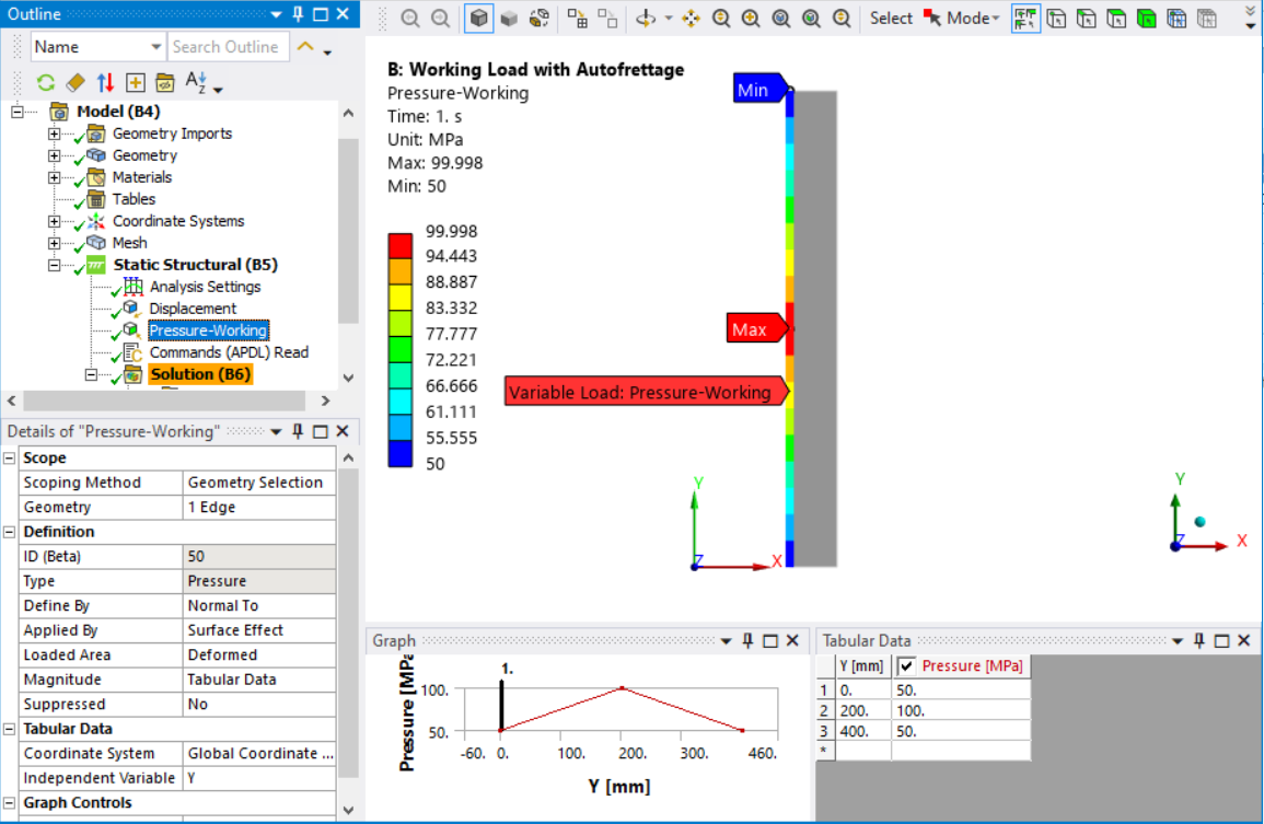

I don’t know how to use Tabular Data with an Independent Variable of Y (in the axisymmetric model) as Step 3 of a multistep single analysis. There may be a way using APDL tables and if there are, perhaps someone will reply with that information. Instead I used two analyses and used the INISTATE command to write out the state of stress and strain after the autofrettage pressure had been applied and removed in a two-step first analysis, then used the INISTATE command to read that state into a second analysis to apply the working pressure load in step 1. See ANSYS Help for more information on INISTATE.

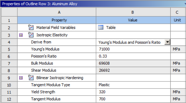

I used an Aluminum material with the following properties. Note I have a plasticity material model which is required for a residual stress problem.
In analysis A, the internal pressure ramps up to 150 MPa in step 1 and ramps down to 0 in step 2. The equivalent plastic strain on the inner surface is 3.4% for the 150 MPa internal uniform pressure. Note that 100 MPa of uniform pressure does not create any plastic strain in analysis A.

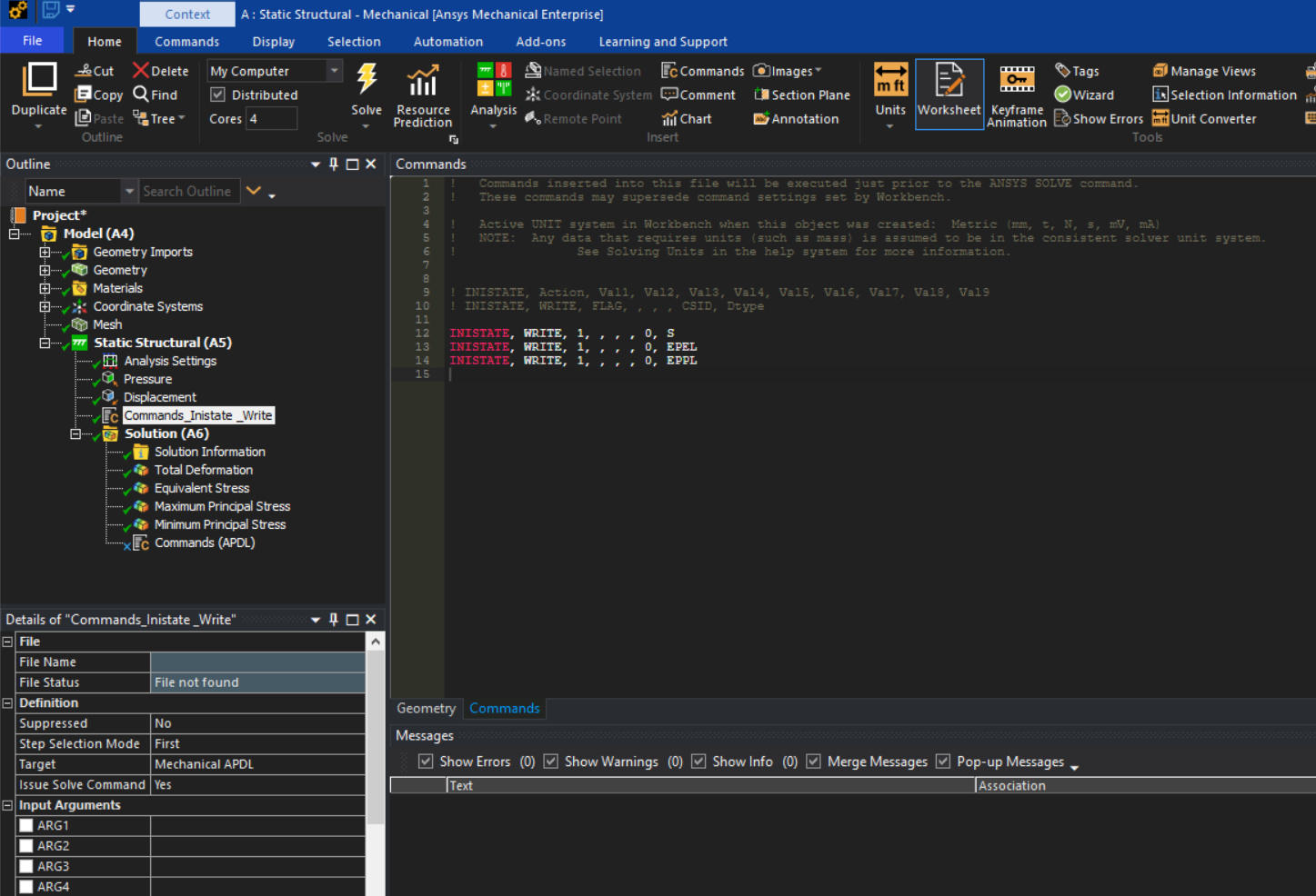

There are two Command objects in analysis A, the first under Static Strucural writes the state of stress, the elastic strain and the plastic strain at the end of step 2 to file.ist.
INISTATE, WRITE, 1, , , , 0, S
INISTATE, WRITE, 1, , , , 0, EPEL
INISTATE, WRITE, 1, , , , 0, EPPLThe second Command object is under the Solution branch and copies the file up a couple of levels in the folder structure.

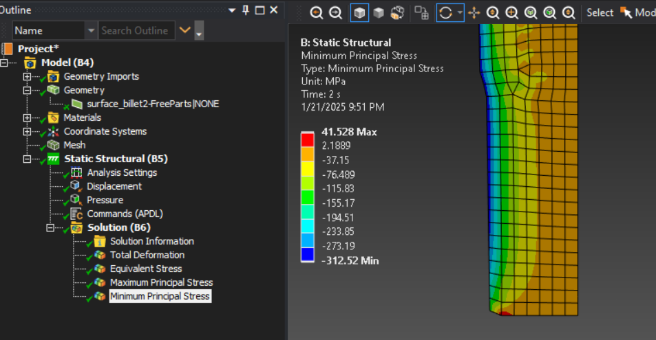

In analysis B, I created a “working” pressure load as a fuction of the Y axis.
The Command object under Static Structural has the following command:
/COPY, file, ist, ..\..\, file, ist
INISTATE, READ, file, istI found these commands in this reference.

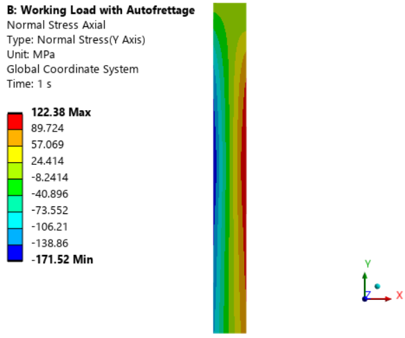

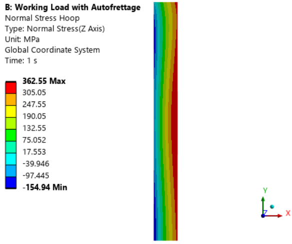

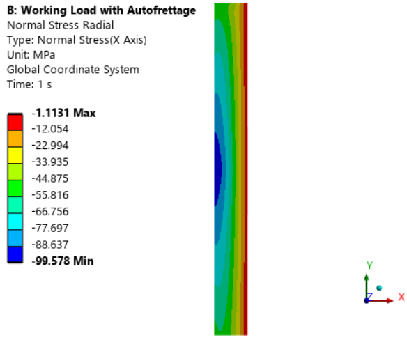

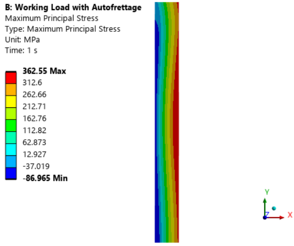

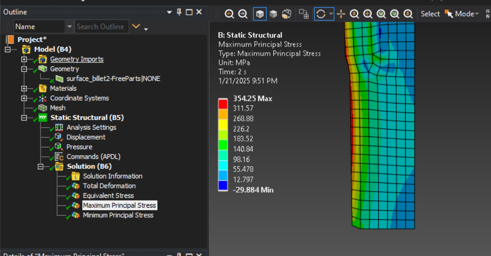

Below are some images of the stress at the working pressure load using the initial state from analysis A.
Note that the inner wall (left edge) is all compressive stress in the Max Principal plot. This is what prevents fatigue cracking.

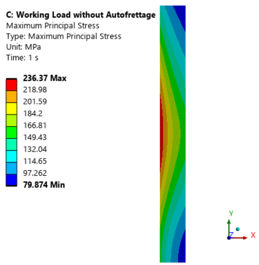

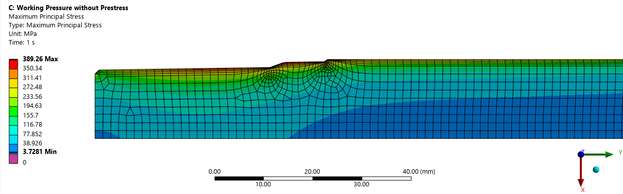

Contrast the last plot with the stress from that same working pressure if there was no residual stress from the initial treatment of the autofrettage pressure. Notice that the inner face is all tensile stress which is a risk for fatigue cracking.

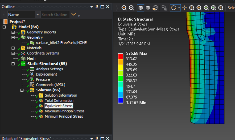

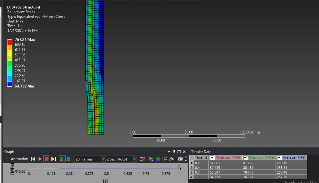

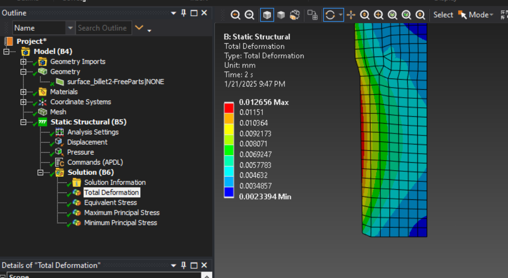

I'm back, I have a question after trying this. Why does the solver work when the surface has a Y axis. It had an error when i initially tried to model it with the x-axis.

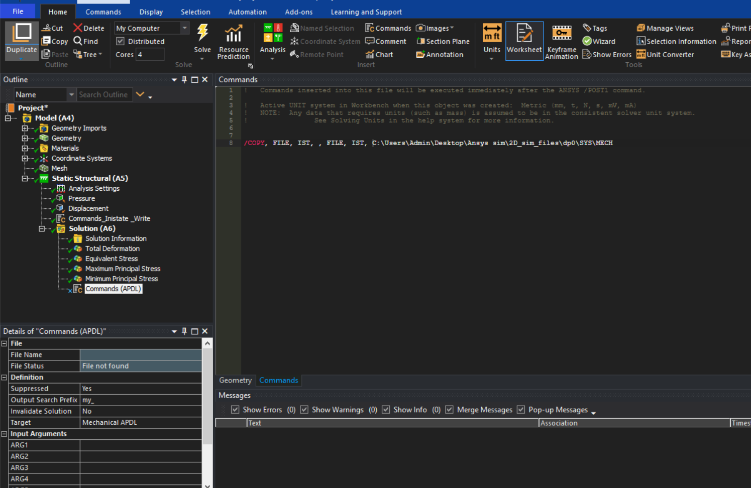

When i try the method with your command guidance, it fails to load in analysis B:
above is how i typed out the command.
I had to suppress the above, not sure what i was doing wrong here.

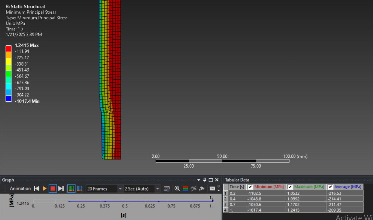

I from here on I tried to use the method in the video (link shared above). Linking the stats like this.
Reading from file, ist (above). Then doing the normal setup up before solving.

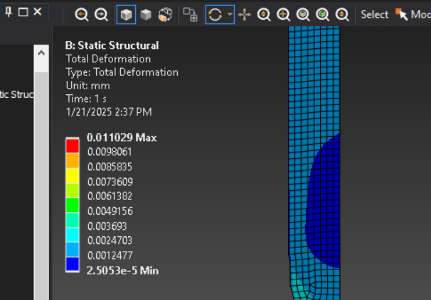

total deformation, seems very low, not sure if I'm in the ball park 🧐

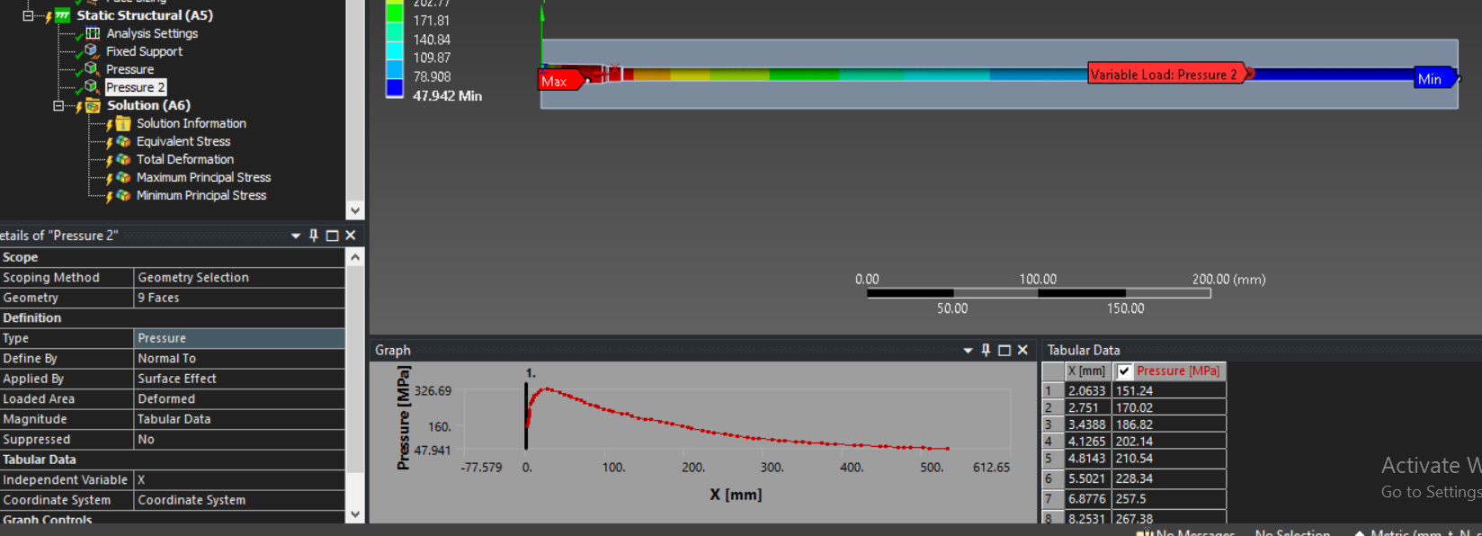

Above is the the variable pressure with the y being the independent variable
Without autofrettage🤔
Figure is lower than when i had initially modeled with the axis in the x-axis. I wonder why. I previously got 706MPa as the maximum Von Mises stress.
Just thought i should give feedback as to how things went.

Why does the solver work when the surface has a Y axis? It had an error when i initially tried to model it with the x-axis.
Ansys structural developers arbitrarily chose the Y axis as the axis of revolution. All the code assumes that. If you prepare geometry using the X axis by mistake, the code is still going to revolve the geometry you provide around the Y axis and you will solve a completely different model to the one you think you are getting and the answers will be completely wrong, so there is no point in comparing those results with results for geometry that has the axis of revolution on the Y axis.

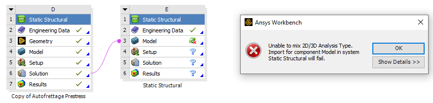

I dragged a Static Structural out to make analysis E then I dragged the Solution cell from D (a duplicate of A) and dropped it on the Model cell of E. This created the following error message, even if I set the Geometry property of analysis E to 2D before the drag and drop.
I'm using ANSYS 2025 R1. I recommend you use two unlinked Static Structural models with 2D Analysis Type on the Geometry cells and get the INISTATE write and read files to transfer data from the autofrettage prestress model to the working pressure model.

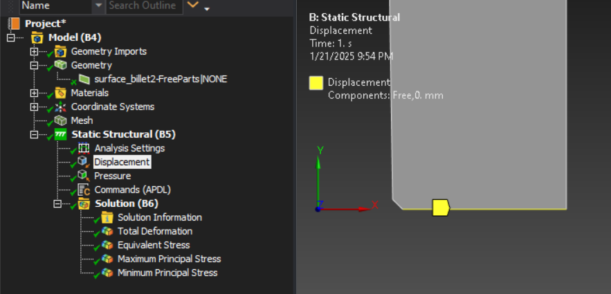

Which edge has the Displacement BC X = Free, Y = 0? I guess you used to top edge because on the bottom left corner, that node is moving in the Y direction. That may be correct if that is the free surface of the barrel. You don’t want both the top and bottom edges to be constrained, just one is correct.
January 21, 2025 at 4:53 pm
201182080
SubscriberHi again
That is very interesting to know. Makes me wonder if i can still use Ansys for a simulation where the component is heated and allowed to deform due to gravity.
The left corner is a chamfer. it is not loaded. I used the bottom of the component (edge closer to the chamfer).

SubscriberSo when using the copy function, i shouldn't create a directory to where the solver information is created?
I must keep it to "..\..\"?. Before copying "E:" directory into the command, I had used yours as is but failed to load information. Maybe I must run through all my steps again.
The benefit of using ..\..\ is that it always works, even if you copy the Workbench project to another folder or drive because it is a relative address.
If you edit the command in the Solution branch, I found I had to right click on the Solution and Clear Generated Data to get the edited command to be used.

I was able to get the setup to run with all the inistate commands provided above.
Please see below the difference in results from the inistate command you shared vs the one i used from the attached link:
above is the constraint on the bottom edge
such a big difference in the results from both inistate commands

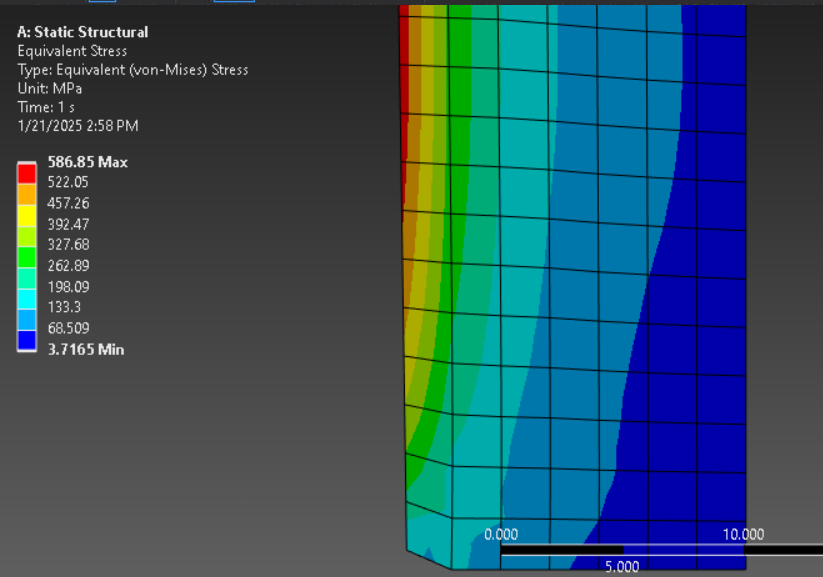

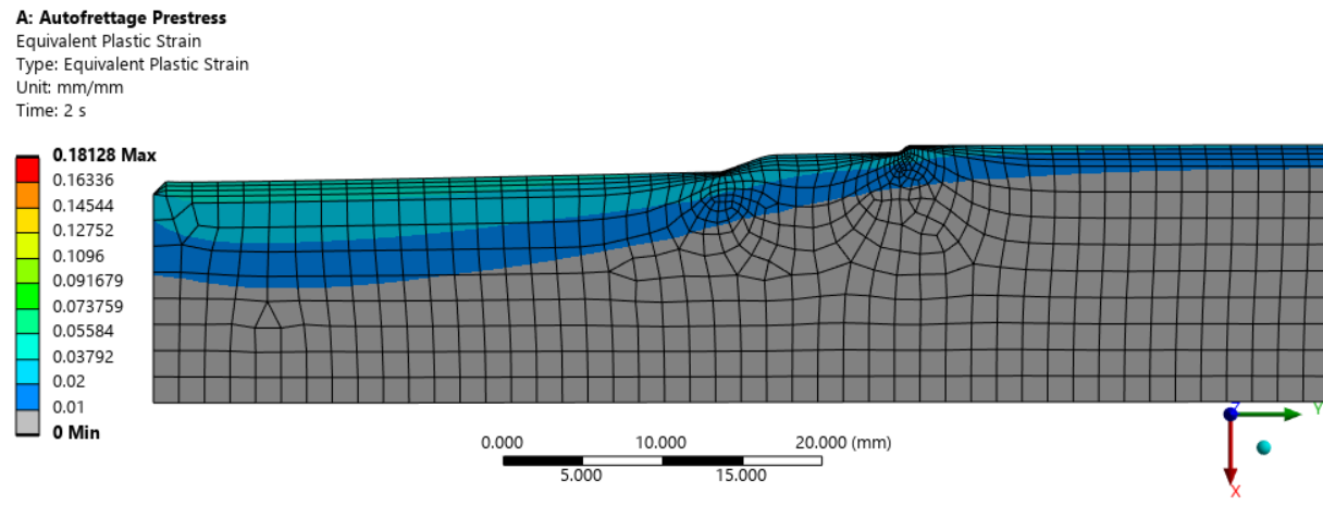

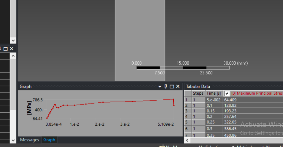

SubscriberDid you plot the plastic strain in analysis A at the end of the autofrettage pressure load to show that the barrel had exceeded the yield strength and developed some residual stress?
January 22, 2025 at 1:49 pm
201182080

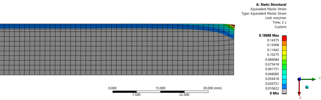

SubscriberThis is my EPEL1 and EPPL1 below.
What is concerning is that it doesn't even reach the yield limit (750MPa). I'll double check my tangent modulus value.
I did a bit of hand calculations for a thick wall pressure vessel. Taking the part of the component where the outer diameter and the inner diameter are parallel. Thickness t/D is > 0.05. Created a 2D sheet of that part of the barrel and subjected it to a pressure value and measured the results. The only hand calculation that comes close to the measured simmulation results is the hoop stress.
January 22, 2025 at 2:37 pm
peteroznewman

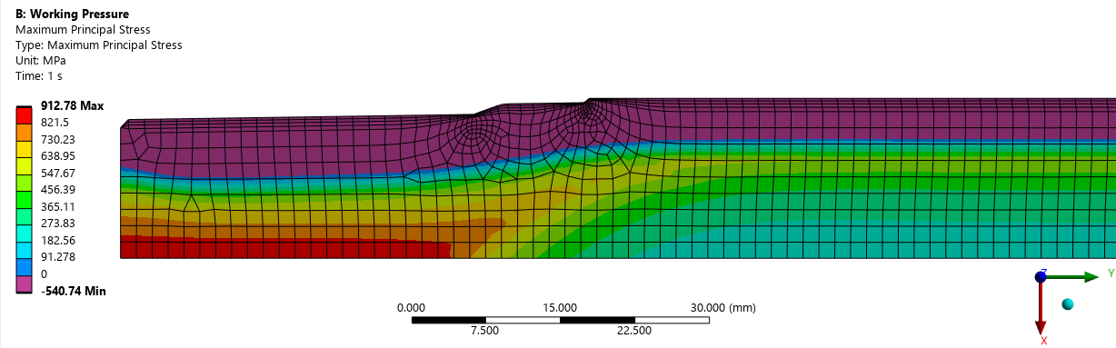

SubscriberYou could change the pressure in step 1 of analysis A to higher values until you get a good amount of plastic strain. Make a contour plot to see how far that goes through the wall thickness. If you set the pressure too high, the simulation will fail to converge.
If you save a .wbpz archive file using File, Archive in Workbench and upload that file to a file sharing site such as Google drive or OneDrive or Jumpshare and post a link to that file in your reply, I will take a look at your model.
January 22, 2025 at 9:08 pm
January 22, 2025 at 11:15 pm
peteroznewman

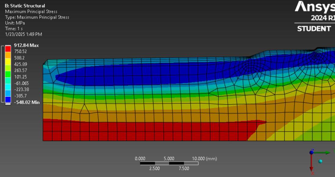

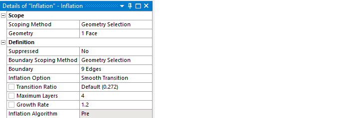

Subscriber- Analysis Settings, Large Deflection = On for both analysis A and B.

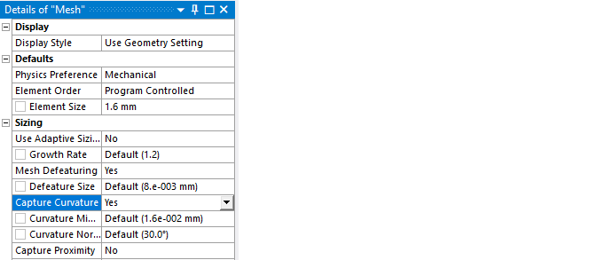

- Mesh Element size = 1.6 mm and the settings shown below to improve fidelity of the mesh to the geometry.
- Use an Inflation mesh control like this:
- With those changes, there is between 1 and 2% plastic strain along the length of the barrel in analysis A.
- It looks like a small chamfer would be helpful at the other end, but in reality, there would be a cap or connectior on the end to apply the pressure.
- Under a the working pressure, notice that the entire length of the inside surface of the barrel is in a state of compressive stress. Note that this is a one step analysis, not a two step.
- Duplicate analysis B and in analysis C, suppress the Commands (APDL) object and solve. Notice that the inner surface of the barrel is in tension.
- Additional note: When I did the same mesh controls on both A and B, I got a different mesh! I wanted the mesh to be identical, so I deleted A and duplicated B so that I had the identical mesh in both systems. INISTATE can map between different shaped meshes, but I didn’t want to get into that.

- I had initially did the simulations with large deformation being on, I got a warning message that "large deformation effects are active which may have invalidated some of your applied supports...." so I ended up switching it off as I was unsure if this negatively affects the quality of the results.
- From point 2-9 I was able to update the details as guided and got a max plastic strain of 0.1895.
- From point 10-13 i got similar resulst:
