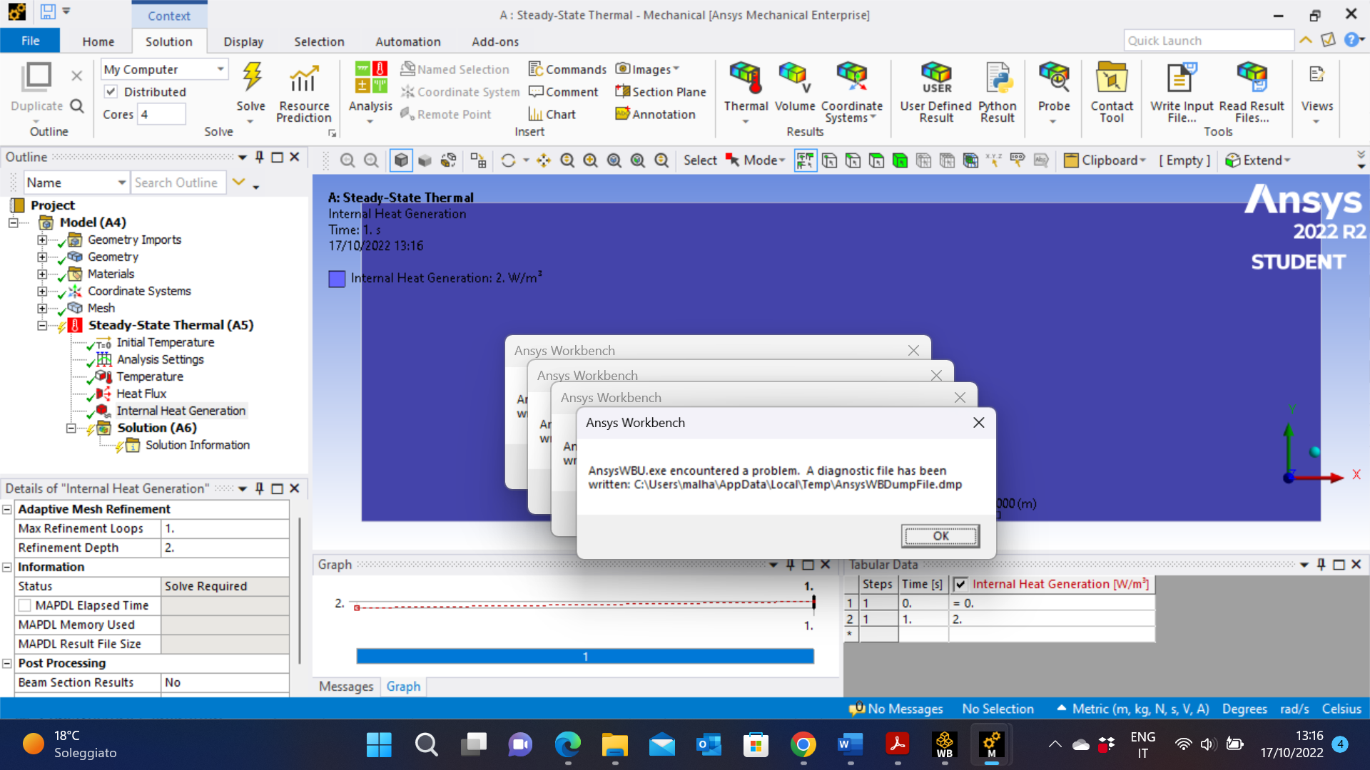

My mechanical Ansys crashes every time a run a simulation (even if it's very basic). I am suspecting it to be an issue with graphics however it meets the minimum hardware requirements of ANSYS student version. I am facing this issue even after updating all the drivers.
My Processor: AMD Ryzen 5 5600U with Radeon graphics
Also, once in a while I get an error message as shown:
Kindly help or guide me regarding this issue.

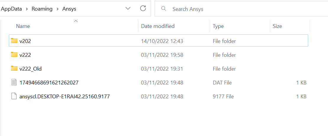

Try reseting the Appdata. Follow the steps below to reset ANSYS Appdata:
- Exit ANSYS, if you are using it currently.
- Go to Start > Run
- Enter %APPDATA%
- A folder explorer window will open
- Open the Ansys folder. Look for the Ansys version you are using, for example, v221, and rename it to v221_Old
- Launch ANSYS and refresh the project

Yes, a new file should get created once you restart the workbench.
Please try the following, and see if this works:
- Make sure you meet the minimum hardware requirements mentioned here: Download Ansys Student | Workbench-based Simulation Tools
- Make sure to update all the drivers.
- Please start a new project on a different workbench file and see if the same problem persists. The model can get corrupt, so that may be a reason for this problem.
- Try to install a different version of Ansys and see if the problem still persists.
