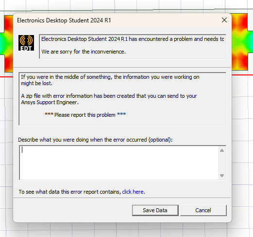

Crash every time I use Ansys EM
    • alan.marcia
      I'm having this issue. How can I fix this?

    • alan.marcia
      Hi, I'm using the Maxwell2D to analize the E-Field between two silicon cavity. This errors occurs casualy when i change the shown graph or when i move some element in the design mode.

    • alan.marcia
      No, unfortunately it happens with any model I try to simulate. I have already tried uninstalling and reinstalling the software, but the problem has not been resolved.

    • alan.marcia
      Yes, but always in differents step, sometimes during the simulation, sometimes when i'm watching the result of the simulation.

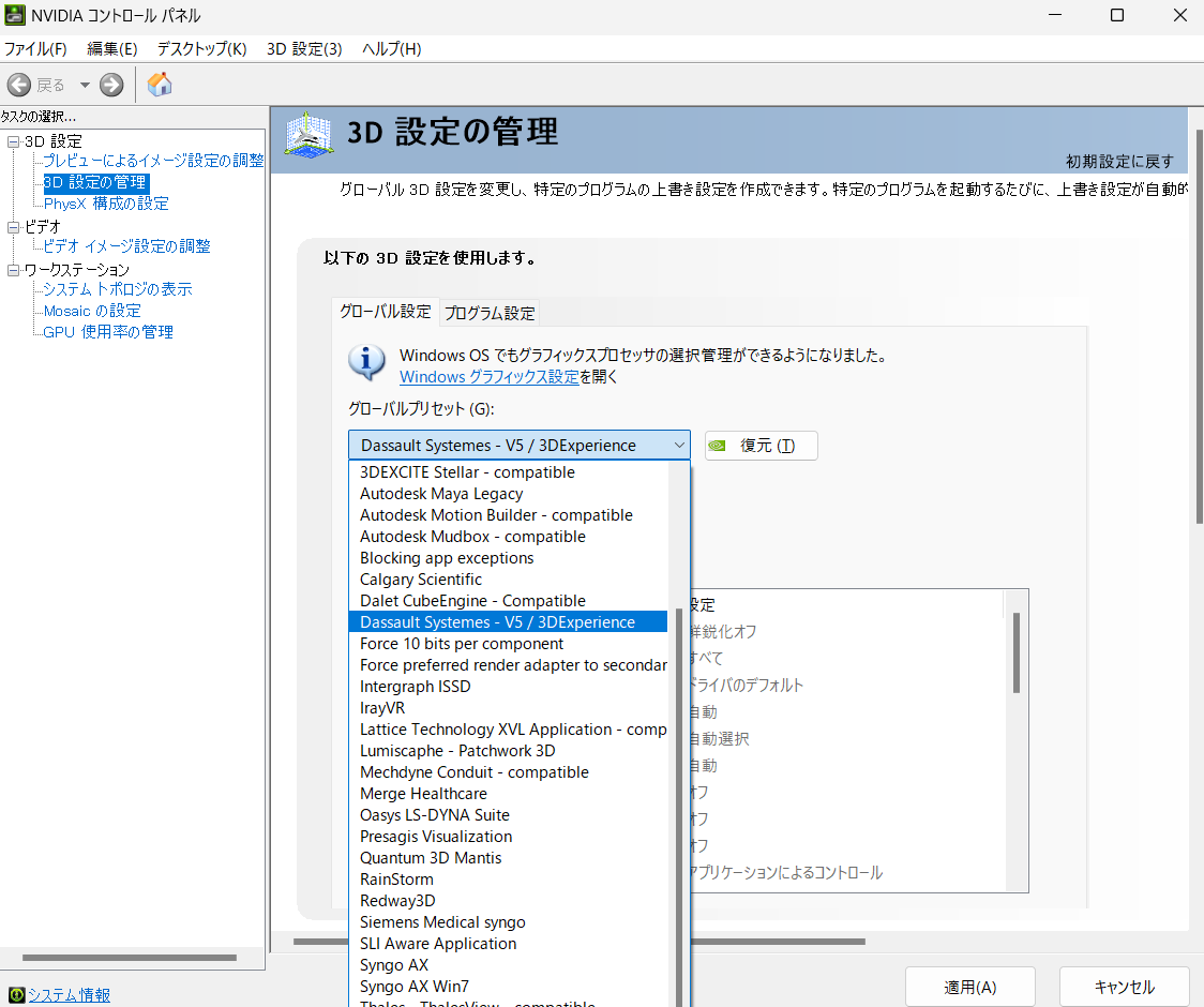

    • Takeshi Itadani
      Open the NVIDIA Control Panel, go to Manage 3D Settings > Global Presets and change the Base Profile to “ Dassault Systemes - V5 / 3DExperience ”, reboot the device and make sure the settings are in the same state as they were after the change before operating AEDT. Please try to operate AEDT after restarting the terminal and confirming that the settings have been changed.
