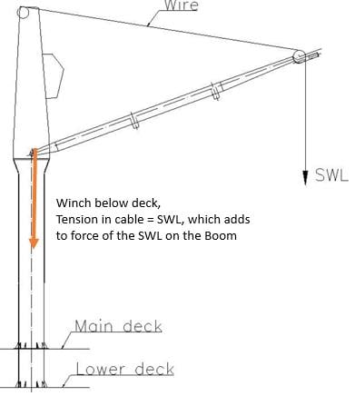

If I model the pedestal only and apply force like below, do you think that it can be the same like real working condition
I use fix support at A and B (as the connection between pedestal and decks)
Acceleration C is a gravity (self-weight of pedestal),Â
Foundation load D is the total cabin's load, I put this force at the red surface
Regarding to SWL, I change this position from the top end of crane's boom to the red surface, so that at the red surface there are a force F = SWL and the moment M = SWL*Boom_Length
For the weight of the boom, I will do the same as the SWL (I don't put it here)
As you said, wire just need when calculate the strength of boom, so I will neglect it in this caseÂ
Could you give me any comment
Thanks in advance
September 18, 2018 at 4:23 am
peteroznewman
SubscriberBetween the Pedestal and the Cabin/Boom-pivot assembly, there is a massive bearing to let the Cabin/Boom rotate about the Pedestal. I think you have correctly drawn the Free Body Diagram for the forces going into that bearing at the top of the pedestal if the winch that lifts the SWL is in the cabin. But if the winch is below deck and the cable goes down the center of the pedestal, then there is an additional down force of SWL. The pedestal has to support the SWL at the end of the boom AND the SWL tension in the cable. If the winch is in the cabin, the tension in the cable is an internal force that does not add to the forces going through the bearing and into the pedestal.
If you want to limit your analysis to just the Pedestal, then when you include the down force of the mass of the boom and the moment for the distance to the boom center of gravity, you will have a representative load.
I expect high stress where the pedestal meets the two decks. You can consider moving the fixed support further away from the pedestal and modeling some of the connection between the pedestal and the two decks so the peak stress in the model is not at a fixed support.
Peter
September 22, 2018 at 10:57 am
thanhttdt
SubscriberHi Peteroznewman,
Thanks for your support, I will seperate boom and calculate reaction force at the connection between boom and pedestal, and tensile force in the wire as well.Â
And as you mentioned, winches are stored in the cabin.
Do you think my analysis is ok?
Thanks in advance
September 22, 2018 at 11:20 am
peteroznewman
SubscriberThose a good clean Free Body Diagrams. You will do sum of the moments about the boom pivot to solve for T_wire, and then sum of the forces in X and Y to solve for the R_boom force components. Your analysis is okay.
