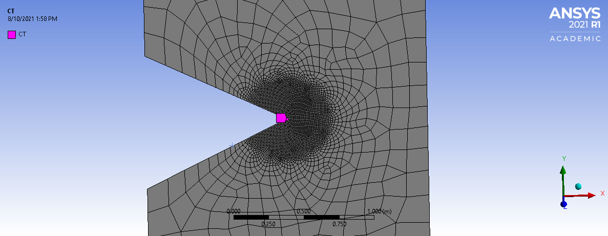

SubscriberWhen I am selecting crack tip for a fracture mechanics probelm its not getting accepted can someone help me find the error
August 11, 2021 at 4:50 amBenjaminStarling
SubscriberYou may not have your analysis set up for 2D. When the analysis is set up correctly for 2D, the property will say Crack Tip, not Crack Front. This option is set in the Workbench, in the Mechanical Model cell/system properties.
August 11, 2021 at 6:00 amAmith_Anoop_Kumar
SubscriberThank you
