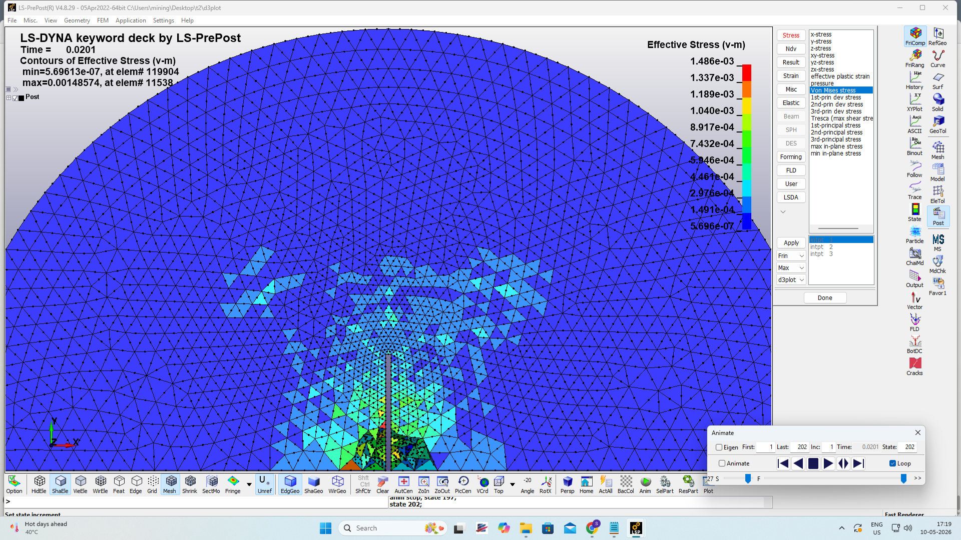

    • julmeshreeya2210
      Dear Sir/Madam,
      I hope you are doing well.
      I am currently working on a Notched Semicircle Bend test simulation project in ANSYS LS-DYNA and would greatly appreciate your guidance regarding crack propagation modeling.
      In my model, I am using MAT_ELASTIC along with MAT_COHESIVE_MIXED_MODE and MAT_ADD_EROSION to simulate crack initiation and material failure under three point loading. However, despite implementing these material models, the crack is not propagating as expected during the analysis.
      I suspect the issue may be related to the erosion parameters, cohesive zone calibration, mesh dependency, or contact/timestep settings. Since I am relatively new to this type of coupled damage modeling, I would be very grateful for any suggestions or best practices you could share.
      Specifically, I would like to seek guidance on:.
      Appropriate failure criteria for realistic crack initiation and propagation.
      Proper setup of MAT_COHESIVE_MIXED_MODE parameters.
      Recommended element types and mesh strategies for crack tracking.
      Possible reasons why cohesive cracks fail to propagate .
      Common mistakes or numerical stability issues to avoid in LS-DYNA.
      Thank you very much for your time and support. I look forward to learning from your experience and insights.
      Best regards,
      Shreeya Julme
        Please post in a new thread for attention.
