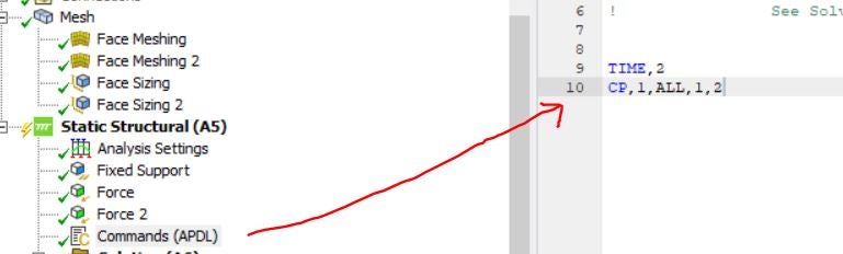

Is possible use CP command in specify Time or STEP?
Take example, in time 1 node1 and node 2 DOF is independent,but in time2 i want to couple their all DOF.
I try use following command in workbech,but CP command already work in time1.

Ansys EmployeeHi
Introduce multiple steps, and say step 2 starting from time = 2s.
In the command snippet we can choose to activate the commands for step 2 (step selection mode and step number=2), which would start from 2s. See here:
Also the time command is not needed .
All the best
