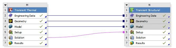

I'm trying to simulate deformation due to thermal expansion in multilayered fire-resistant glasses. At the moment my model consists of two glass panes with an intumescent interlayer in the middle. (There is also a steel plate in the model, where the glass is lying on, which serves as a heat source via its body temperature)
My workbench looks like this:
And at the moment I calculate the thermal part first and after that I calculate the mechanical part. And as you can see, for now the simulation works, but there is still a big difference to real world experiments and thats why I want to couple the simulation step by step if this is possible.
First, the expansion of the intumescent material is huge, it's greater than 10x (1.4mm at the start, 14.8mm at the end of the experiment). Also, the material properties change with temperature. Finally, when I look at the end result of the the structural simulation, the edges of the glass lost contact (bent upwards) sometime during the heating process, but this wasn't considered in the thermal analysis.
For all these reasons, I want to couple the two systems step by step, so after the first thermal time step is completed I want to give the result to the structural system, then use the result (which is mainly the change geometry) as input for the next time step of the thermal system and so on.

thank you for your fast reply. I will attach a few pictures to further illustrate my problem:
1) The contacts are bonded for both glass/intumescent contacts and frictional for the glass/steel contact (since the glass probe is lying on the hotplate in this experiment) (friction coefficient 0.2)
2) a project overview with a temperature distribution at random timestep:
3) shows the last time step in the structural analysis with the intumescent fully expanded:
At the moment, as I said in my initial post, I always complete the thermal analysis first, then I use the temperatures calculated at each timestep in the structural analysis via “Imported Load” and perform the structural analysis. The way I try to compensate for the expansion in the thermal analysis is that I use a adapted λ (I divide the λ that the intumescent material would have at a certain temperature by the expansion rate).
So but what I want is as follows:
- Calculate time step 1 in the thermal system
- transfer the result to the structural system, calculate the time step there
- transfer the structural result back to the thermal system (if the intumescent has expanded, then the way the heat has to go through is longer, therefore the λ has no longer to be adapted)
- repeat until it is done
Can I do that somehow?
