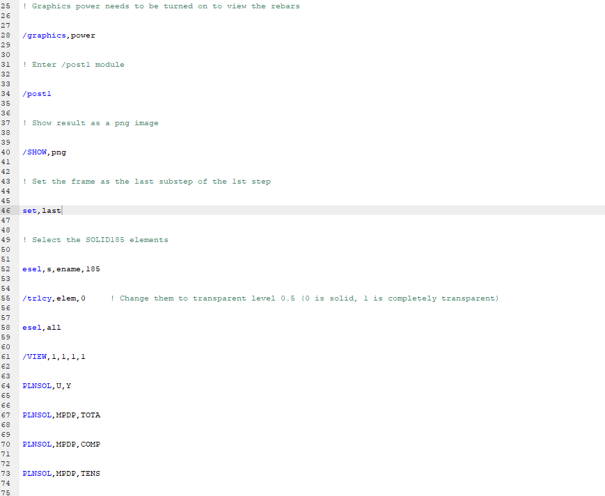

      Hmm, what about using these commands:
      It works for me:
      If it still doesn't work, maybe checking the concrete model? Is it possible you are using the Regularized Elastic Damage Microplane Material model? You can find more info about the material model here: https://ansyshelp.ansys.com/account/secured?returnurl=/Views/Secured/corp/v201/en/ans_mat/microplane.html?q=microplane. You can also do a search "output" in that website to find related information.

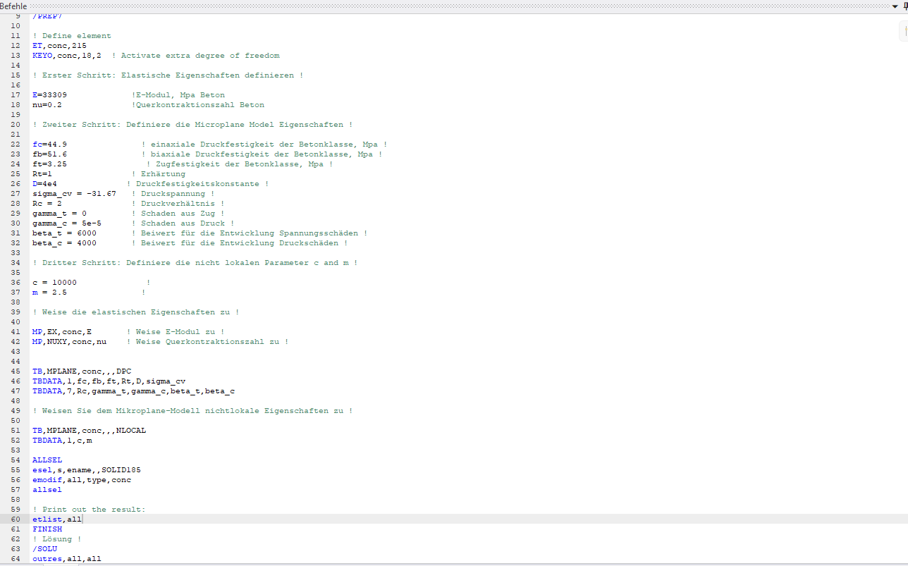

      I already try your latest snippet but it still wont show..I'm using couple damage-plasticity microplane model, using CPT215 element with 2 extra DOF, here the snippet
      Or is there additional step or something that I have to activated?
      when I check at solution information it says:
      *** WARNING ***                         CP =       0.969   TIME= 15:43:50
       The requested MPDP data is not available.  The PLNSOL command is
       ignored.
    • Wenlong
      Apart from your command snippet, I also have the following to assign the material to concrete, and request all the outputs. You can try putting it below your commands and see.
      Wenlong

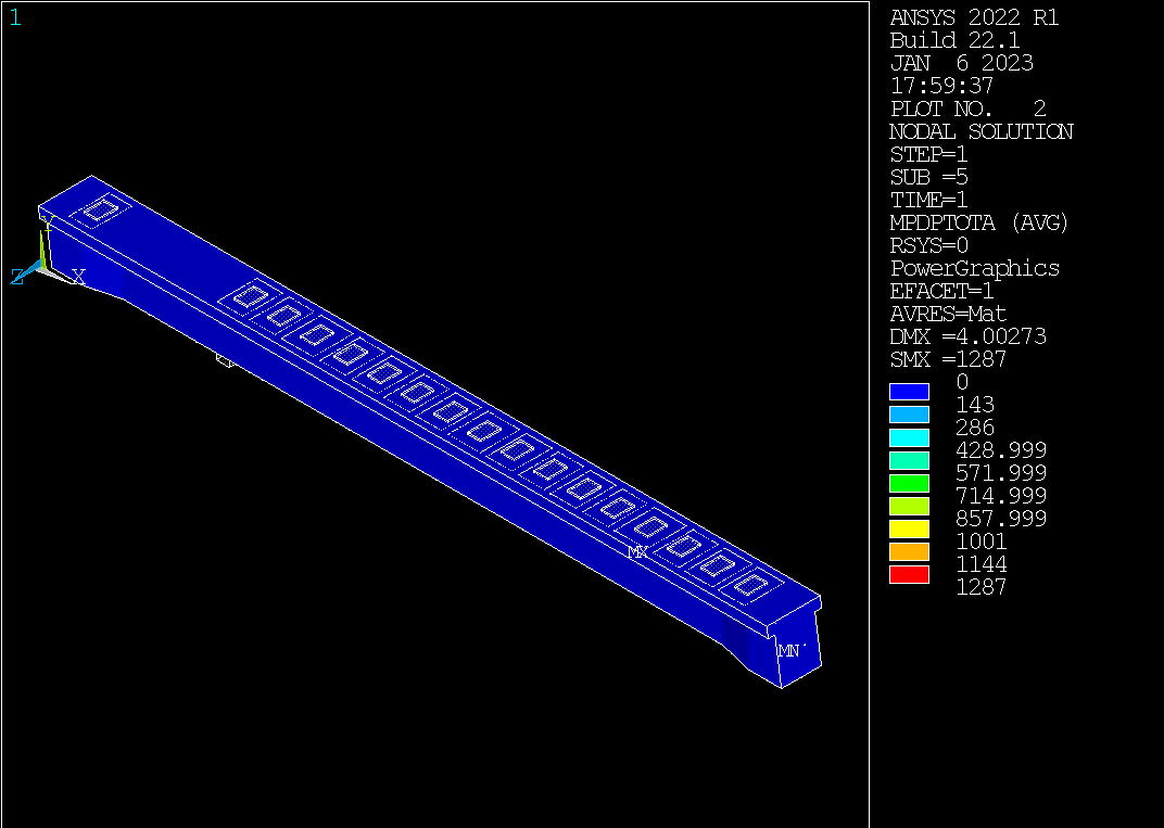

      Thank you, finally it works, here the visualisation
      But another problem comes up =(, when I change the mesh size..the damage wont show, please advice

    • gigihmprayogo
      @DrDalyo, if you are still unable to plot the damage, try add command "set,last"  on your post prep command..now i'm able to plot the damage
