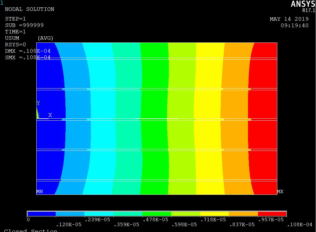

    • dinhan0394
      I tried with ANSYS 17.1 and 19.2
      Here is result:

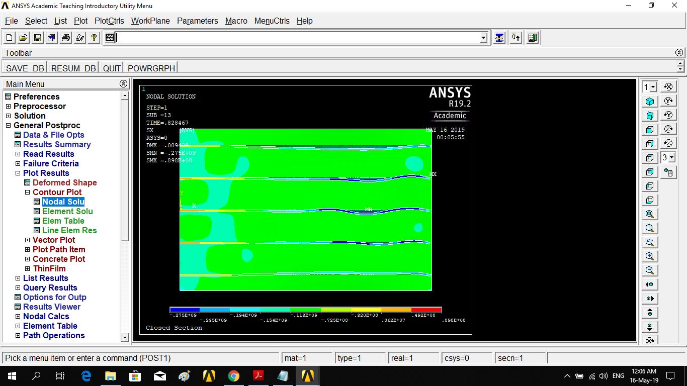

    • elmalaki
      i solve the code on ansys 19.2 and the same problem still existing
      the number of substeps in solution not exceed 3 substeps and the deformed shape not matching with the correct result

    • jj77
      The results are unconverged and not to be taken seriously AnPham and elmalaki  - thus the solution does not complete.
      If we look in the logfile then we can see that it fails:
       *** WARNING ***                         CP =      70.266   TIME= 092:50
       The auto time stepping (AUTOTS,ON command) does not support arc-length
       method.  The auto time stepping has been turned off.
       *** WARNING ***                         CP =     152.281   TIME= 0934
       A reference moment value times the tolerance is used by the
       Newton-Raphson method for checking convergence.  The calculated
       reference MOMENT CONVERGENCE VALUE = 6.620861061E-03 is less than a
       threshold.  This threshold defaults to 1.0-2 or is specified as MINREF
       on the CNVTOL command.  Check results carefully.
       *** WARNING ***                         CP =     177.578   TIME= 093:47
       The unconverged solution (identified as time 1 substep 999999) is
       output for analysis debug purposes.  Results should not be used for
       any other purpose.

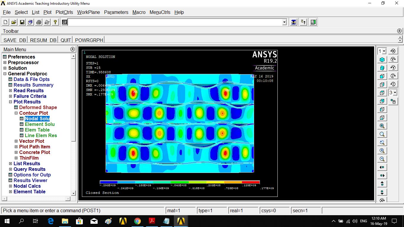

      i tried to solve the problem again after changing the code BC ans make a rigid edge, the solution was completed well but the resulted deformed shape was wrong
    • elmalaki
      this is the required deformed shape
    • jj77
      Use the upgeom command to generate a plate with imperfections based on this buckled mode shape that you show. Then do nl buckling perhaps push it a bit more also. The imperfection will trigger that buckling mode
      There is lots of info about this on the Internet, just search for upgeom and apdl
