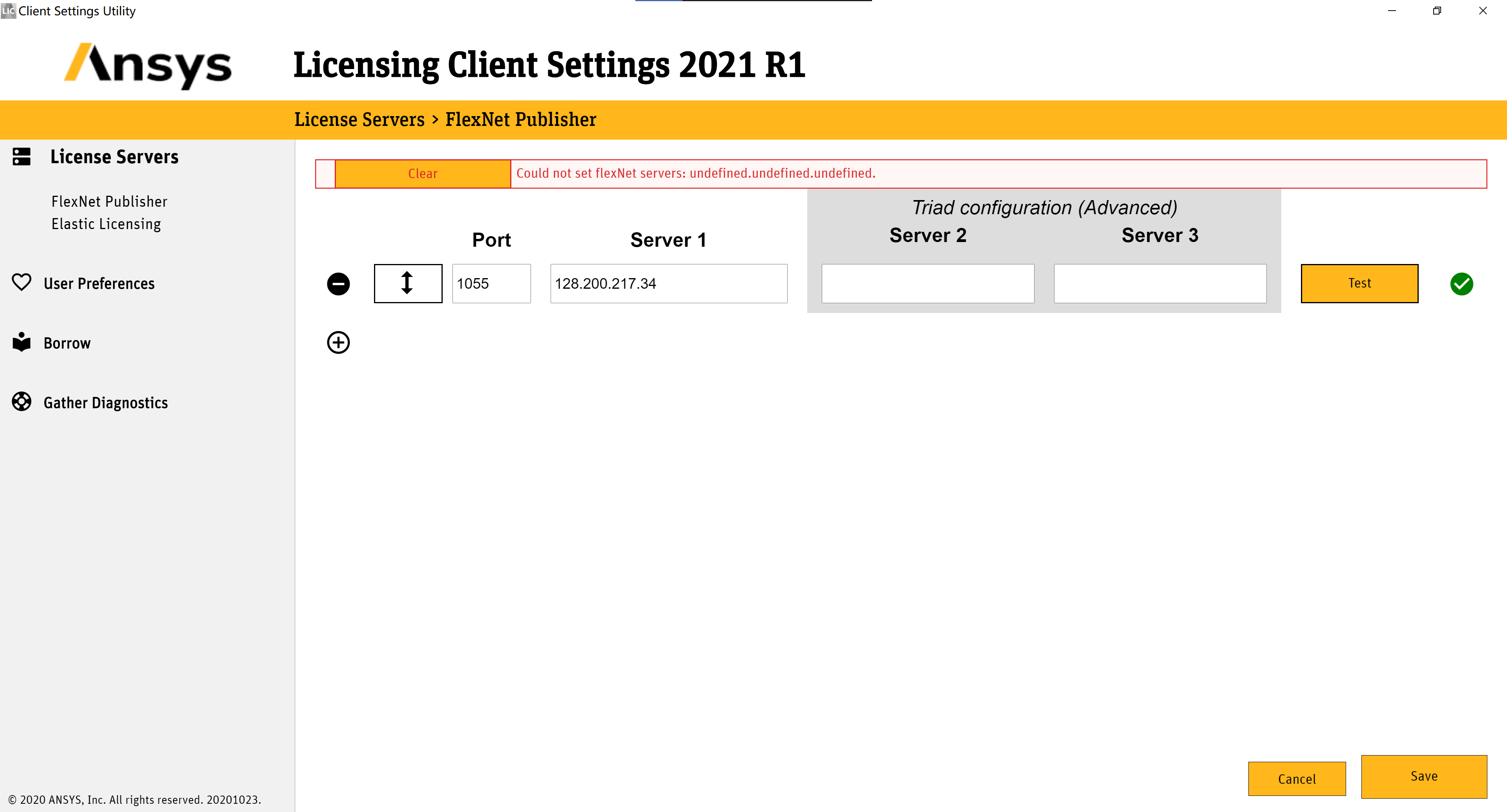

SubscriberWhen I am trying to activate the product under a student license, the connection is successfully tested, but when clicking save the prompt "Could not set flexNet servers: undefined.undefined.undefined." appears every time. Is there any solutions for this issue?

Ansys EmployeeIf you are using the free student software, you should not have to Specify the License Server.
If you are having licensing issues with the free student version, may I suggest uninstalling and then
rename c:\Program files\Ansys Inc to Ansys Inc_old
Then download and install again.
