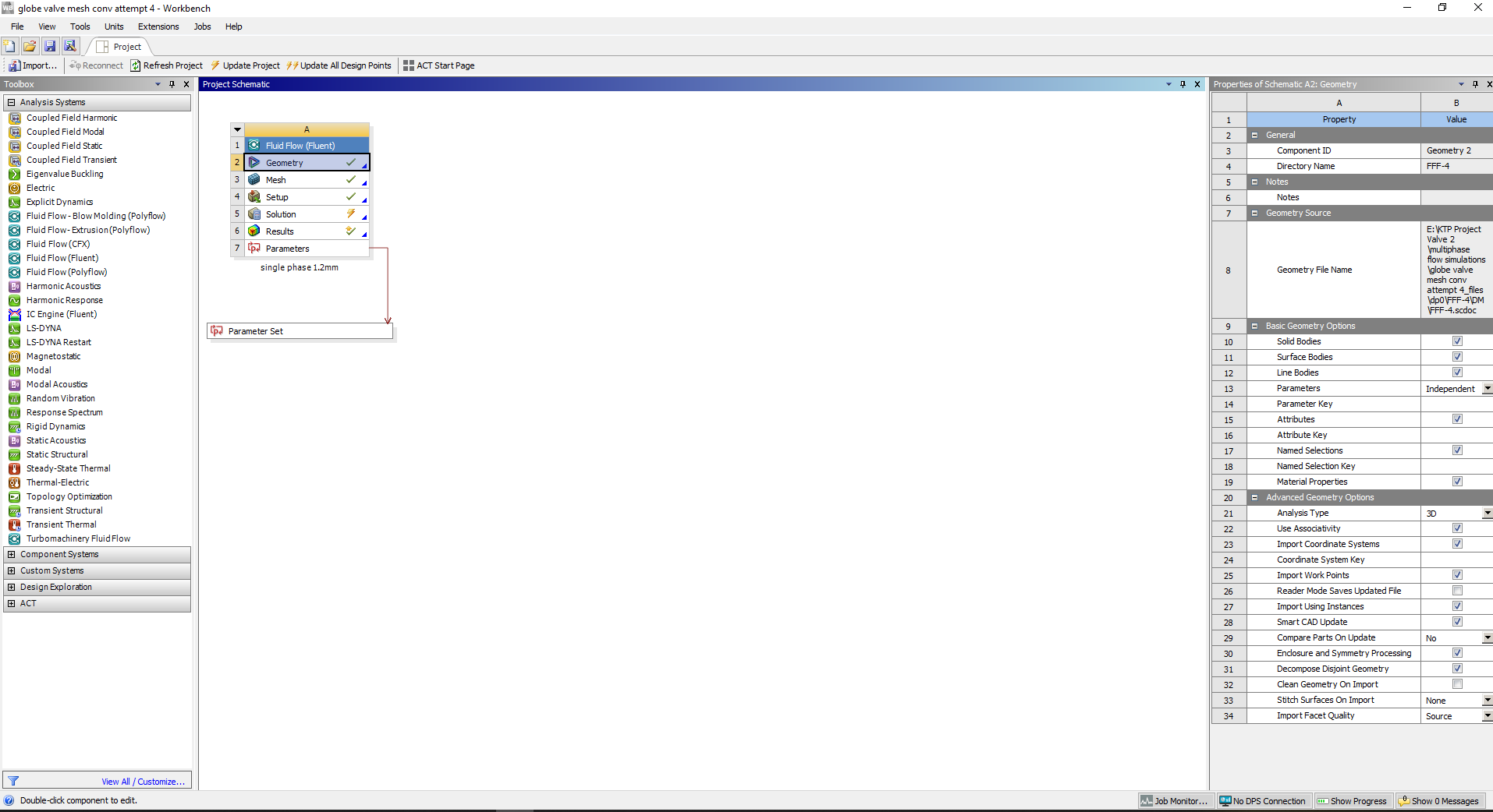

I have created a new case and created the geometry of a valve using Spaceclaim. It was working fine at that time and I Ran the analysis and closed the case. When I reopened the same workbench file, for some reason Spaceclaim is not loading. I have tried in a new workbench case and SpaceClaim is initially working but after closing and reopening the same file, the SpaceClaim is not loading again. when I use the same file on another computer, it works fine. I am using a research license.
I have attached a screenshot of what the project looks like after reopening.

Ansys EmployeeCan you please run CAD configuration manager once again and check if works.
You can also check following post.
Can't import Spaceclaim Geometry into Fluent ÔÇö Ansys Learning Forum
Regards Keyur
February 23, 2022 at 9:07 amMuhammad_atif
SubscriberHi Thanks for your reply. I tried running CAD manager and checked spaceclaim option but no improvement!
February 24, 2022 at 3:51 amKeyur Kanade
Ansys EmployeePlease try reinstallation.
