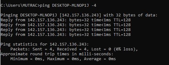

      If you open up CMD Prompt, then issue the following command
      ping DESKTOP-MLNOP1J -4
      what do you get ?

      I am able to ping my computer/server using IPv4
      ping
      However, there is not an 'update' folder that I can find

      Hi Mutrac,
      Thanks for the info. This looks good.

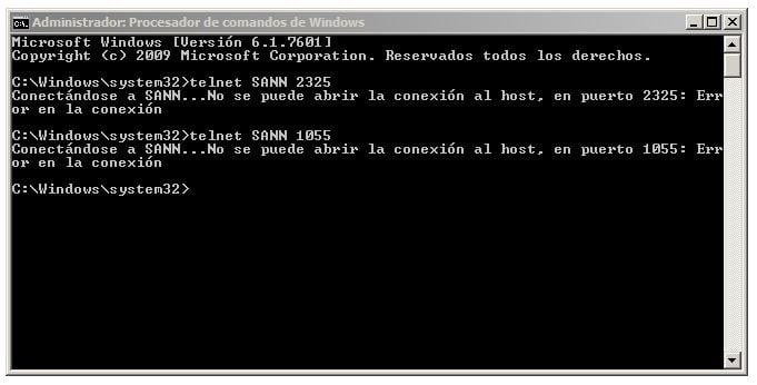

    • chebusann
      I share you a screenshot of the CMD trying "telnet @nameofmypc 2325" & "telnet @nameofmypc 1055".

    • tsiriaks
      Hi Santiago,
      Do you have a paid-up license that's hosted on some machine as a license server ?
      Thanks,
      Win
