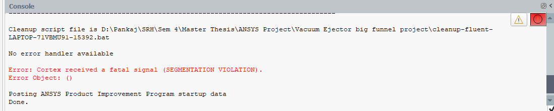

February 14, 2022 at 9:05 pmpathakpankaj441
SubscriberHi
Following is the complete message displayed at Console:
Also, I tried performing the same simulation after turning off my Anti-virus, but the same message and error are displayed.
The error message is given below:
Unable to connect to external socket: Error during socket creation

Cleanup script file is D:\Pankaj\SRH\Sem 4\Master Thesis\ANSYS Project\Vacuum Ejector big funnel project\cleanup-fluent-LAPTOP-71VBMU91-4924.bat
No error handler available
Error: Cortex received a fatal signal (SEGMENTATION VIOLATION).
Error Object:
Posting ANSYS Product Improvement Program startup data
Done.

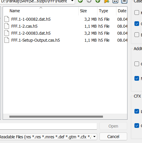

February 16, 2022 at 7:52 pmpathakpankaj441
SubscriberHi,
Thanks, it worked for Fluent! How can I continue with this though? I finished with the setup and now I want to run the solution for the fluent project. However, I don't understand how can I further connect to my original project or even if could run as a separate entity, how? Also, is there any way through which I won't have this problem in future?
Looking forward to hearing from you.

February 17, 2022 at 12:39 pmRob
Forum ModeratorMesh can be exported from Ansys Meshing (Workbench) or use the direct link from SpaceClaim to Fluent Meshing. If you alter the mesh you re-export and read the mesh into the existing Fluent session with the case loaded. Read the panels carefully and you'll replace the mesh but retain all of the other settings.

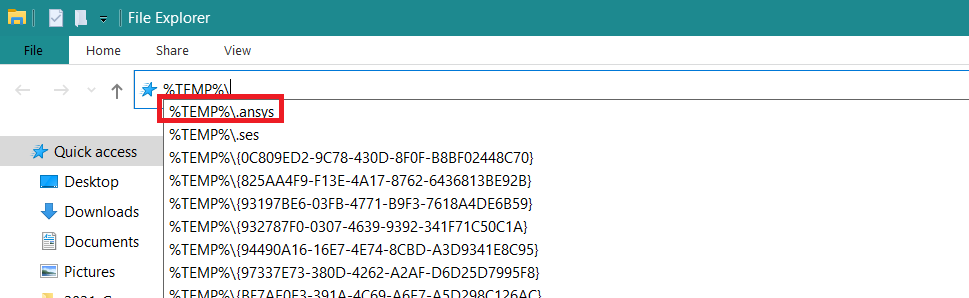

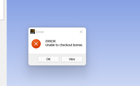

March 6, 2022 at 11:28 pmpathakpankaj441
SubscriberHello
Thank you for your support!
I followed your instructions and finished the processes under Fluent. After I finished running the simulation under Fluent, I exported the output to CFD-Post, however, I got the following error and then there was a blank console. Could you please guide me through this?
I appreciate your support!
Thanks and Regards Pankaj
March 7, 2022 at 10:12 amRob
Forum ModeratorStaff are not permitted to open attachments, so please repost the image. I suggest learning to post process in Fluent as that's what we teach now, and why Fluent's post processing has seen a lot of work over the last few releases.
March 7, 2022 at 8:07 pmpathakpankaj441

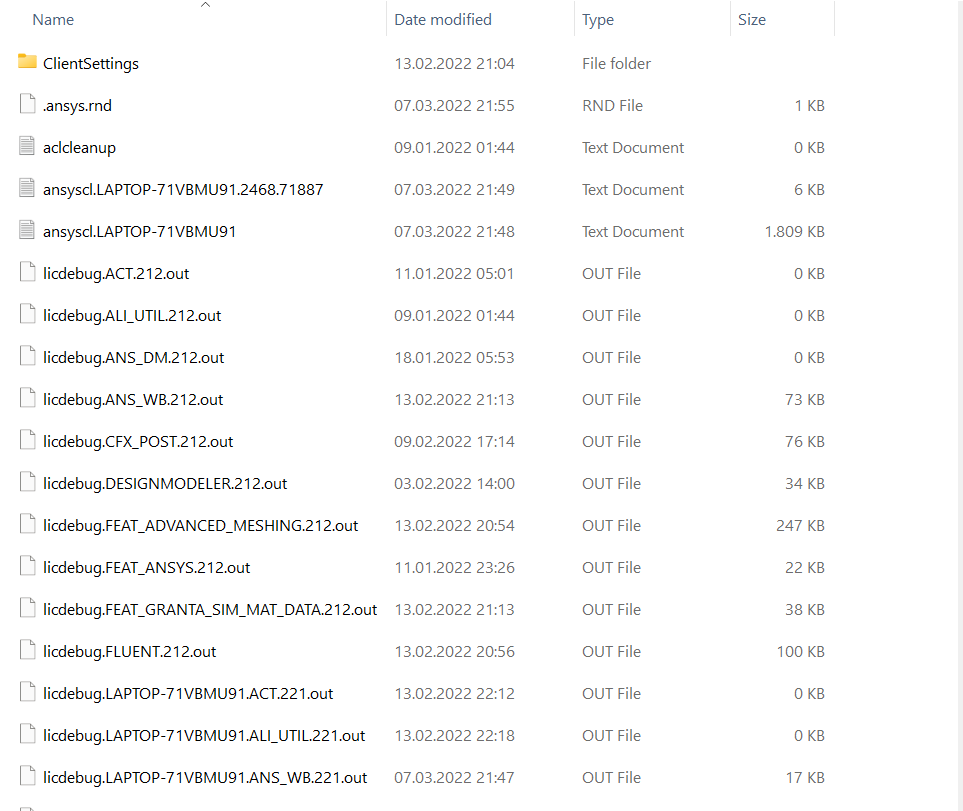

SubscriberMarch 7, 2022 at 8:19 pmMarch 7, 2022 at 9:19 pmMarch 7, 2022 at 9:23 pmpathakpankaj441
SubscriberAs you asked, there is one file called as licdebug for CFX-POST, created on today's date. When I opened this file, I got a very long text, which I am copying here for your reference. (I have only copied the information written under today's date as the whole text is too long. If you need any additional information, kindly ask and I will upload the same here for your reference.
2022/03/07 21:55:56CONNECT_ERROR0/0/0/04076:CFX_POST:PANKAJ PATHAK@LAPTOP-71VBMU91:winx640:192.168.178.41
Could not connect to license server: 63743@LAPTOP-71VBMU91. Connection timed out while connecting to the server.
2022/03/07 21:56:16CONNECT_ERROR0/0/0/04076:CFX_POST:PANKAJ PATHAK@LAPTOP-71VBMU91:winx640:192.168.178.41
2022/03/07 21:56:16INFOStarting Licensing Client Proxy server.
2022/03/07 21:56:16INFOC:\PROGRA~1\ANSYSI~1\ANSYSS~1\v221\licensingclient\winx64\ansyscl.exe -acl-nodaemon -aclport 63743 -log C:\Users\PANKAJ~1\AppData\Local\Temp\.ansys\ansyscl.LAPTOP-71VBMU91..log
2022/03/07 21:56:16INFOStarted ANSYSLI server.
2022/03/07 21:56:32CONNECT_ERROR16079:10/0/0/04076:CFX_POST:PANKAJ PATHAK@LAPTOP-71VBMU91:winx640:192.168.178.41
ANSYSLI exited or could not read server port ANSYSCL_PORT.
Please refer C:\Users\PANKAJ~1\AppData\Local\Temp\.ansys\ansyscl.LAPTOP-71VBMU91..log for more information.
March 7, 2022 at 9:26 pmpathakpankaj441
SubscriberAs you can see, it asks to open another file for additional information. When I opened the file, I got another long text, out of which, I am only copying the recently created text here for your reference. I know these messages are too long. I apologise for the inconvenience and really appreciate your kind support!

March 7, 2022 at 9:27 pmMarch 7, 2022 at 9:31 pmGeorge Karnos
Ansys EmployeeWhat happens if your disable your firewall and then try to run?
March 7, 2022 at 9:41 pmpathakpankaj441
SubscriberWhen I clicked on that view, I just got simple message as below:
ERROR
Unable to checkout license.

March 7, 2022 at 9:56 pmpathakpankaj441
SubscriberHey, good news!
I disabled the firewall and it worked just fine. Apparently, I didn't know about the hidden setting in my anti-virus settings.
I guess I just have to disable the firewall before working on ANSYS projects from now on.
Thank you very much for the support! It was a simple task but I troubled you and your team a lot on my issue. I really appreciate your kind support!

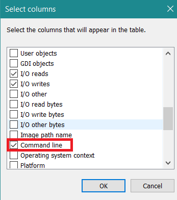

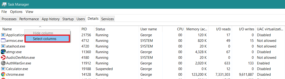

March 7, 2022 at 11:21 pmGeorge Karnos
Ansys EmployeeTry running without the firewall..
When the program appears and is running, open Windows Task Manager and then check the "Details" tab.
Then right-click on The columns (Name, PID, etc....) and choose Command line to be added to Columns
Add all running commands that have a PATH under the Ansys Inc directory.
Turn firewall back on and try to run.

April 8, 2022 at 4:23 pmGeorge Karnos
Ansys EmployeeIf you close everything and just open CFD-Post, does it open?
April 8, 2022 at 4:33 pmpathakpankaj441
SubscriberNo, it doesn't work. I opened CFD-Post only through the windows start option and tried loading all the following files, one at a time. Apart from them, I also tried opening one file in ".dat" format. However, it still doesn't work.
For "dat.h5" and "cas.h5", the console showed the long error message shortly stating "these files do not exist", and for other files, I didn't receive any error message, but the console was seen as I showed in the earlier message.
