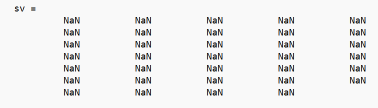

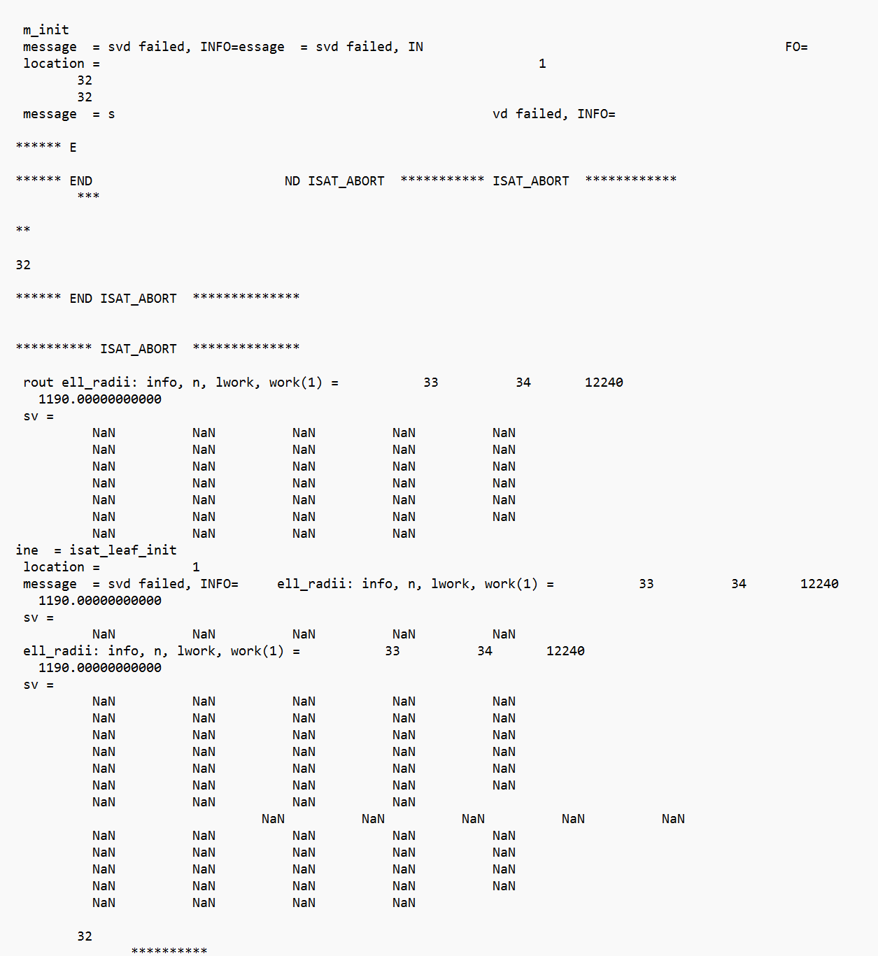

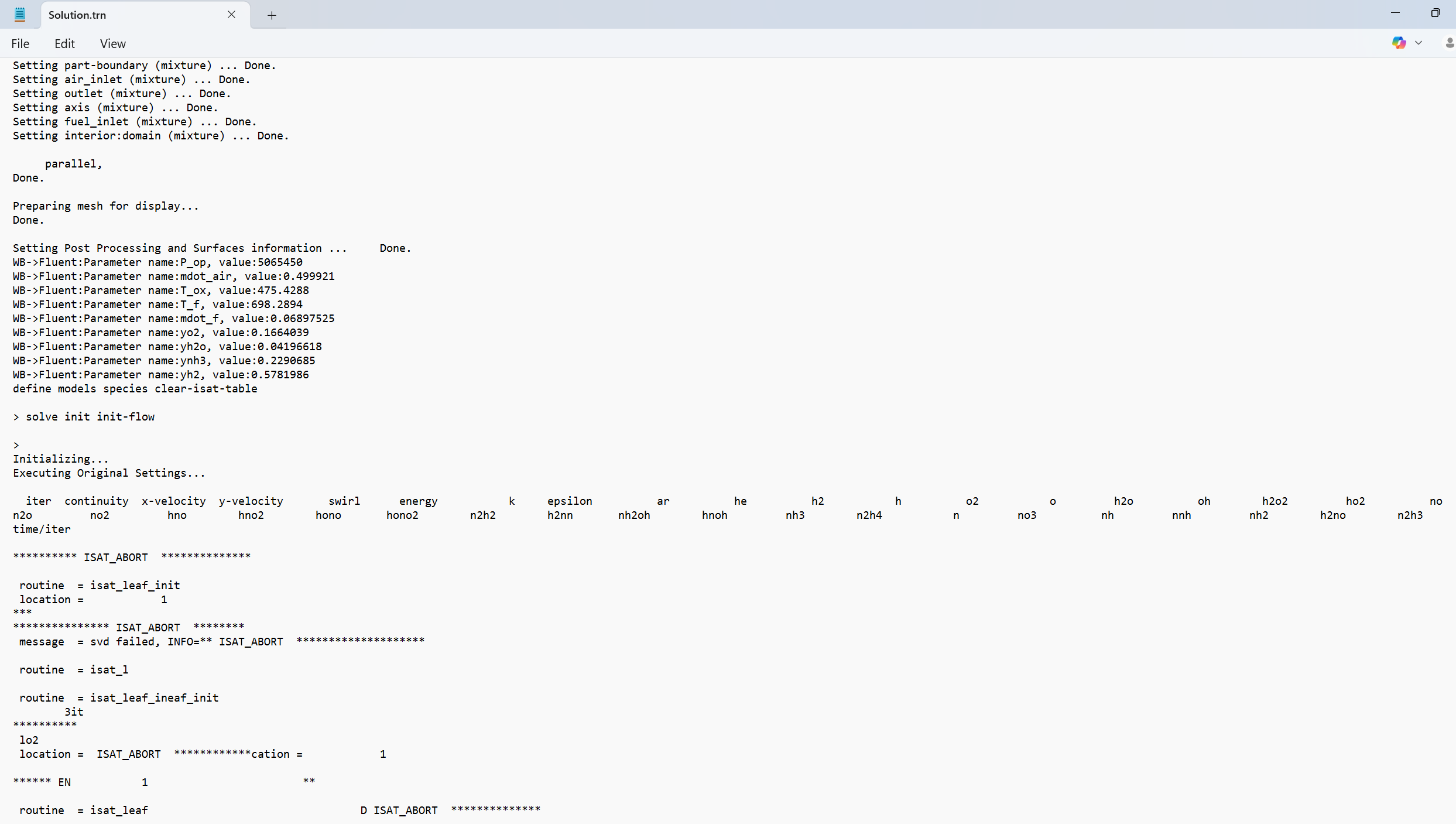

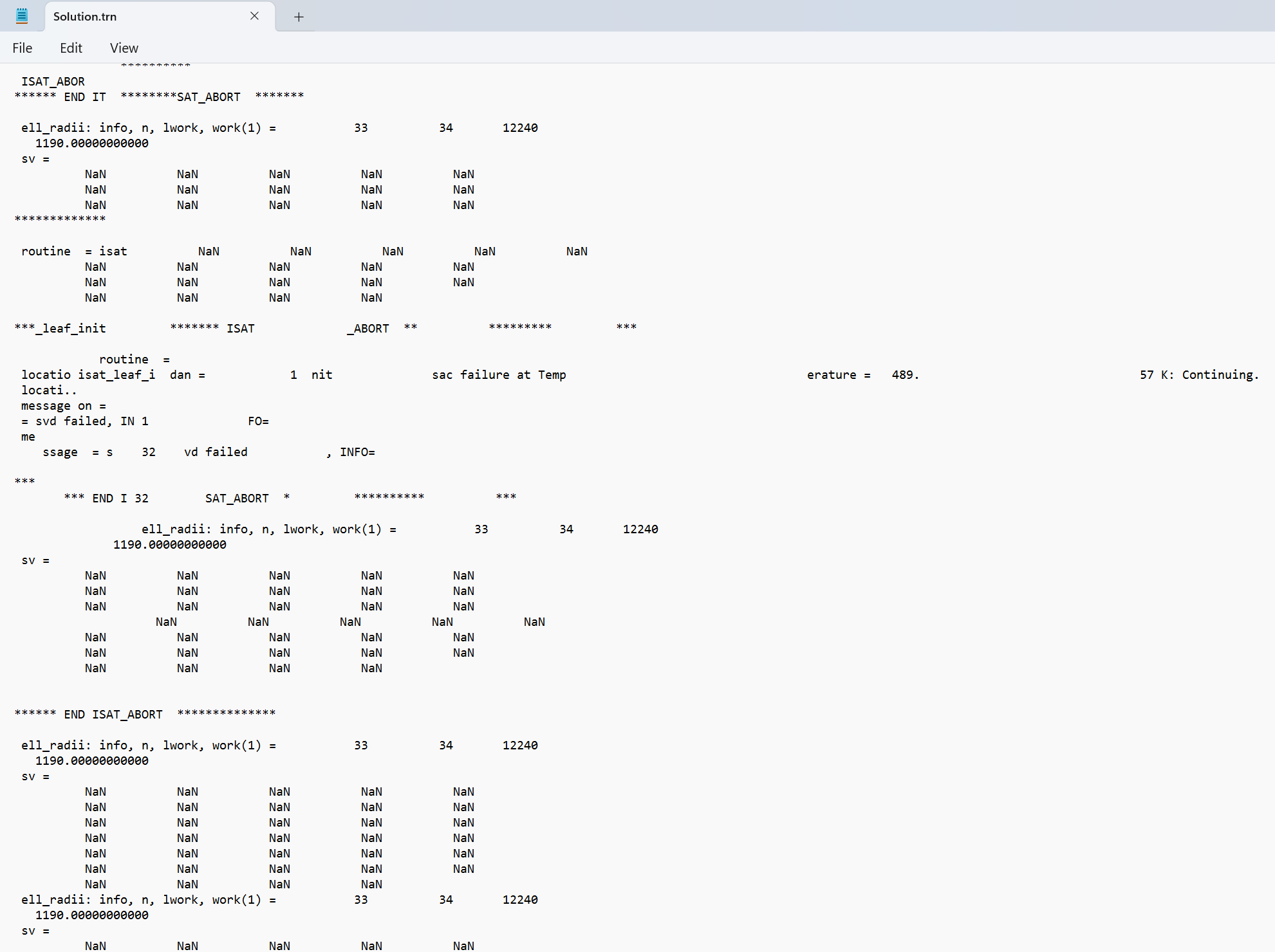

      For the past several days, I've been trying to use Workbench 2024 R1 to conduct a parametric study involving the EDC model with Stiff Chemistry and ISAT enabled in a 2D axisymmetric domain. Unfortunately, I've been hitting a cortex error immediately at the start of every design point calculation in the parametric table. I opened the TRN file to see what the problem is, and here are a few screenshots of what it shows:
      I made sure that the physics and solver setup are good by running the first design point in Fluent manually, so I know that shouldn't be the problem. This error only occurs in the Workbench parametric sweep and also in the native Fluent parametric study tool. I will say that the TUI string: "define models species clear-isat-table" was intended to trigger alongside the initialization TUI string, with both being in the same Pre-Initialization block under Calculation Activities, but it appears it failed to do so. I'll have to see how to fix that later. I tried manually clearing the ISAT table in the Integration Parameters window in the Species tab, but I don't believe there was anything to clear to begin with, so nothing happened. A fix to this issue would be greatly appreciated.

      Firstly, do NOT increase the ISAT table limit too much from the default value of 100 MB. I'd suggest you keep the default value.
      Regarding the crash, could you please try to manually run a standalone calculation for other parameter values to see if it works. I wanted to see whether the issue is related to the EDC model and its input or the parameter study workflow itself.

      Since I made this post I've had a lot more experience with using the ISAT table. It's been pretty hit or miss, with way too many misses. I have learned to not crank up the ISAT storage space, but I still don't know what's a reasonable value to give it, as I don't know whether the default 100 mb is considered large enough. With ISAT enabled, Fluent randomly crashes when the high temperature patch is triggered with automatic TUI commands, even with the max storage limited to 100 mb. I have noticed that the crash happens less often when running a cold flow, stopping the sim, manually patching the high temperature, and then resuming the simulation. I've also found that using only Direct Integration tends to run more reliably than the with the ISAT table included, but as you'd know I loose the eventual speedup that ISAT promises. A lot of times when Fluent crashes when I run an ISAT simulation manually, Fluent doesn't output a TRN file, and the fluent-999999-error.log file only has a single line saying there was an abnormal exit. This results in me not knowing what the problem was the in simulation when Fluent shuts off except for a momentary flash of the cortex error in the command window.

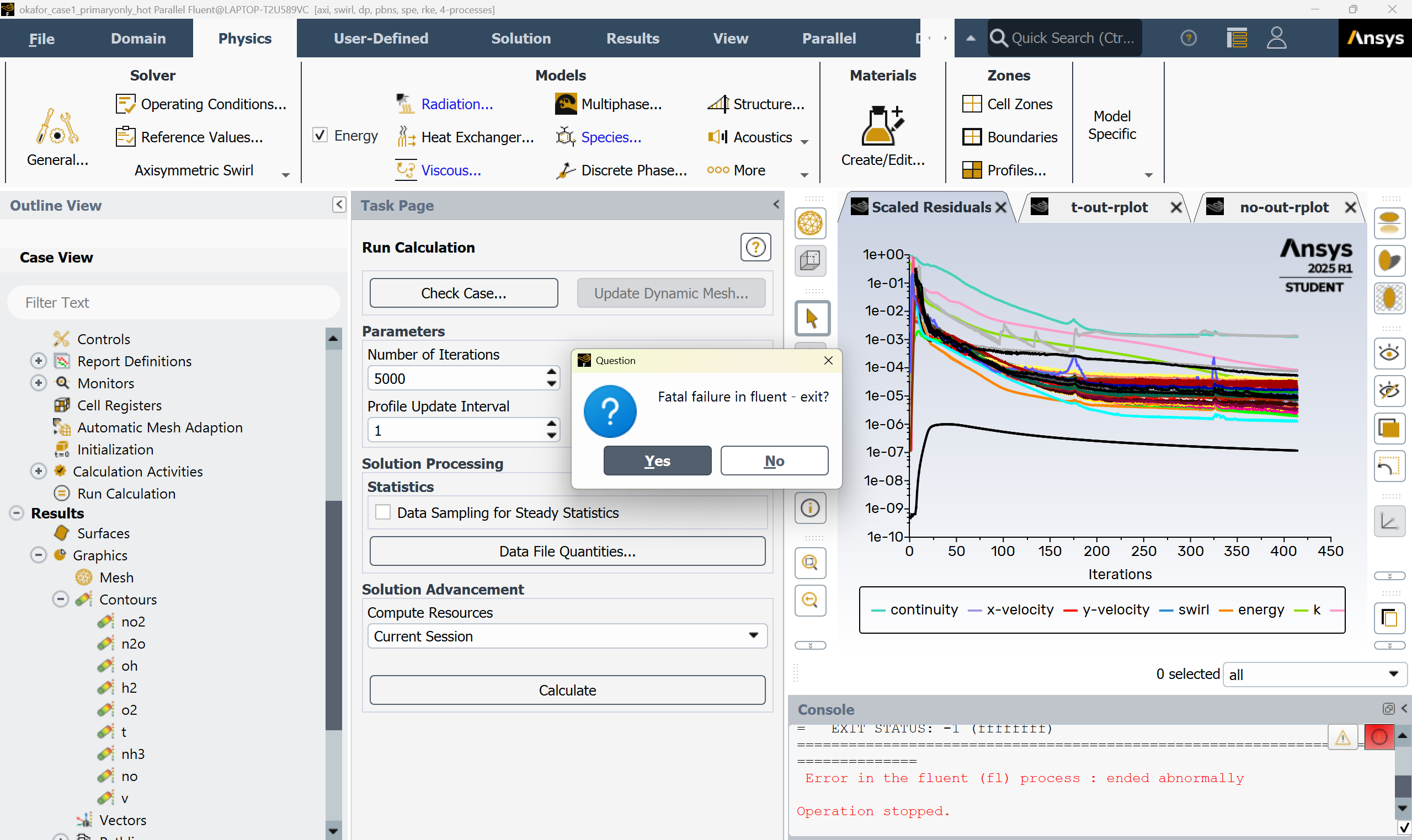

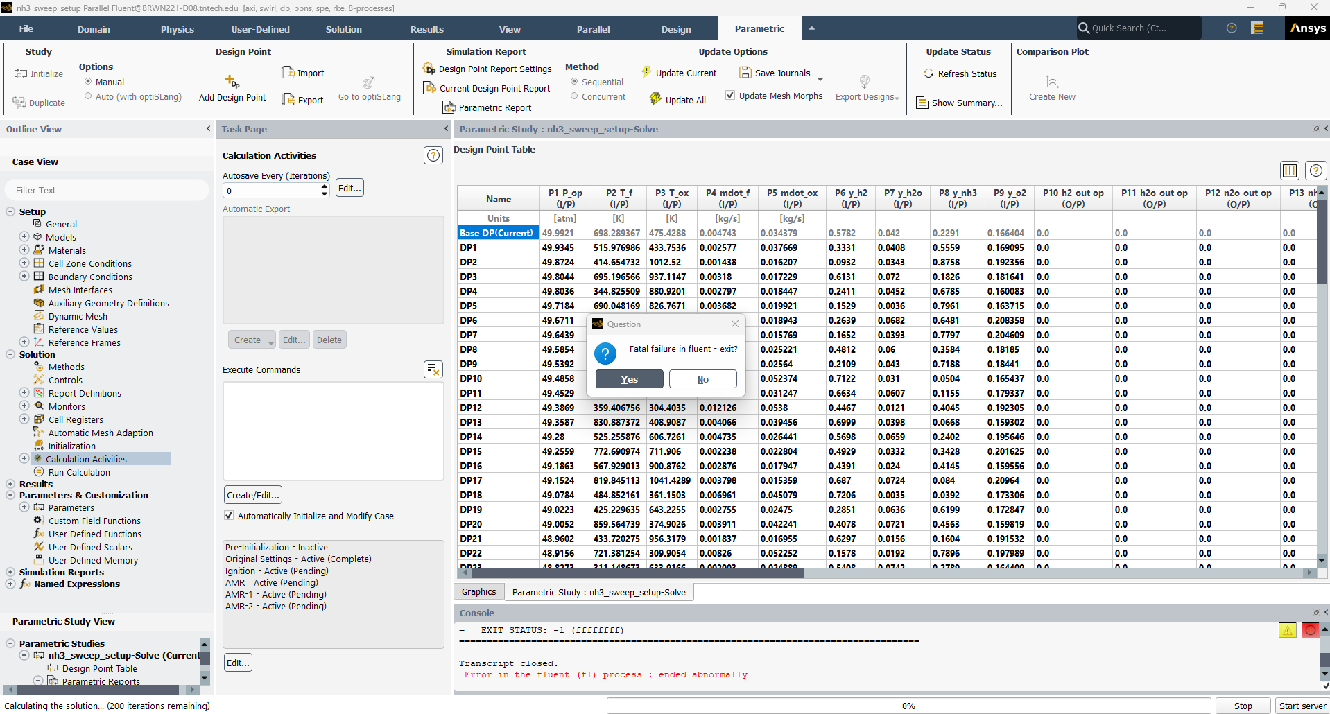

      Here's an example of me trying to run the sweep in standalone Fluent where it crashed immediately upon starting (ISAT storage set to 100 mb). I ran the Base DP condition manually before opening the sweep project file and it worked fine. Sometimes when doing the sweep it will at least get past the first design point, but then crash upon starting the second. I'm also using the Stagni 2023 ammonia mechanism. It's been a reliable mechanism, and I don't believe it's the cause of my problems. Does the base EDM model work with larger mechanisms?

      As I mentioned previously, the first step of investigation is to find out if the issue is the EDC calculation or the parametric study workflow. So, I suggested that please run a calculation outside of the parametric study workflow (WB or Fluent) but at conditions other than the baseline conditions (you already mentioned that the baseline conditions worked).

      Sorry for the delay. I ran simpler scenario of non-premixed ammonia and air combustion in Fluent standalone using the EDM model with relaxation to chemical equilibrium with ISAT enabled. It ran with no problem. Keep in mind that I'm now using 2025 R1 student version as I am currently away from my desktop. I then simply switched the chemistry model to EDC, which defaults to the the Stiff Chemistry solver with ISAT enabled, and then tried to resume the simulation. A fatal error was immediately triggered at the start of the calculation.
