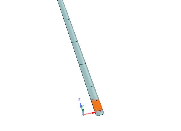

SubscriberI am sorry..but as per your above stated, i divided my solid tube in 10 parts by using split command and now as oer my photo attached below(showing divisions of solid tube), now i have to use pull command and pull one face of one segment or solid section(total solid section= 10)...but if i pull one face of first section, than it will go inside next section( or virtually collide face to face with other section), with No merge....but it will give N(in my case 10 number of beams)............and how it is sure..that these all 10Â beams are attached to each other node by node (ened to end connection)
Or else i didnt understand this statement "Â Pull one face of the segment into the uniform cross-section for that segment"?? i am sorry can you bit make me this line bit more understandable
As if i divided 10 sections, if i start from section 1st and if pull its face, than how much i have to pull??Because just after first section we have 2nd section, yhan 3rd and so on upo 10th....so there is no space between every two sections......or else you want say..just divde in N number of sections and extract that N number of beams..thats it????
Please can you elaborate(May be i am bit confused)
