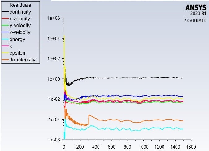

      Hi, I'm simulating a solar chimney attached to a cubic chamber, is a steady state simulation, i'm using the k-e RNG model, with full buyoancy effects and standard wall treatment, and the DO radiation model. The walls of the chamber are considered as adiabatic, the glass cover is semi-transparent, and the absorber plate is aluminium. The air inlet of the chamber is set as velocity inlet, normal to boundary and constant temperature, the top of the chimney is set as pressure outlet, the air is considered an ideal gas. Is a simple geometry, an hexa mesh, the quality is good. Since i'm working with student version the mesh is aprox 472000 elements.
      How to know the calculation as convergerd? The residuals do not decrease.

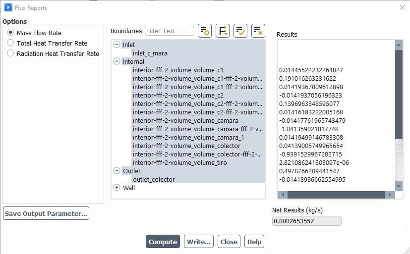

    • Karthik Remella
      Administrator
      The net mass flow rate is 1.8 % of the smallest mass flux in your simulation. If your mass flow rate has become steady (please check if this is the case), it tells me that your mass balance is conserved.
      How does your energy balance look?

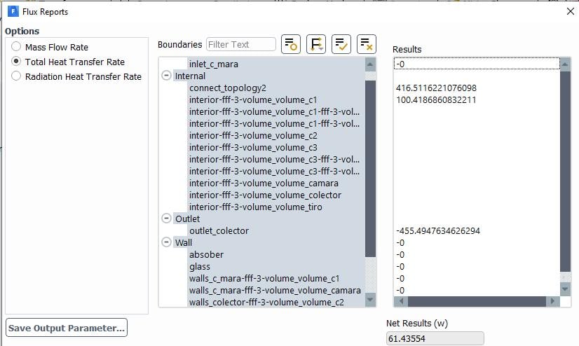

    • sandrazc
      Hi, this is the Total heat transfer rate.
      I also compare the simulation results with experimental data (absorber plate and internal temperature in the chimney), and they are very close. I hope the simulation is on the right way.

    • Karthik Remella
      Administrator
      If you look at your net result, it is still appreciable compared to the smallest flux on one of your face zones (-2.66). If you are running a steady model, I'd say that your solution is not yet reached a steady state. It might be on track to getting to a steady state though.
      What do your solution monitors look like? And how are your residuals, especially the energy equation?

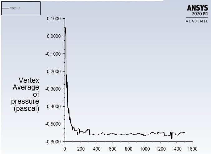

      Hi, I already made another simulation, residuals in energy equation do not decreases below 1e-5. i´m monitorig the absorber plate temperature and it's stablized after 300 interations, but outlet velocity and inlet pressure are not. I'm not sure what it should look like, i generated vertex average reports.
      I think mass flow rate is fine, but i´m not sure about total heat transfer rate, i attach images.
