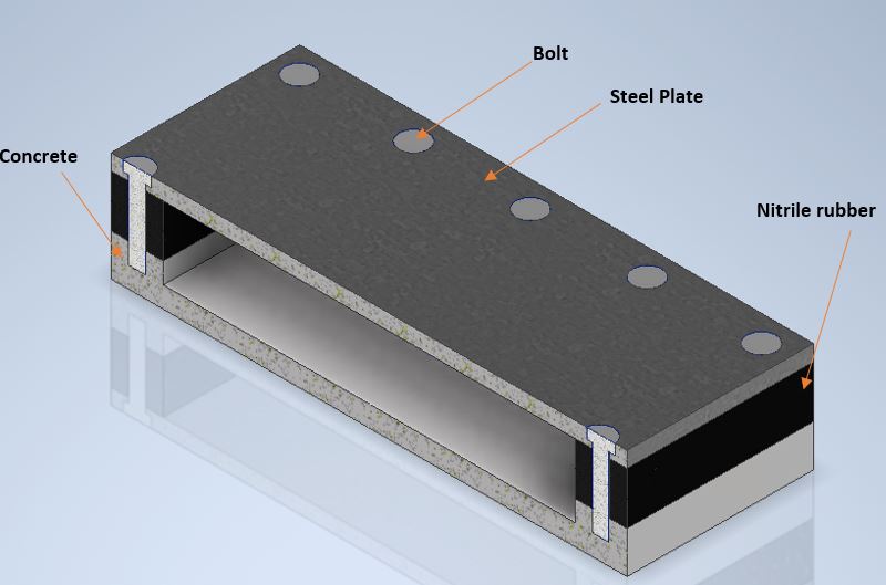

      I would like to simulate the following system:
      System
      There is a concrete base where it is fixed through 12 bolt a steel plate. Between the steel plate and the concrete there is a nitrile rubber to isolate the vibration.
      The plate can be hit with different object or an object can remain on the plate. The weight of the objects can be up to 1-2t.
      The idea is, first do a structural simulation to see if the support can resist at the load, then do a modal simulation to see the resonance modes of the plate.

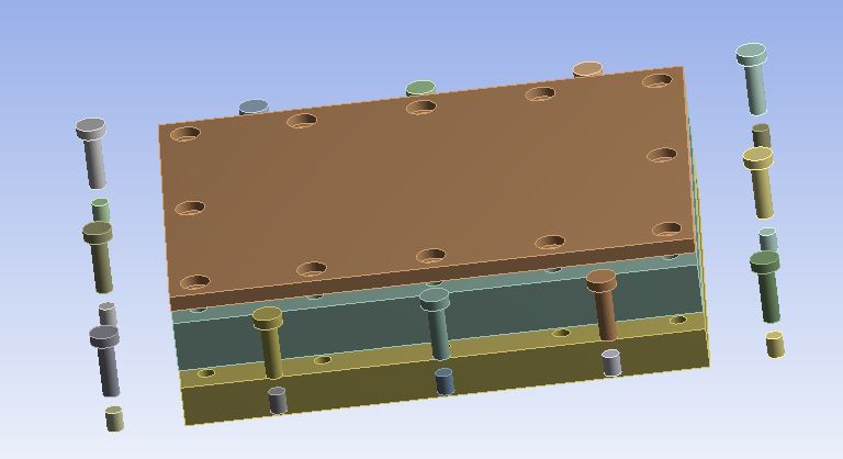

      In the following pictures is visible the exploded model in ANSYS.
      Ansys Model
      I have set this contact:
        - Plate-Rubber: Frictional Contact
        - Rubber-Concrete: Frictionless Contact
        - Bolt side surface - Rubber: Frictional Contact and disable small sliding
        - Bolt side surface (down part) - Concrete: Bonded Contact
        - Bolt head downside surface - Plate: Frictional Contact
      The initial contact information say that there aren't open contact.
      At the down side of the concrete I have applyed a fixed support.
      The bolt pretension is 2500N for each bolt.
      In the analysis setting I have turn on large deflection.
      In the first step of the simulation I apply the pretension and then I lock it, in the second step I apply a force in one node (near the plate center) with components (20'000N,-20000N,20000N).
      The problem is that the simulation converge for  the first time step (Bolt pre-tension), but the second step, when I apply the force, doesn't converge.

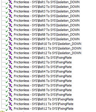

      The contact
      For the contact I have the following contacts near open and I not understand why:

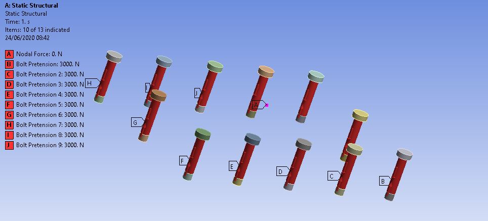

      You mentioned that the simulation runs till 0.8896 s. I see that your first step is till 1 s. So even the first step does not converge completely. Could you insert a snapshot showing how the Bolt Pretension has been applied?
      A possible way to make it faster would be to make the mesh coarse. This would reduce the accuracy, but you can run faster simulations till you have debugged it. Once you fix all the issues and know that the simulation runs completely, you can refine the mesh to get accurate results.

      This is the bolt pretension:
