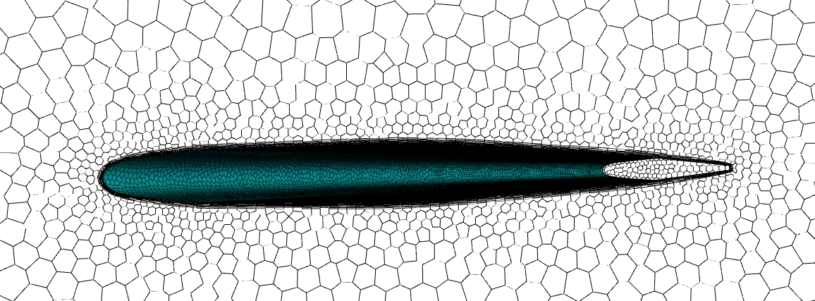

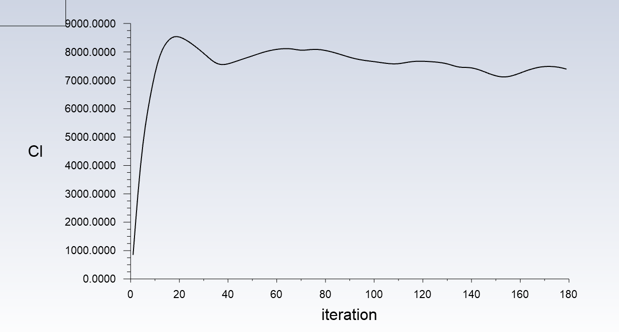

      I tried to solve this problem by using Fluent Mesher to generate a polyhedral mesh. The orthogonal quality and skewness values of the mesh were quite good, with a minimum orthogonal value of 0.22 and a maximum skewness value of 0.72. However, when I switched to the solution using the "Switch to Solution" command, I obtained very high drag and lift coefficients. For instance, the lift coefficient increased to around 8000. This issue only occurs when I use the "Switch to Solution" command.

    • Federico
      are you sure that your Reference values are consistent between your different model/simulations?
    • goktug.yilmaz
      Thank you very much for your comment. I have checked and corrected my reference values as you suggested. Currently, I am not obtaining high lift and drag coefficients, which now seem reasonable. However, I am still experiencing convergence issues, particularly with lift exhibiting a fluctuating behavior at a 6-degree angle of attack.

      By the way, when I refine the boundary layer by decreasing y+, polyhedral mesh exhibist skewness values that are greater than 1. Should I try to decrease skewness of these cells? I am unsure that quality check of polyhedral mesh is similar to tetra cells. Should I care about skewness for polyhedras?
      For poly cells use Ortho quality. The skew calculation gets a bit confused at times.

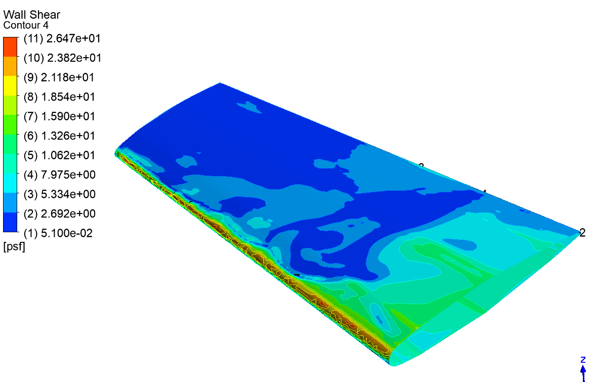

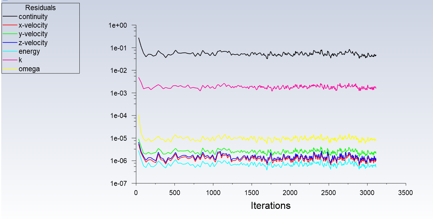

      Thank you very much for your answer. I think a flow separation occurs since wall shear stress decreases a lot as you can see in the picture below. I also share my residuals to show how they fluctuate. Angle of attack is 10 degree. I could not solve the problem. It does not converge. Max y+ is equal to 5.
      You may need to increase the streamwise resolution near the leading & trailing edges to pick up the curvature more precisely: hard to say but the contour ought to be smoother.
      Well, if the separation point is moving you have answered your question. The flow isn't steady, so the residuals won't converge to text book levels. The question is whether the fluctuations are significant enough to justify the computational expense of switching to transient.
