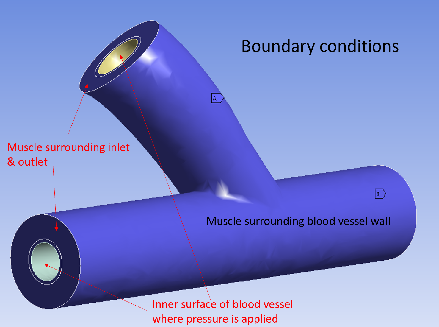

      I'm trying to model blood pressure acting on the blood vessel in Static structural.
      Blood vessel was modelled using 5 parameter mooney-rivlin model with two layer mesh, and the surrounding muscle was linear elastic.
      As shown in the picture below, fixed boundary was applied to the muscle surrounding the vessel wall, and frictionless condition to the muscle surrounding inlet & outlets. Pressure was applied to the inner surface of blood vessel (yellow and green surfaces).

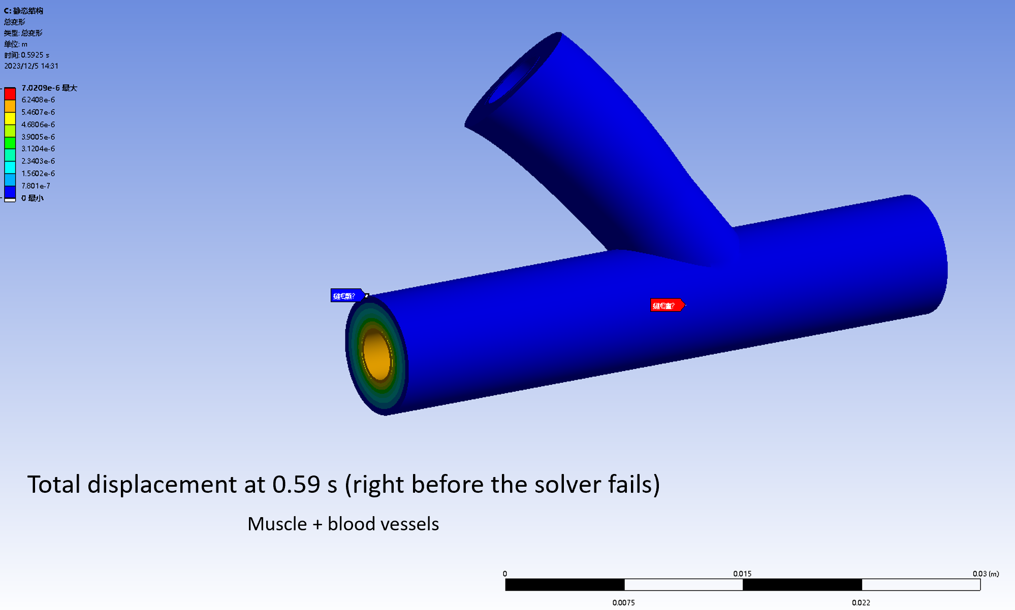

      I turned autotime stepping on with minimum number of steps of 100, and max of 400. However the solver failed to converge. I tried a few tricks I saw on the forum (KEYOPT, matid, 6, 1; KEYOPT, matid, 2, 1; NEQIT, 10; newton-raphson 3), but it's not helping.

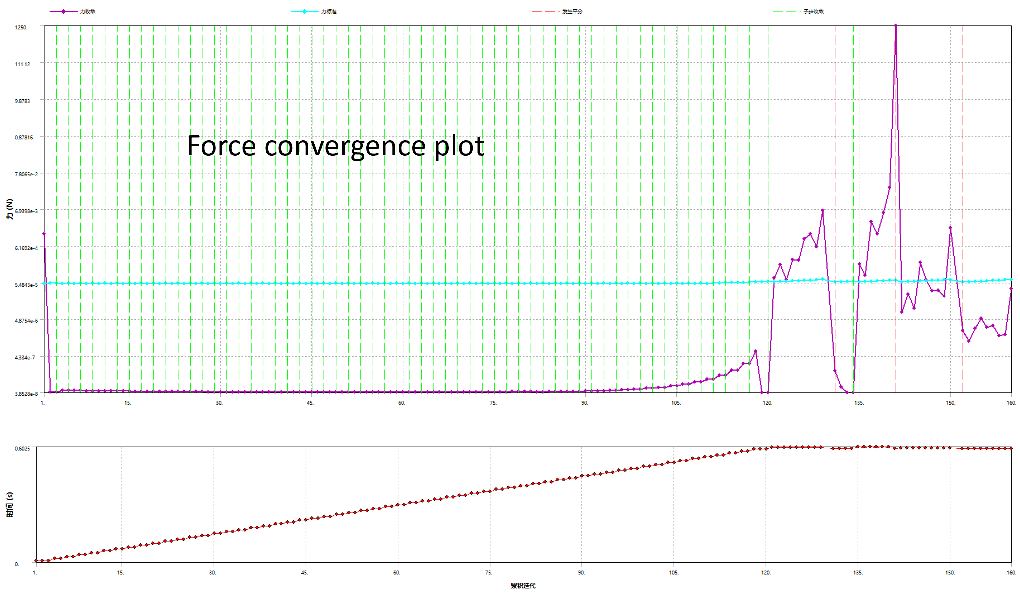

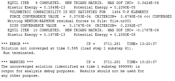

      As for the debugging tools, I do see them and I've attached some of them (solver output and force convergence) in the above thread. But I don't know how to interpret them and how to use them for debugging.
      In addition, I used mixed u-P formulation as suggested and I got the following message:
      Any suggestions on how to interpret these debugging tools?
