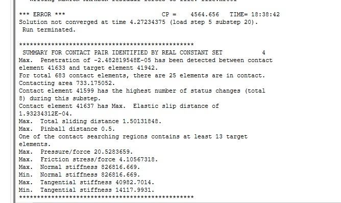

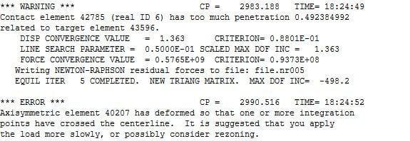

SubscriberI'm solving 2D axis-symmetric problem when I apply required differential pressure on inside and outside surface. I get error solver unable to converge nonlinear problem. Due to elements getting distorted at contact region which I found from newton Raphon residual force. I have tried with finer mesh and changing contact parameter. If anyone with some suggestion will be really helpful.

SubscriberNo C shaped component is metal. I have been doing entire model in static structural in workbench and applied thermal condition by setting reference temperature of component as 'by body' which is uniform. I will try making the horizontal plane of symmetry. In error file it says too much penetration of contact element into target and also some element are getting highly distorted near contact region. Main problem arises when differential pressure load is applied on inside and outside surface of C at that point only convergence issue is coming. If you see force convergence image it's the step5 where full differential pressure load is applied solver is unable to converge.nSeptember 20, 2020 at 12:49 ampeteroznewman
SubscriberConvergence issues are often helped by taking many Initial or Minimum substeps under the Analysis Settings.nSeptember 23, 2020 at 7:08 amSeptember 23, 2020 at 3:54 pmpeteroznewman
SubscriberThe solution may be helped by softening the contact. Under the Contact Details, there is a line called Normal Contact Stiffness. Change that from Program Controlled to Factor and change the Factor from 1 to 0.1 or 0.001 and see if that helps.nAnother suggestion is the remove the sharp corner where contact is made and put a small blend radius on that corner. That way you can have many small elements around the contact point.n

SubscriberThanks alot for all the suggestion. Solution got converged!nOctober 26, 2020 at 6:38 amJasmin
