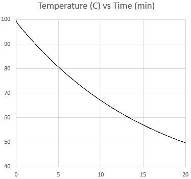

July 23, 2019 at 11:12 pm
peteroznewman
SubscriberPlease tell me where you measured the temperature vs. time and I will plot data from the 2D axisymmetric model.
Also, what time duration have you recorded? At some point the graph goes flat as the pipe comes to equilibrium.

SubscriberWe measured the temperature halfway up the pipe on the outside surface. We have the ambient air at 27C and the pipe at 100C. I think we were measuring about 20 minutes for the pipe to reach about 47C. I am in contact with someone else about getting using Fluent under a research license. I don't have the program yet but am hoping to use it! I have a question: How did you determine the film coefficients (heat transfer coefficients) for the model? In Mechanical the user has to find those value, but I am not sure about them. Thank you for your help!Â

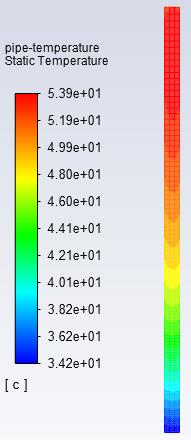

July 24, 2019 at 8:02 pm
peteroznewman
SubscriberIn this simulation, the midpoint temperature has fallen to 49 C at 20 minutes for an initial temperature of 100 C and an air temperature of 27 C.
Attached is the archive file from 2019 R2. Use File Open to look at the simulation, which was saved with results. You will see all the boundary conditions. You might need to watch a few Fluent introductory tutorials. You can see the distribution of temperature along the length of the pipe after 20 minutes. I don't expect that would be created in the Mechanical model with convection BC and a constant film coefficient.
July 25, 2019 at 9:30 am
jvardaman
SubscriberThis seems very accurate to my experimental results. Fascinating, thank you!
