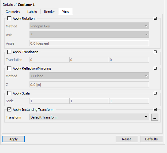

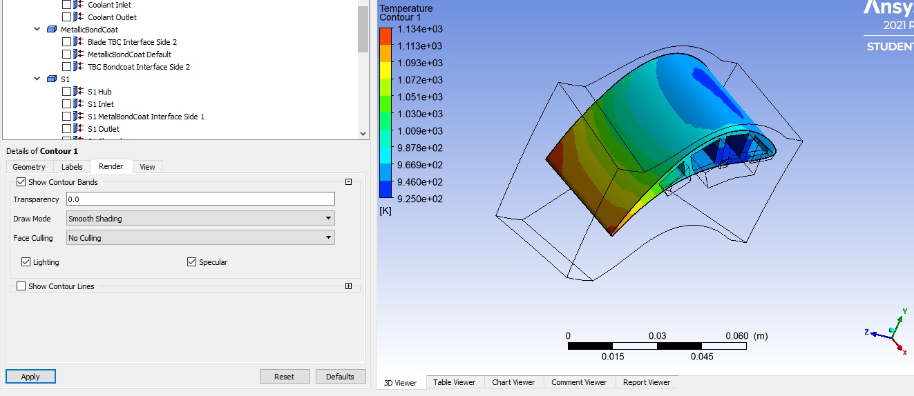

      Hi! I have simulated a a fluid on a blade. I have the results and I want to create a Temperature Contour. I have it but I have not got the option of representing with a gradient of temperature but only with stripes of diferent temperature. I think I should select the ''gradient'' option in the Color Map window, but it is already selected. In fact, I can not change it.
      I attach a photo of this panel and my contour and also a photo of what I would like to have.
      Could anyone tell me how could I do it?
      If the second image is what you're after use 20 contours on your plot. I think there's a smooth/banded option somewhere too - check in Render.

      In Render, en Draw Mode (you can si the window in the first picture) I only have these three options: ''Smooth shading'', ''show as points'' and ''show as lines''. The one selected in the picture is the first one. Any of this are the solution.
      I think that the correct window is the one of my first comment, don't you think?

      I have it. I changed de ''# of Contours'' in the panel and it works.
