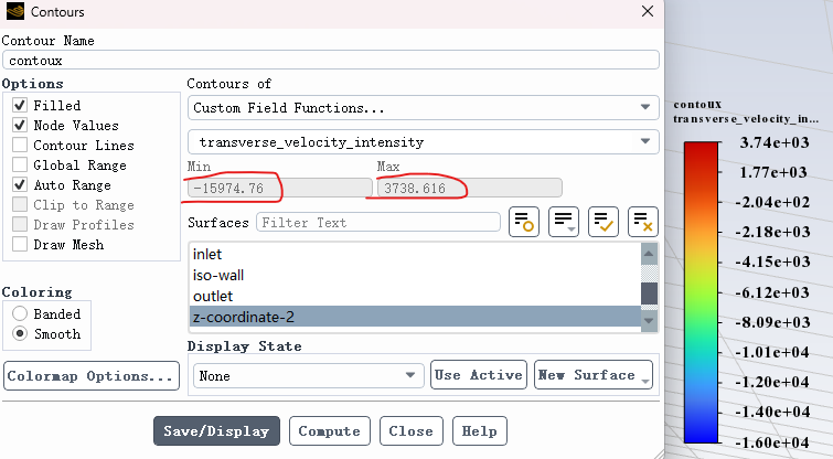

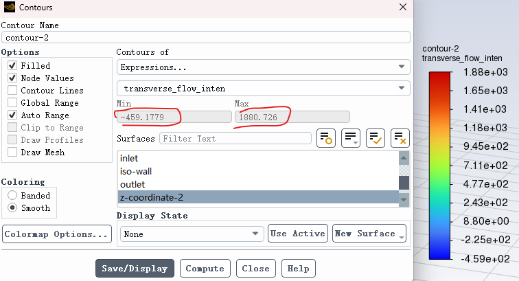

I use Custom Field Function and expression to define transverse flow intensity. But the contour of them is quite different. And the range of same location is largely different.

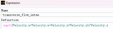

And the definition of transverse flow intensity defined in field function and expression are shown below. I think the definition may not be wrong so it's hard to explain the strange results.
Regards.

Forum ModeratorDeselect Node Values too, and then post those images.Â

SubscriberHi Rob,
The images and ranges become same after I deselected node values.
1.Is it because the interpolation method different for Custom Field Function and Expression?Â

Forum ModeratorCFFs are an older way of interacting with the solver, and are VERY linked into both Scheme and Unix rules. As Unix is case sensitive you'll find many of Fluent's functions don't allow upper case, you can't use spaces either.Â
Contours use smoothing to improve the images. If the mesh is very well resolved you'll not see the difference between node values on and off. However, CFFs may well interact with the data in a slightly different way to expressions. The solver is using/reporting the correct value, it's an image smoothing effect that you're seeing.Â
