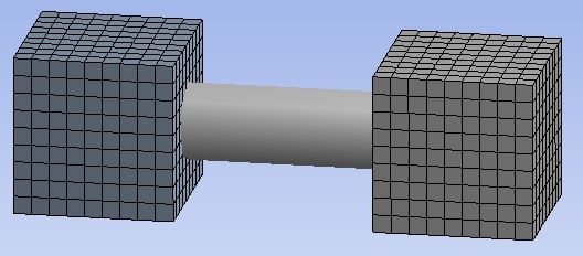

I would like to transfer "continuum distribution coupling" used in ABAQUS to Ansys.
My model has two blocks connected via a beam. Either side of the beam is coupled to blocks using "continuum distribution" coupling in Abaqus. I would like to transfer it to Ansys. Could anyone please help me on this!

SubscriberIf you have a circular beam, you can define material and a radius for the beam and identify a Reference and Mobile face on each block to connect to the ends of the beam.
This is as simple as a right mouse click on the Connections folder and choose Insert > Beam from the drop down menu.
The red spider of connection elements from the node on the beam end to the nodes on the face can be selected as Rigid or Deformable. Note that if you select a large face and select Rigid, you will artificially increase the stiffness on that face.

SubscriberYou can use Bonded Contact to connect the edge of a surface meshed with shell elements to the vertex of a line body meshed with beam elements.
