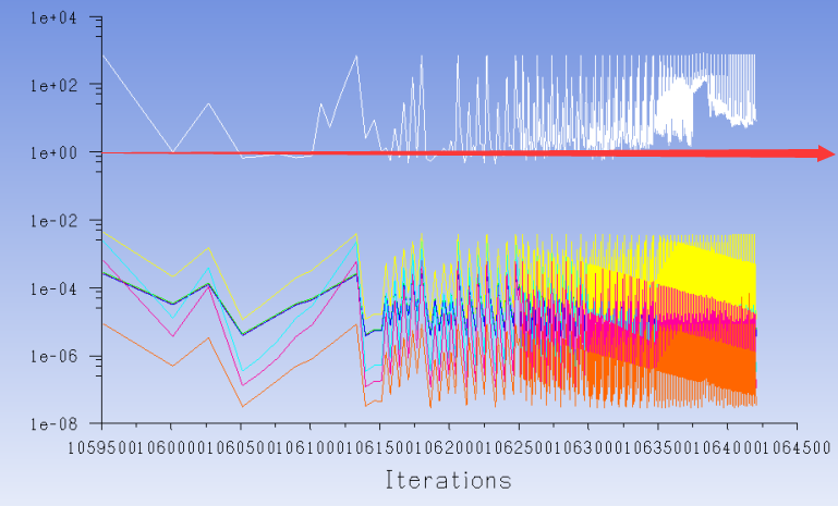

SubscriberHello,
In our transient calculation, the value of last continuity residual in every time step is greated than 1. I am not sure if this calculation is accurate. The models applied are VOF model, LES model, dynamic mesh and compressible flow (ideal gas). I hope someone can tell me the accuracy of this calculation. If this simualtion lacks accuracy, how can I solve it?
Otherwise, how to choose the time discrete scheme, first-order or second-order? When I choose second-order, the solution is instability. While I choose first-order, I am afraid of the precision of LES.
Best regards!
August 26, 2021 at 2:20 pmRahul Kumar
Ansys EmployeeHello,
Just looking at the residuals, especially for a transient flow, it would be difficult to guess the convergence. You could setup a monitor of a particular variable and check to see if the behavior is appropriate. Also, check the flux balance, the error should be less than 3% (less than 1% would be ideal).
August 27, 2021 at 4:53 amBart
SubscriberHello Thanks for your reply!
You mean, if the mass flux differnece between inlet and outlet is very small (less than 3%) at the last iteration of each time step, I can ignore the fact than the continuity residual is greater than 1 at the same case´╝ƒ Whether the residual is greater or less than 1 does not affect the results.
Kind regards!
August 27, 2021 at 2:16 pmRahul Kumar
Ansys EmployeeYes, this means the simulation is respecting the conservation principle (the small error is related to numerical).
