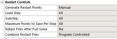

    • ThomasDD
      Yes. Restart writing is fully activated (for all substeps to):

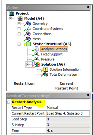

    • Subhash Tadala
      Can you confirm if you can see the restart analysis section  in details of analysis settings after interrupting the analysis as below:
      In this section, we can select the current restart point and go on to solve.

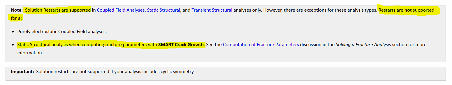

      But regarding the crack propogation, the limitation is as follows that is available in the help:
      Can you update me after checking this ?
    • ThomasDD
      I see no pause symbol (restart icon) after pausing the analysis. There is also no “Restart Analysis” section in the analysis settings, as should actually be the case. That it is not supported could explain it.
      That would be an important application of this technique, since crack propagation simulations are really lengthy calculations with hundreds of substeps. It would be extremely helpful to be able to pause the calculation to see what the crack is doing and whether it makes sense to run the simulation to the end.
