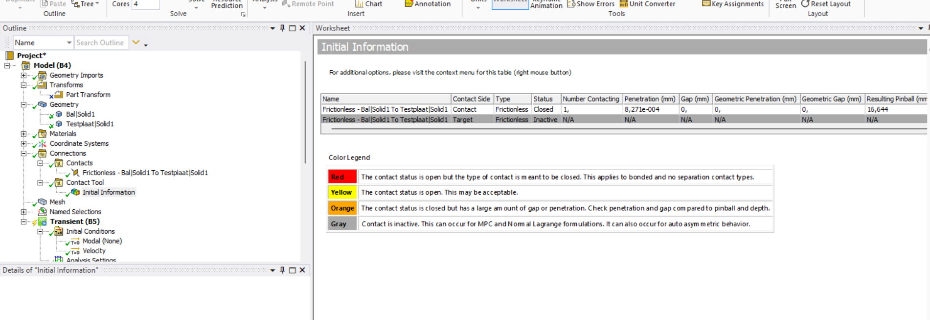

      For the composite plate, i use an isotropic linear elastic model. The problem is that the ball just passes through the plate and no contact is detected. The contact is defined at the ball's surface and the surface of the plate where the plate is the target but i have changed this up to check it. Two errors occur: The first one is this one where the ball travels in the other direction when it start off contacted to the plate:
      Another thing that happens is that the ball passes trough the plate and no contact is detected.

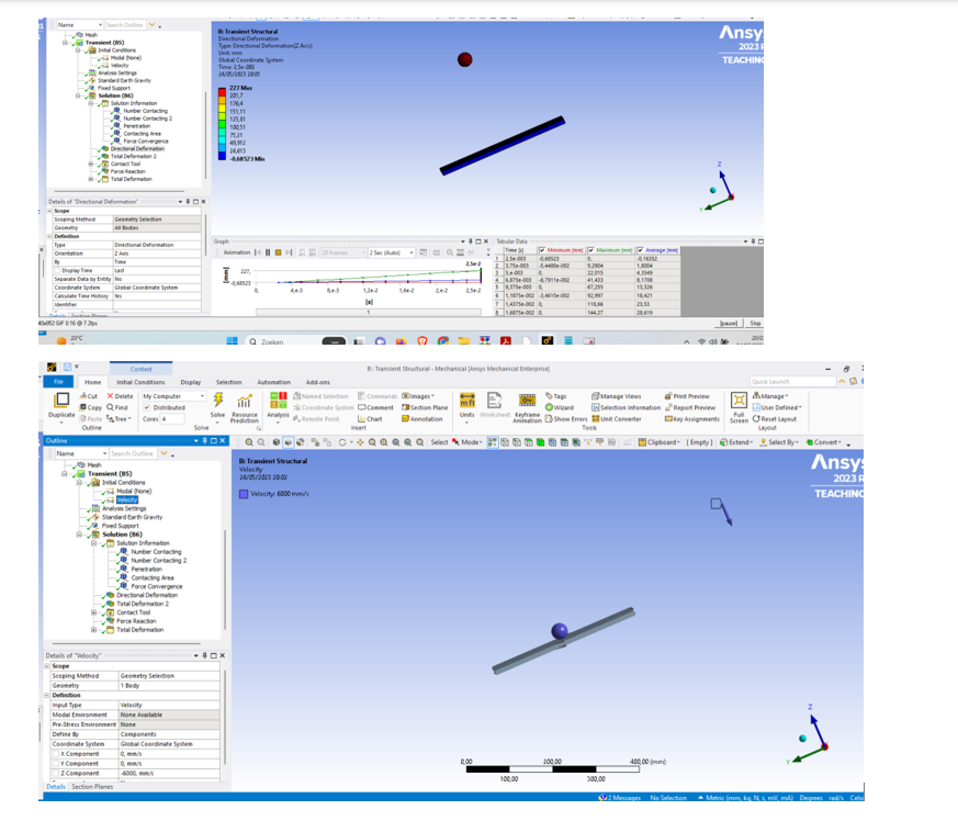

      And just like this contact seems to work, I am very happy about this. I am wondering what i have been doing wrong all the time.
      Now a new question arises, as this ball hits the plate and deforms it the speed of the ball stays constant why is the speed of the ball not decreasing? This time i have not applied the speed using the initial conditions but i used the "velocity" boundary condition. This is probably the reason that the speed is constant, but i want the best of both worlds. I want to be apply this velocity at the start and have it decrease do to the deformation of the plate.

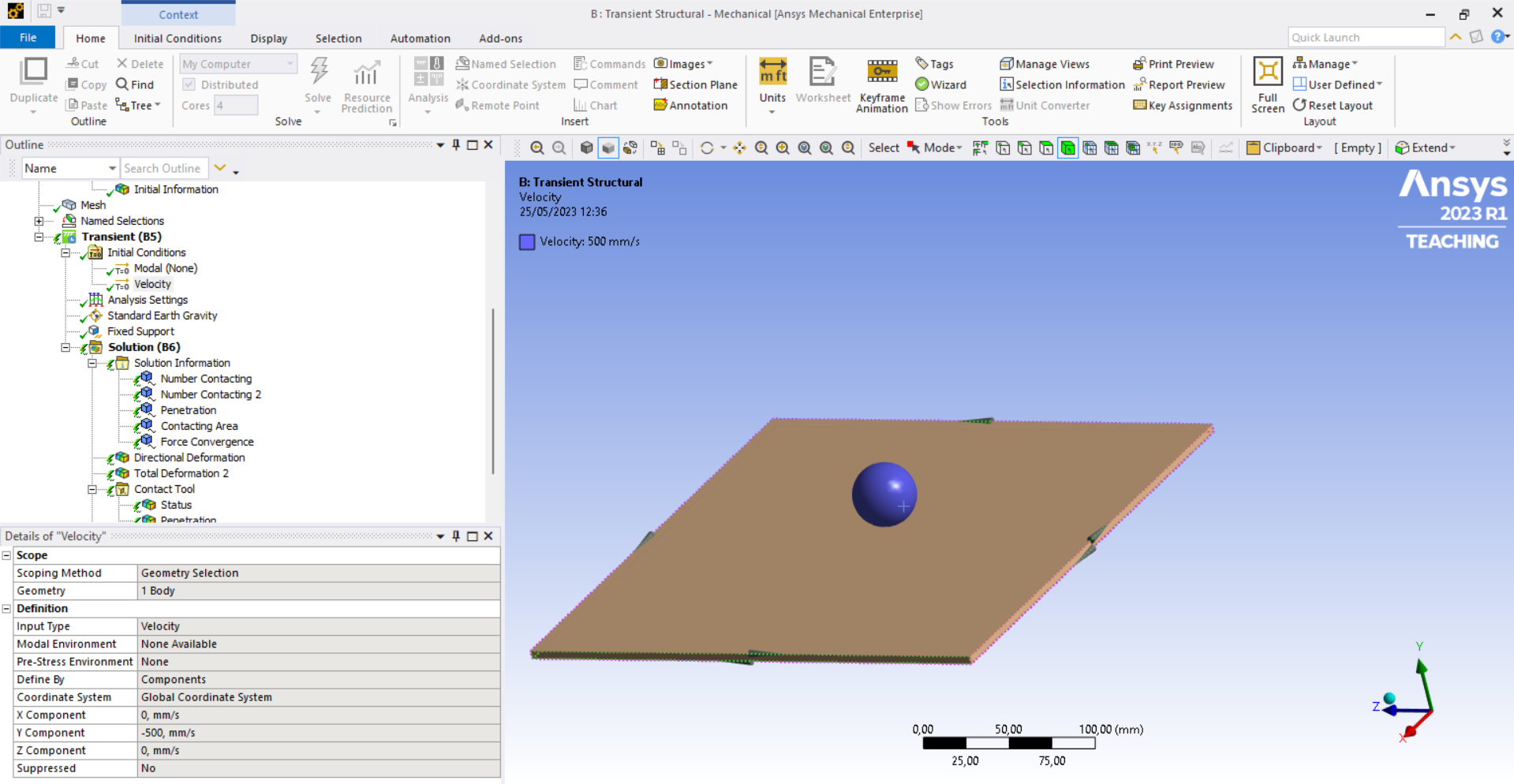

      Don’t use a Velocity boundary condition, do use a Velocity Initial Condition.
      Do place the ball tangent to the plate, don’t leave a large gap between the ball and the plate.
      In Transient Structural, under Analysis Settings, set Auto Time Stepping to On. Set the Initial and Maximum Time Step to 1e-4 s and set the Minimum Time Step to 1e-6 s.

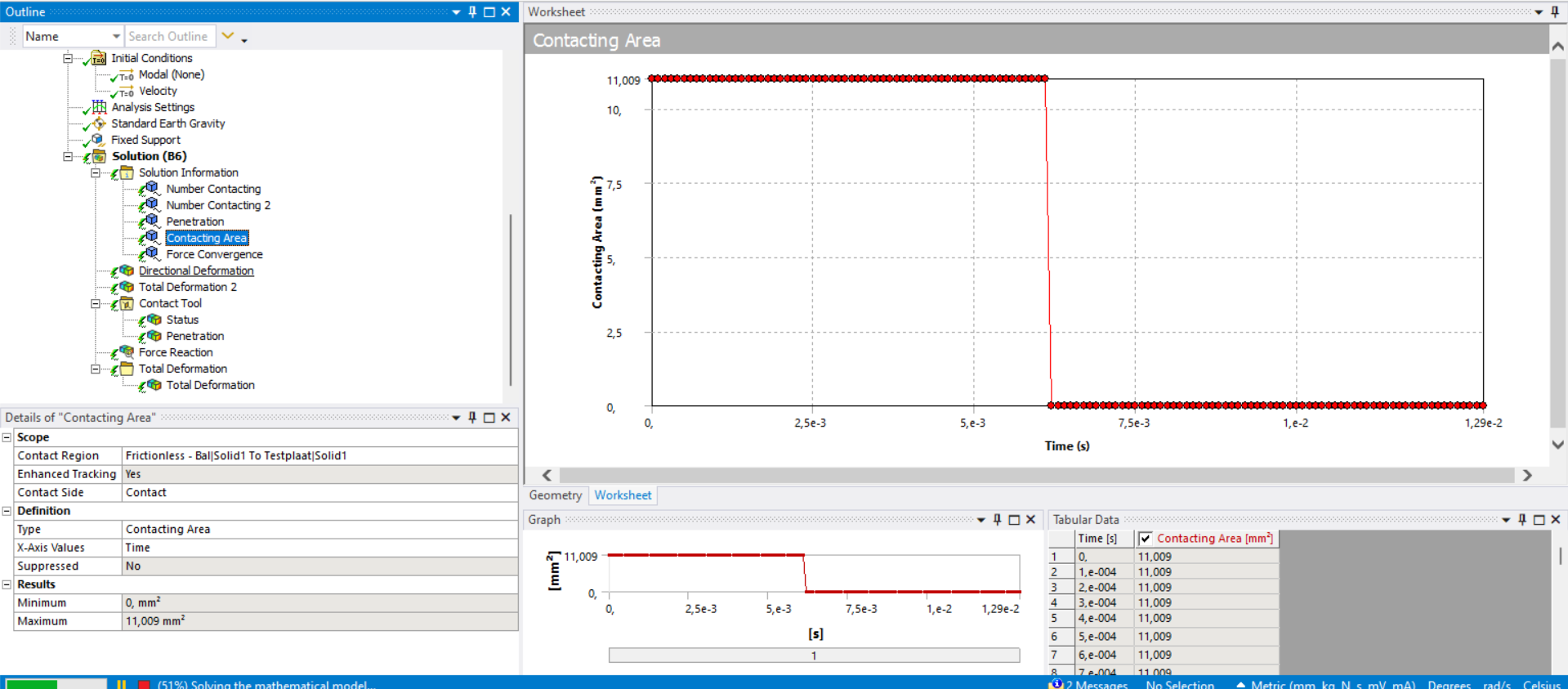

      When I place the ball tangent to the plate a gap of only a small gap exists as shown in the figure below.
      I have added the time settings you mentioned and the ball still seems to be moving in the other direction from the start when i look at the results.
      When i look at the contacting region it also is just constant and does not increase due to deformation of the plate.
      Don't plot the Contacting Area. That can be affected by the element size.
      Do plot the Directional Deformation (Y-axis) of the Ball.
      If you want to see more detail before the ball bounces off the plate, reduce the Initial and Maximum Time Step to 1e-5 s.
