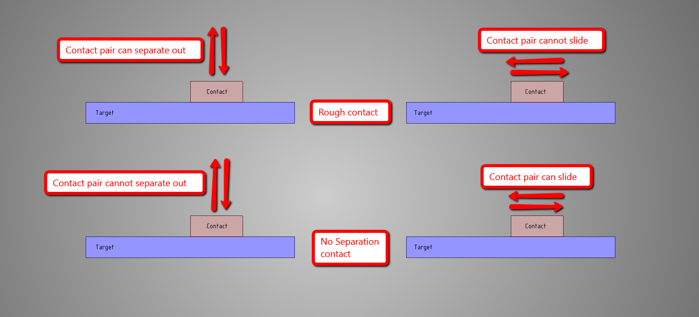

      Please tell me the meaning of each setting below and how to use it concretely.
      ・No separation
      ・Rough
    • Naresh Patre
      Hello  K.Y
      Rough contact: This contact is similar to the frictionless setting. This setting models perfectly rough frictional contact where there is no sliding. It only applies to regions of faces (for 3D solids) or edges (for 2D plates). By default, no automatic closing of gaps is performed. This case corresponds to an infinite friction coefficient between the contacting bodies.
      No separation contact: This contact setting is similar to the Bonded case. It only applies to regions of faces (for 3D solids) or edges (for 2D plates). Separation of the geometries in contact is not allowed, but small amounts of frictionless sliding can occur along contact geometries.
