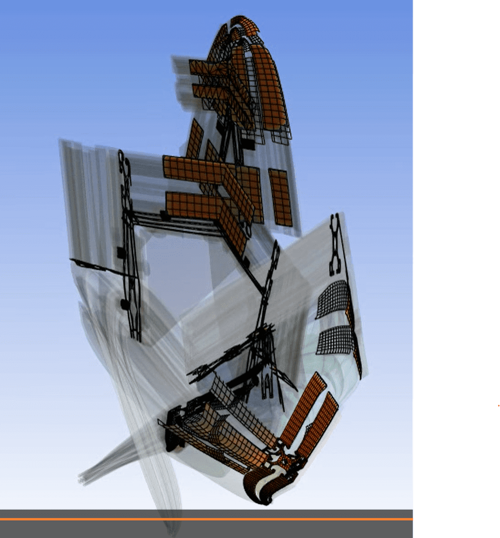

      Hi all, I'm new to Ansys Mechanical and working on a model where I'm having convergence issues. My contact tool setup result under solutions looked like this after my most recent solve (where I adjust all contacts to bonded with the intent of gradually unbonding them to find problematic contacts for convergence):
      Could this indicate anything about why my model isn't converging, and in general what's the reason for it looking like this?

      See deformation scaling / displacement scale of results should be 1 (True Scale), and it is not that in the above image - also you are probbaly looking at an unconverged result.
      All the best
      Erik

        I see, that makes sense. Thank you!
