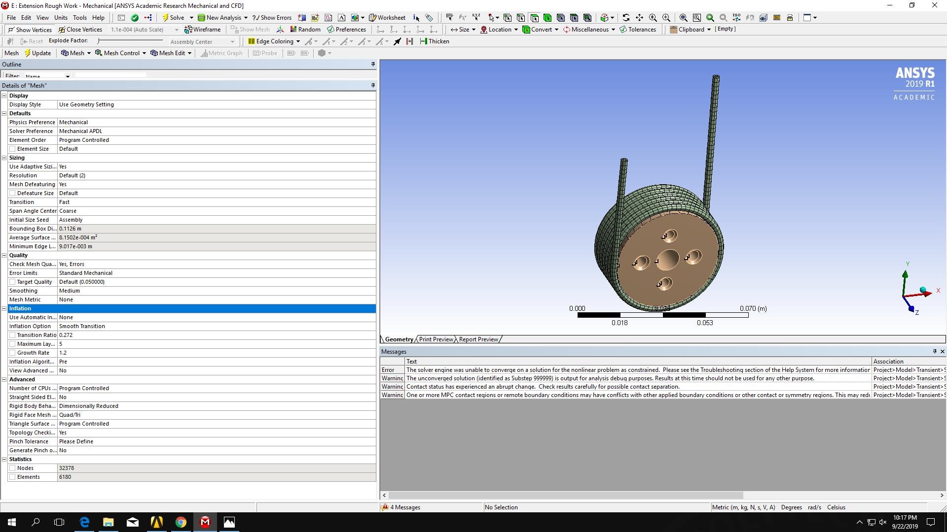

      Hello Everyone,

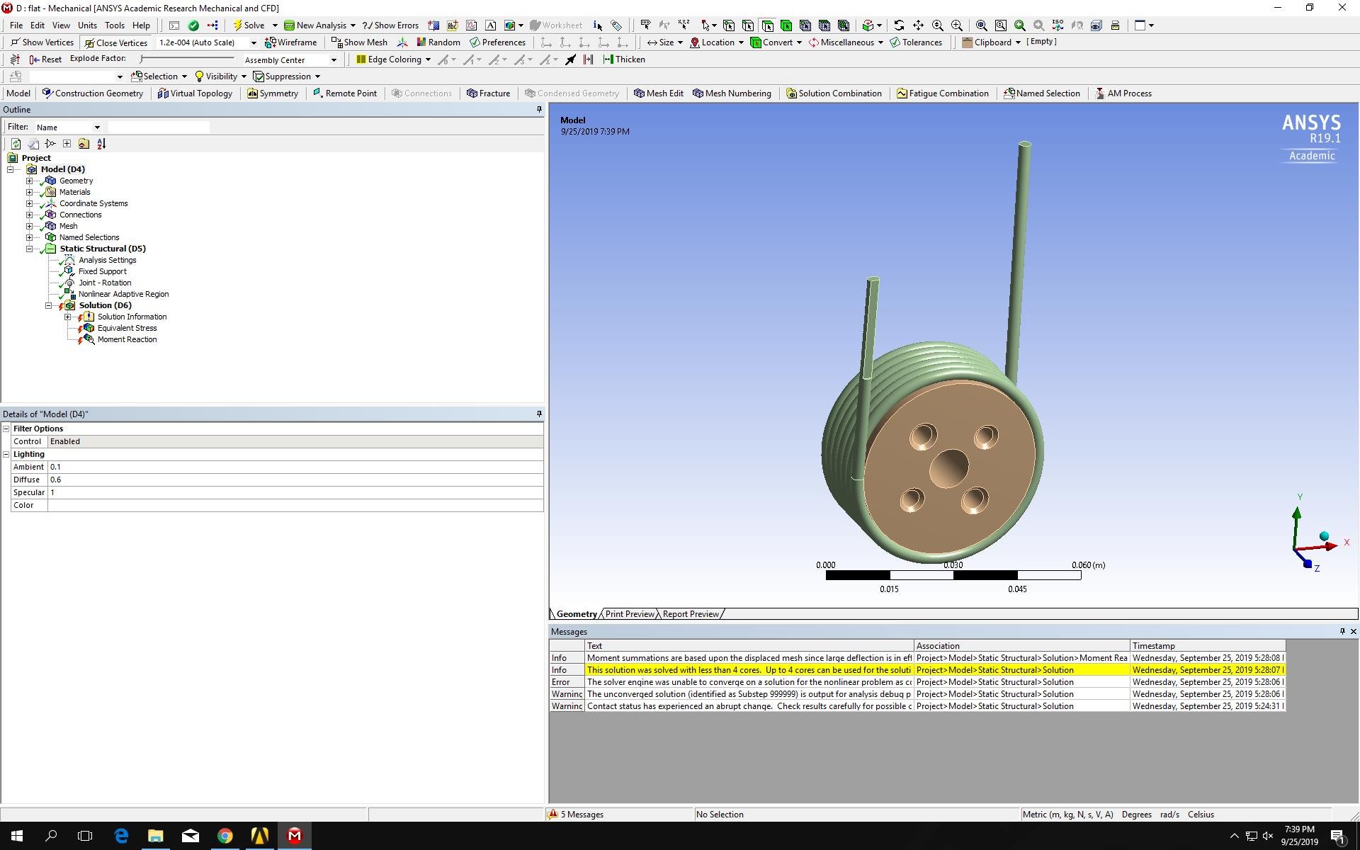

      I am trying to simulate a friction driven mechanism.I am trying to simulate a contact step control approach where the contact body has has friction during the first step and they are frictonless during the second step. I have the two contact step control for two different types of contact with status alive/dead based on steps. But I am having warning and errors when i run the simulation. Can someone help me with this.
      I referred to this link before but I am not sure if I have to change any parameters on the Analysis Settings. @https://studentcommunity.ansys.com/profile/smedikon/
      For your reference I have included pictures about the contacts and error messages on this discussion

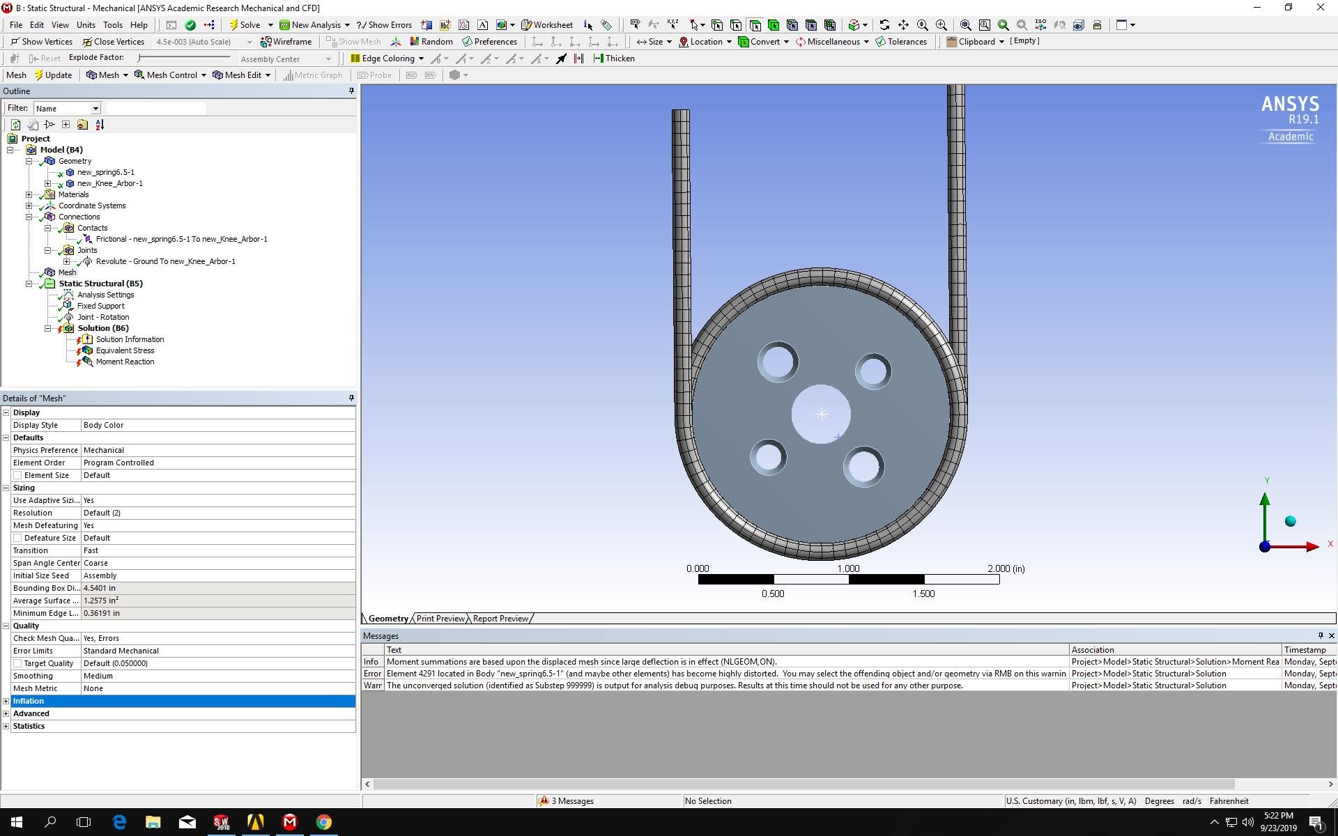

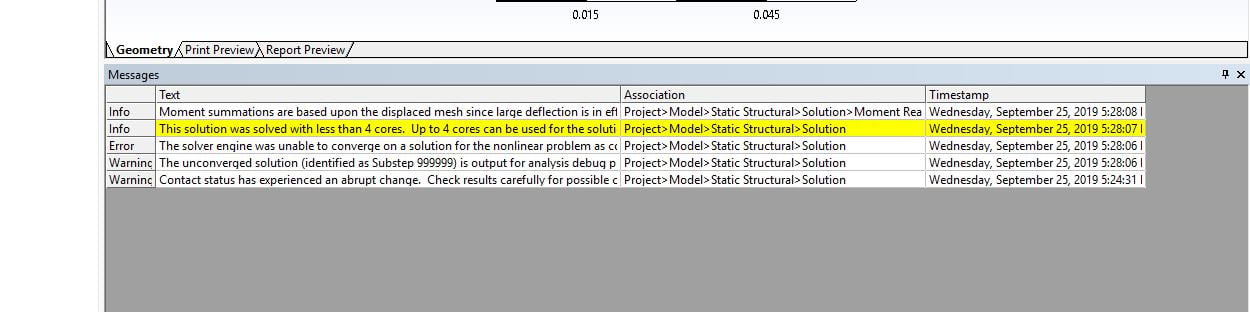

      Hey Peter I tried it the way you told me with the same values. I was able to see the movement but I am getting an error and few warning messages due to which my solution failed I would really appreciate if you could help me out with this.
      I am guessing the problem is in Mesh but can I know your thoughts on it.

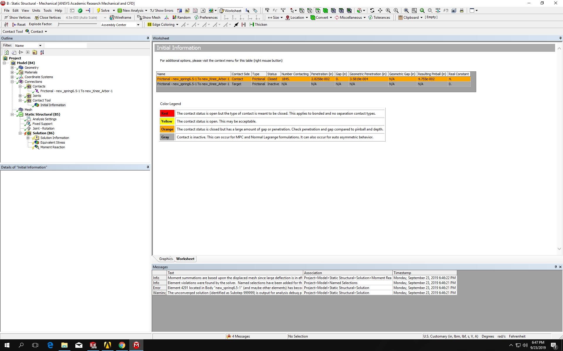

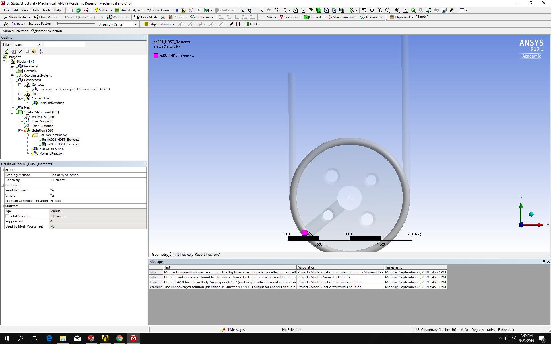

      1) The offset of 0.1 mm was just an example. It may be 100 times too large. Set it to 0 for now. Under Connections, insert a Contact Tool and Generate Initial Contact Status. That will tell you if the contact is open or closed and the size of the gap or penetration.  Reply with a screen snapshot of that table.
      2) In the Solution Information folder Details, one row is Identify Element Violations. Change the 0 to a 1 or higher number and the offending element in the Error message will be available for inspection as a Named Selection making it very easy to find the offending element.
    • vishaish
      I didn't use 0.1 mm as my interference value.  I used a value of .0279(.70866 mm)   as my interference. I am including the snipped image of the contact status and the named selection. I am not quite sure how what to do with the offending element.

      Hello Mr. Peter I tried solving the solution as per your saying.  I am not able to make it converge. I tried with different sized meshing, different step size but I am not able to make it converge. The Force Convergence and Criterion are not even crossing once I have always been getting Bisection.  And it took longer time to simulate .
      I went through your conversation and tutorial with Han yu " HOW TO SIMULATE TWO CONNECTOR MOTION". I observed a few things like Newton Raphson method and imported into mysystem to learn where the issue was. But the results that I was getting was inside the last three coils of the torsion spring. So I increased the mesh size and ran but still no convergence.
      Can you help me out with this.
      For your reference I have included the file too.
      In the Project Schematic the simulation was carried out in the Flat (Static Structural) Model.
      I am not sure how to proceed further and I am stuck at this point.

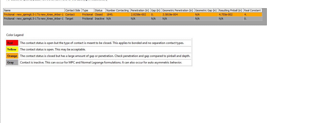

      Sorry I had to delete the mesh because the file was too big. I am including a picture of the error message and the contact tool in this post.
      Hello vishaish,
      I am travelling with a laptop with the Student license on it so I will not be able to run your model because it has 248,000 nodes and the Student license limit is 32,000 nodes. I suggested more than once to convert the torsion spring to a beam model.  That I can run on the Student license.
      You will want to define a beam to surface contact using contact elements CONTA177 and you want to set KEYOP(11) = 1 to allow you to input the radius of the beam profile 1.463 mm as a Real Constant.

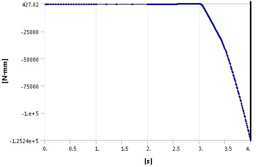

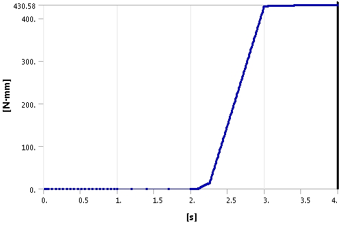

      The attached model has four steps. In step 1, a moment is applied to open up the coils, but also, there is a contact step control where the contact between the coil and the shaft is set to dead for step 1.  Then in step 2, the contact between the now opened coil and the shaft is set to alive.  In step 3, the moment that opened the coils is ramped back to zero and the coil cinches onto the shaft. Finally, in step 4, the shaft is rotated.
      There are two models in the attached archive, system A has the shaft rotate by 5 degrees, while system B has the shaft rotate by -0.15 degrees. The result was that rotating by -0.15 degrees had a constant 430 N-mm of torque, while rotating by 5 degrees had a constantly increasing torque. Look at the graph between 3 and 4 s.
      System B
      System A
      We can see that in system A, the torque to rotate the shaft increases with the rotation angle up to a very large value, indicating the clutch is gripping.
      We can see that in system B, the torque to rotate the shaft is small and constant, indicating the clutch is slipping.
