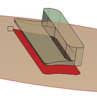

SubscriberWhen your shell elements are at the midplane and the solid elements are t/2 distance away, you have to use contact.
There is a way to project the curves from the solid onto the shell to divide the face so the contact can be limited to the appropriate area. Below is an illustration with a 4 mm thick shell or a 2 mm gap.

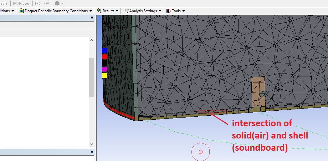

February 22, 2018 at 9:52 am
emirdegirmenli
SubscriberThank you Peter, You are right, If I use shell element with "middle" offset type and I move it t/2 distance away, faces isn't split and I can contact bridge and soundboard. but, I have faced a different problem. all surfaces of geometry contact with air (solid) inside, so I am using share topology to contact surfaces and air as recommended for vibro-acoustic analysis. in this case, intersection mesh area is formed ;as you can see and mesh quality reduces. If I separate, they aren't bounded by using share topology. As a result, If there is any way to solve bridge and soundboard contacting problem by using shell element "bottom or top" offset type, ? think it will be very useful for vibro-acoustic analysis. Best

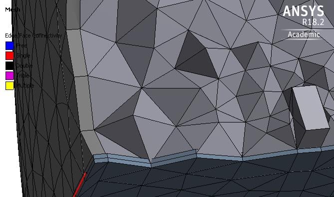

SubscriberEmir, it is just a visual artifact that is part of rendering the shell thickness.
In your previous model, the soundboard offset was set to bottom, so when the graphics renders the thickness it shows on the outside.
When you changed the soundboard offset to middle, the nodes all moved out by t/2, including the air. If you uncheck on the View menu Thick Shells and Beams, you will see a clean connection of elements between the air and the soundboard. There are no new elements. Below is the image for when that is unchecked.
Below is the image with checked.
Below is the image if I change the soundboard thickness to 8 mm.
I hope this clarifies the meshing.
