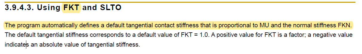

    • help_me
      thanks for these comments.
      this equation KT for contact stiffness in the case of Lagrange but what I need the relation between FKT and (FKN, MU) in the case of Pure Penalty. In Ansys Manual "The program automatically defines a default tangential contact stiffness FKT that is proportional to MU and the normal stiffness FKN."
