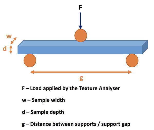

      How can I define proper contact for 3-bending beam test in Ansys APDL ?
      I suggest you initially analyze 3-point bending of the sample without contact.
      • Selami Tunca
        It does not work. Why should I analyze without contact?
      Analysis without contact is simpler to setup and get a solution.
    • Selami Tunca
      it is not possible to solve. I have rigid body motion error without contact.
      The sample length should be exactly equal to the distance between the support.
      You didn't show a coordinate system, so I will assume that the sample length is along the X axis, the Y axis is up and the sample width is along the Z axis.
      On the left end bottom edge of the sample, use a Displacement and set X, Y, Z to 0.
      On the right end bottom edge of the sample, set Y and Z displacements to 0.
      Now you have sufficient constraints and the system will solve if you apply a force to the row of nodes in the center on the sample on the top face.
