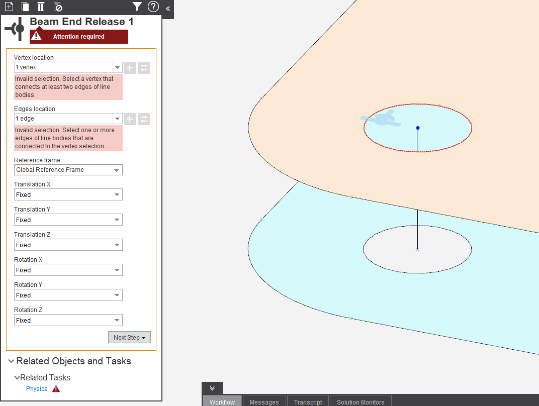

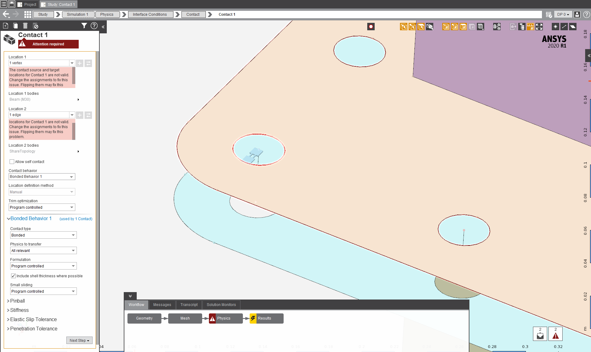

In AIM 2020R1, If I try to model a bolted connection with beam element (line body), then I can't set up bonded contact between beam's vertex and bolt hole's edge. Can you explain this please?

Bonded contact cannot be applied on vertices. You can add a Beam end release interface condition to define the interaction between the Beam and the edge.
Bolt Pretension Structural condition can be Modelled as per bolt location or as common for all locations, but modelling the bolt beam element interaction needs to be done manually at each location.

SubscriberHello Subashni
Beam End Release only can be applied on vertices sharing two or more beams, see AIM' help:
"To define a beam end release:
1. For Vertex location, select the vertex location where the end release is to be applied. This vertex must
be shared by two or more beams."See following pitcutre as well:
Can you illustrate me (or send a file)Â how to idealise a bolted connection with shell elements for plates and beam elements for the bolts including the bolt holes as well, please?Â
