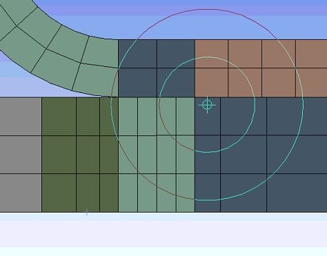

Ansys EmployeeBut aren't they already penetrated? Its hard to tell, can you hide the parts that are opposing and post a pic? Sometimes, you have to interchange contact and target surfaces.
If you just want the geometries to remain attached, why don't you try the boolean operation on geometries that Peter suggests in this video.

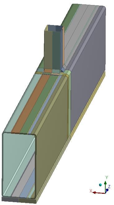

SubscriberIn DesignModeler, you have Multibody Parts, but the bodies are not grouped in a useful way. For example Part3 has bodies that don't touch each other.
What is the goal of your analysis? Is it to analyze the stress in the triangular sections that look like they may represent welds? If so, I can see why you might want the large and small rectangular tubes to be two separate parts, then the weld beads to be two separate parts and use bonded contact to obtain the force going though the weld beads.
What is the intent of the thick plate on the bottom of the large tube? That can be left as a separate part.
The correction is to Explode the existing parts, and recombine them into those four meaningful parts.
You could get a nice mesh with no slicing. I changed all extrusions (except the first) to Add Frozen.
Now you have 5 solid bodies, each nicely sweepable, and you can use two bonded contacts to connect the two weld beads to the big and small tubes, and another contact to connect the thick plate to the bottom.
You also have to suppress the 3 surface bodies, as they are not involved in the simulation, right?
 I see that you want to do a 1/4 model, so you do need two slices to do that, but no more!

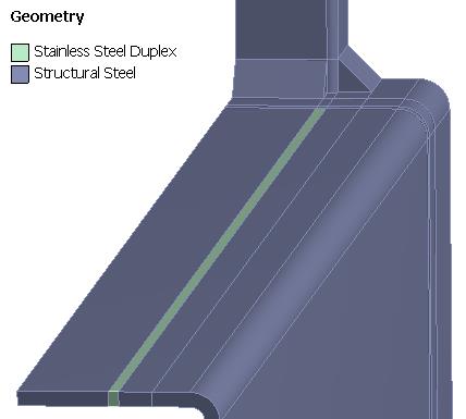

You have bonded contact between the small tube and the large tube, and the highest stress is in the corner. Did you intend for those faces to be bonded as well as the weld beads?

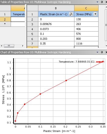

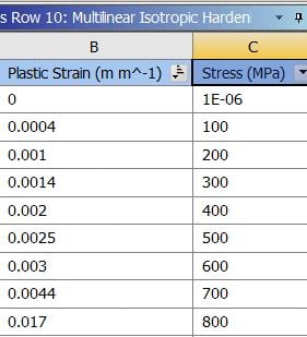

If you click on Geometry, you can display by Material. I expect you meant to have a different material assignment than what is shown below.
If I change all the bodies to Duplex, I see you have Multilinear Plasticity included.
The first entry for stress is supposed to be the yield strength. Why so low a value?
Have you entered True Stress and Plastic Strain, not Engineering Stress and Strain?
See the spreadsheet in this article Sandeep has pointed to before.
When you use plasticity, you must turn on Large Deflection under Analysis settings.

SubscriberYou should delete the bonded contact between the small tube and the large tube, leaving only the weld bead contacts to carry the load.
To get accurate results, you need to take the Engineering Stress-Strain curve and use the equations to compute True Stress, Plastic Strain, Elastic Strain and True Strain. The curve of True Stress-Strain has higher values of stress than Engineering Stress-Strain.
Here is another reference to creating a Multilinear Plasticity Hardening Table. This is a little more complicated than the reference given above because it is using experimental data that includes an offset on the Engineering Strain zero.
Please share the reference you have for the stress-strain curve for the Duplex material. What is the Yield Strength of Duplex? What is the Young's Modulus of Duplex?

SubscriberThe attached spreadsheet shows what to put in the material definition for multilinear isotropic hardening plasticity. The first row to use in the model is where the plastic strain begins increasing from zero. The previous rows with negative plastic strains are not used.

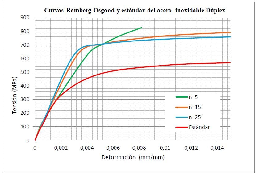

SubscriberI will look at the model next, but first I wanted to ask about the column headings from Table 2. Are the subscripts values of strain? What does the subscript p mean? I expect the subscript u means ultimate stress at failure.
I didn't understand what you meant by "I'm not sure if IÂ can reduce values to 323.279 MPa ...", please clarify.
Also, what is the meaning of the red curve that is labeled Estandar (Standard)?
Finally, instead of digitizing values off the curve, which results in some wobbles about the true curve, I suggest you fit the three parameters (alpha, E0 and n) for the Ramberg-Osgood model to the data, then create clean data points from the equation. That way the slope column in your spreadsheet will have a smooth decrease in slope instead of the wobble it has from the digitizing errors.

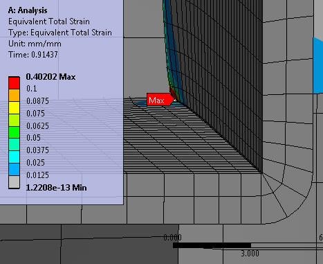

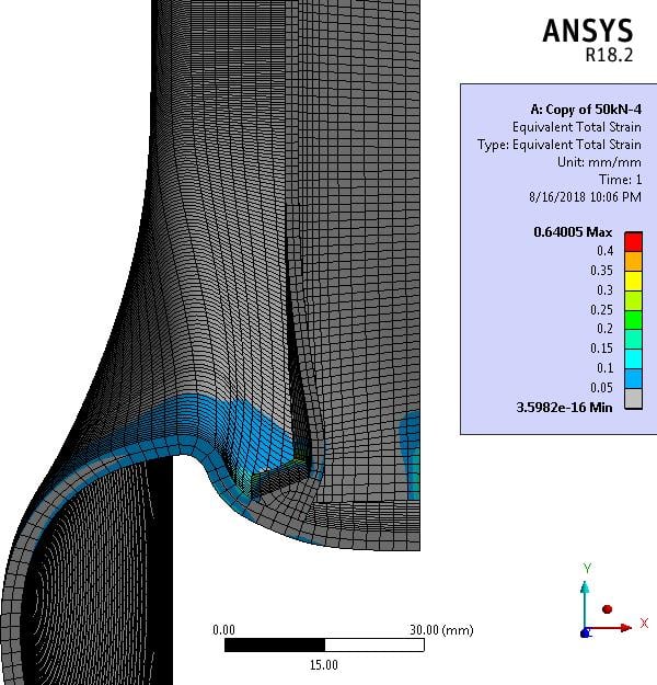

With plasticity models, it is often required to set a large number of Minimum Substeps to ensure that plasticity occurs in small increments. I have changed the Initial and Minimum Substeps to 40 instead of 12, which allows the solver to make progress.
Now the solution has progressed well past the point where the material failure occurs at a Total Strain of 0.4
At 91% of the 14 kN load on the quarter model, the material has reached the elongation at break value of 40%
Note that the total load is 4 times 14 kN or 56 kN on the full model.

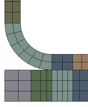

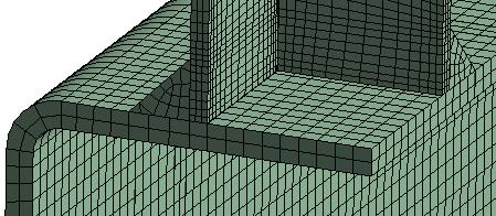

I recommend using smaller elements on the weld fillets.
You can add frictional contact between the base of the small tube and the top of the large tube to help support the compression load.Â
You also should have more elements through the tube thickness.

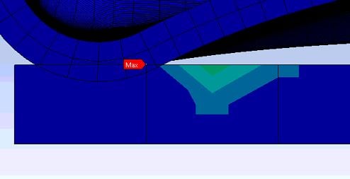

The maximum strain is where the material is in compression. You should look where the material has maximum tension since the material can tear apart in tension, while the material may be able to support higher values of strain in compression.

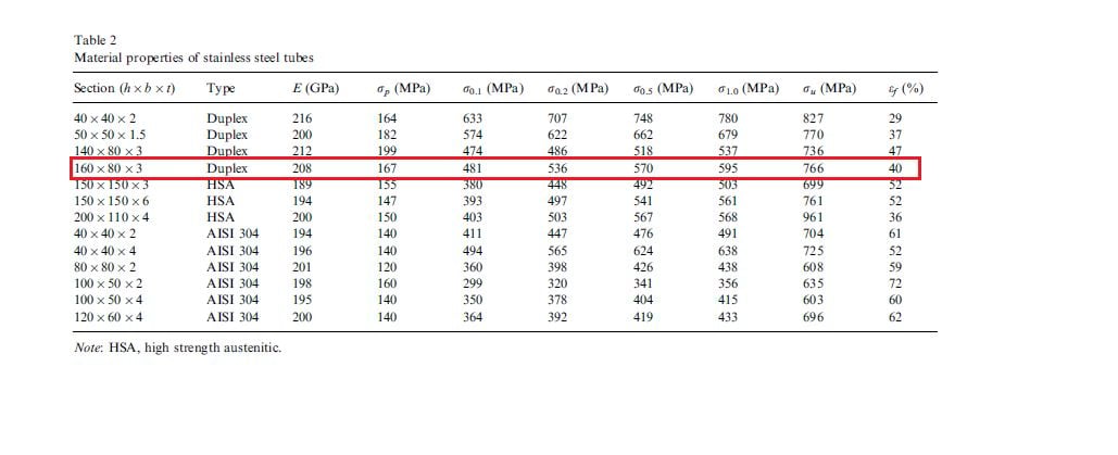

1.
subscript p = tensile proportional limit stress
subscript u= statis ultimate tensile stress
susbscript 0.1 = static 0.1% tensile proof stress
about the author.
2.
About the values (323.279 MPa) is ignoring the negative values in plastic stress.
3.
The red curves is the standard of the material (state in the European standards), the values used in the analysis are from test.

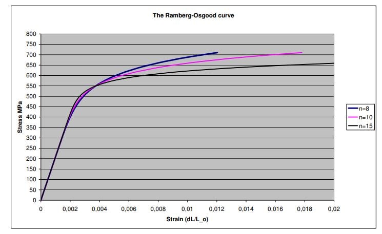

SubscriberDear mekafime,

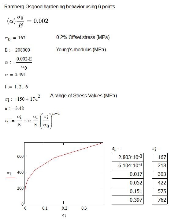

About that table, you say P = the proportional limit, which is typically at 0.002 strain or 0.2 % strain, The only other value I understand is U = Ultimate stress of 766 MPa and the value of strain for that is given as 40% in the table. What is the strain at the other values of stress in that table between the two ends?
About the idea of fitting the data to the Ramberg-Osgood formula, the benefit of using a formula for the material model is that you will be able to generate Stress values for strain up to 0.4 where failure occurs. Your current material model only goes out to a strain value of 0.011 but the solution is stretching the material beyond strains of 0.4 which means the solver is using a flat line after the last value of strain in the table. It is a best practice to have a material model table that includes all the values of strain encountered during the solution so that it is not extrapolating past the last point.
Since alpha and proportional stress are given in the table, I could adjust the value of n until the curve went through 766 MPa at a strain of 0.4 and that value of n is 3.48 so the curve below might be a better material model for large strain than the material model you fit to the relatively smaller strains of 0.011.

I modificated all in mesh and connects, but in substep:Â
- Initial substeps = 40
- Minimum substeps = 40
- Maximum substeps = 60
But I have the same error ..

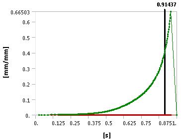

SubscriberOkay, but how far did it get? What was the Total Strain at the last converged substep?
August 16, 2018 at 7:27 pm
August 16, 2018 at 7:54 pm
peteroznewman
SubscriberIf you show the Force Convergence Plot, that gives an idea of how far it got.Â

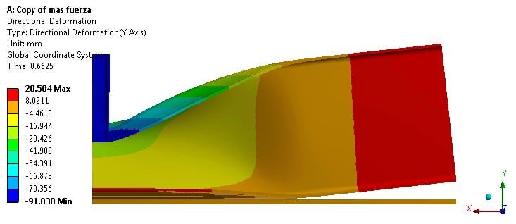

SubscriberOne more change is to the table of data for the Multilinear Isotropic Hardening.
I looked up the TBDATA command and it can only hold six points!Â
[EDIT: data is not in a TBDATA table. More than six points can be used.]
Here is the a table based on the Ramgood-Osgood model I wrote about above.
In hindsight, I would have put the points closer together at low values of strain, and spaced them out at the high values of strain where the function has less curvature.
Below is a more optimal spread of points. Note that below is Engineering Stress and Strain.
The attached ANSYS 18.2 model solved to the end and had an interesting deflected shape. This is true size deformation.
Probably could have run with a Minimum Substeps of 20 instead of 100.

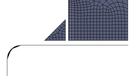

The problem with the license was because the university updated Ansys to 19.1. I made some changes:
The radius was modified, add weld in the radius of the brace:
I changed the restrictions for the model that is the fourth part and I changed it by symmetry region.
The material of the weld is bilinear isotropic hardening:Â
But the model throw the following results:
- The solver engine was unable to converge on a solution for the nonlinear problem as constrained. Please see the Troubleshooting section of the Help System for more information.
- The solution failed to solve completely at all time points. Restart points are available to continue the analysis.Â
- The unconverged solution (identified as Substep 999999) is output for analysis debug purposes. Results at this time should not be used for any other purpose.
- Although the solution failed to solve completely at all time points, partial results at some points have been able to be solved. Refer to Troubleshooting in the Help System for more details.

mekafime
SubscriberHi Peter,
The video is very useful, I have tried to refine the mesh, but the problem persist, and the time has increased in the analysis.
The problem is this part of the model.
I have tried many mesh configurations, the ultimate mesh was this, but the model has errors, Could the problem be another?
Thanks for your time.

peteroznewman
SubscriberHere is what I see in the model, so Sandeep can see too.
And here is the mesh.
Here are the changes Sandeep is recommending, which I agree will help.
The Normal Stiffness Factor is 1.0 by default. Above I increased it to 10. I also changed the Detection Method and changed the Update Stiffness setting. I would also recommend more nodes around the radius. I guess you are no longer limited by the Student license.

September 1, 2018 at 11:03 am
peteroznewman
SubscriberHi Mekefime,
Here is the Force-Displacement plot for the above run in blue.
I drew in the red curve by hand to illustrate what a displacement load can do that a force load cannot.
The red curve is not data, it's just a sketch. I am running the model with an actual displacement load now.
The force load was asked to find an equilibrium at each incremental increase in load from zero to 25 kN. The problem is there is no nearby equilibrium for a small increase in force past 16.5 kN. You have to wait till you crush the 154 mm tall tube down to nothing and the vertical tube starts pushing on the bottom of the horizontal tube.
A displacement load has no problem following the solution past the point of zero slope on the force-displacement curve, because there is an equilibrium past that point, it just has less force that the earlier points.
If you request the reaction force from the displacement boundary condition that is set to Y = -150 mm, you can plot the force-displacement curve.
Peter

peteroznewman
SubscriberHere is what I got after adding frictional contact between the top and bottom inner faces of the large tube. Note that the convergence failed when the new contact closed, but I just restarted it with 500 Initial Substeps and it completed the solution.
Right click on the video after it starts and select Loop to make the video play over and over.
https://youtu.be/rxJJ11bPk_A
Here is the reaction force plot for the 150 mm displacement.
Once the top-bottom contact closes, the force spikes up.
Once the vertical tube buckles, the force begins to reduce again. Awesome! -
