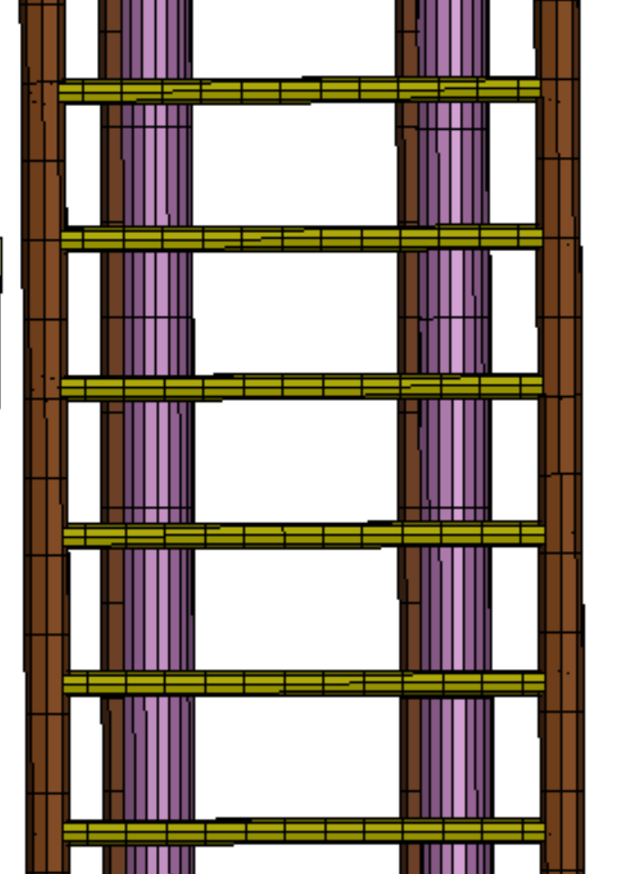

I modeled a postensioned concrete column where I used hollow solid part to represent prestressing sheat/duct and I also used a T-shell element to create the same. For prestressing strand I used a beam/cable material then I applied beam in solid penalty contraint and also tried different contact types like autmatic surface to surface, single surface, and beam to surface. However, I could not prevent the penetration of cable through the duct wall when the column is loaded in lateral direction. At the same when I am looking at the contact between cable and column or duct and column it seems working because when both come in contact with the column they move and not penetrate into each other. Please give me your feedback how to make this contact between cable and hollow solid part.

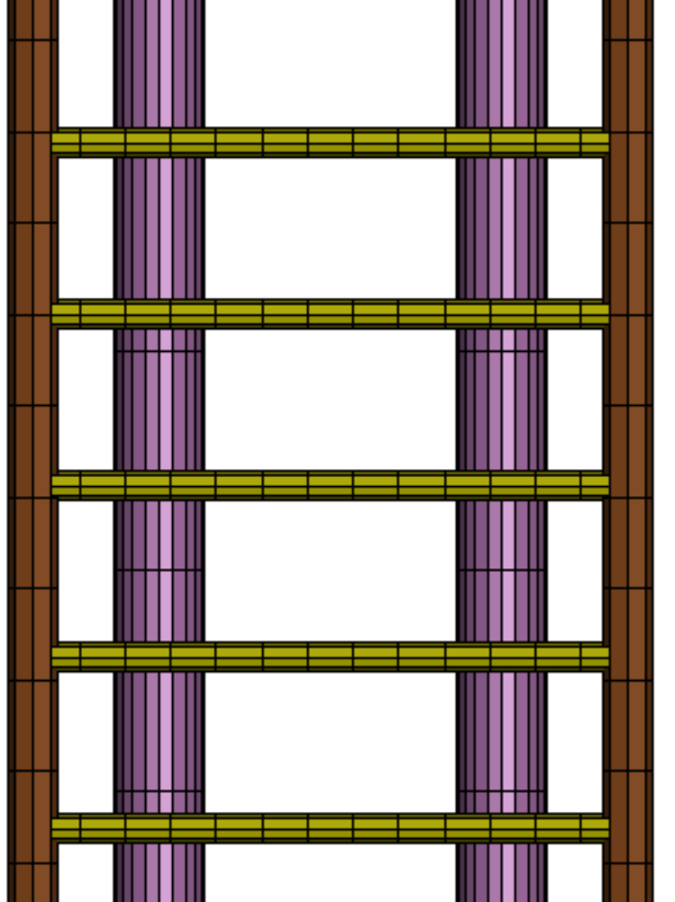

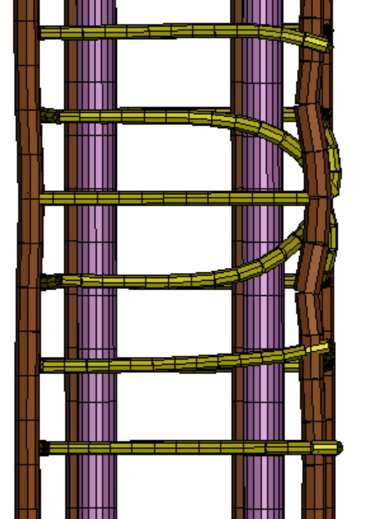

SubscriberThank you for your detailed answer. I am sharing a couple of image before the load is applied from the left and during the loading condition. The brown color part is the cable/strand and the purple is the duct which is a solid hollow part. As you can see they are not overlapping but once the load hits, the duct is dislocated but strand is still in its place until it comes in contact with the column inner wall of the main longitudinal hole

Ansys EmployeeElements seem too long on the duct (purple part) in the vertical direction.

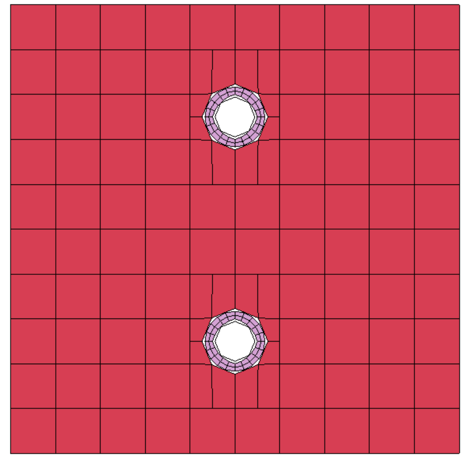

SubscriberThanks for your help. You are right I rememberd to attached the top view of cross section after submitting my querry. However, I am sharing it this time. the beam element is only shown with 8 edges.
I did made the duct elements smaller and run the model, it did not help in preventing the penetration but the over all dislplacement was a bit larger than the model with twice bigger duct elements.
Second run I used the automatic general contact but I think the model became unstable as the image shows the stirrups are skewed unrealistically. Also the penetration was still there between duct and the strand.
