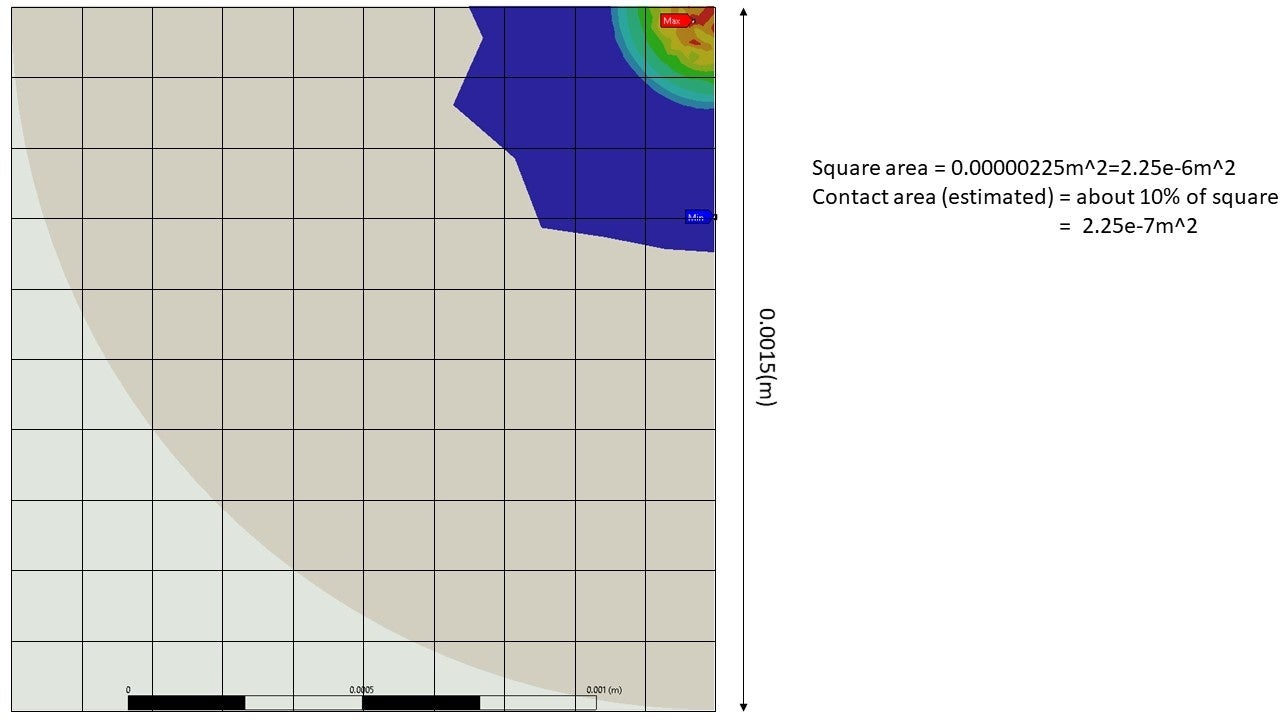

If it solved, under the Solution branch, insert a Contact tool. Right click on the contact tool and insert a Pressure result. Now you can see which elements have a pressure to help you estimate 1/4 of the contact area.

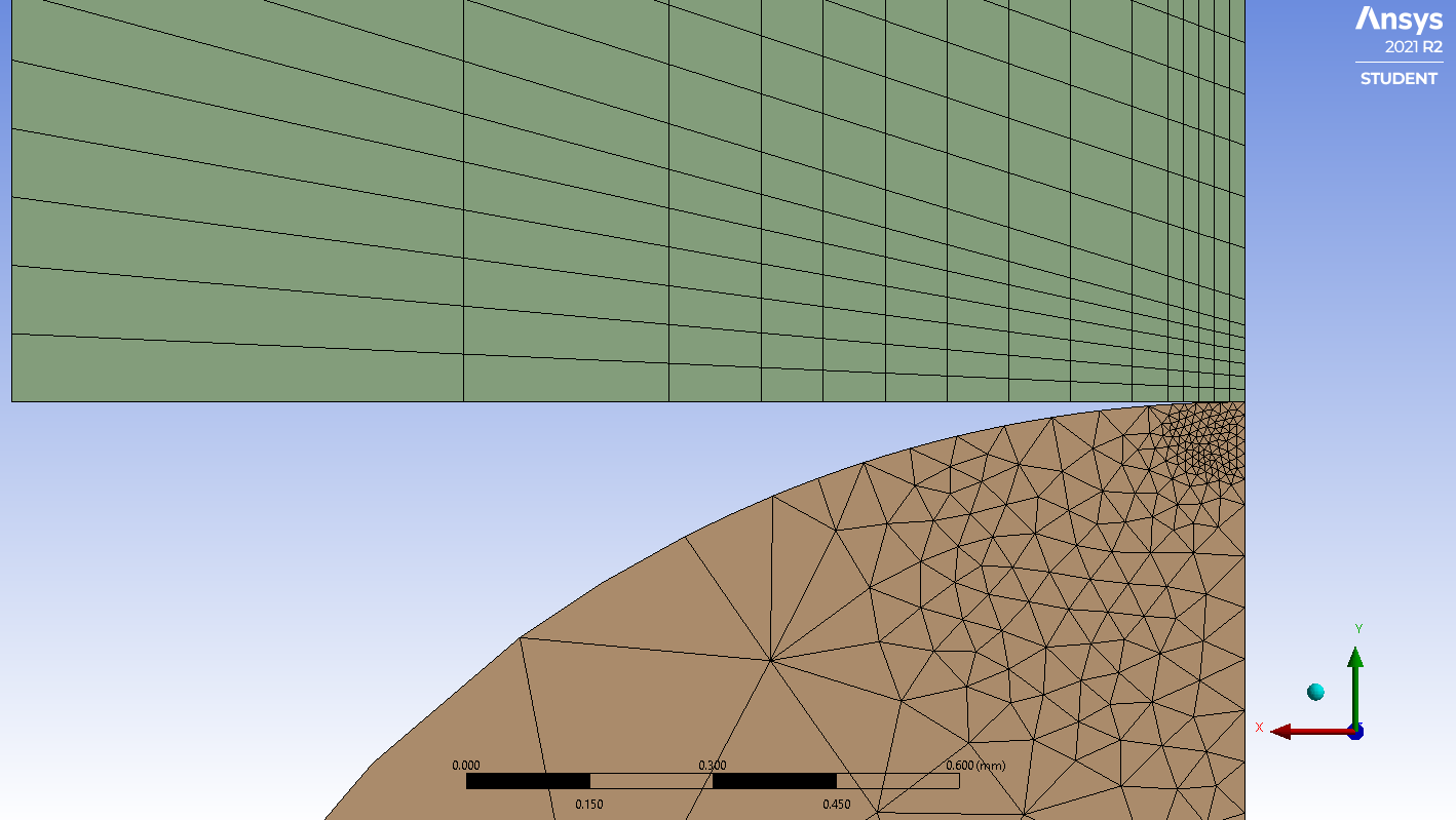

Try using a coarser mesh. The mesh below was made with two Body Sizing controls that used Sphere of Influence. That required a Coordinate System to be created at the vertex. A coarser mesh will also make the solution compute much faster. With those changes, I had no problem converging with 2.4 N of load.

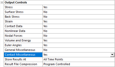

To get your code to work, you just need to change the Output Controls under the Analysis Settings to say Yes to Contact Misc.

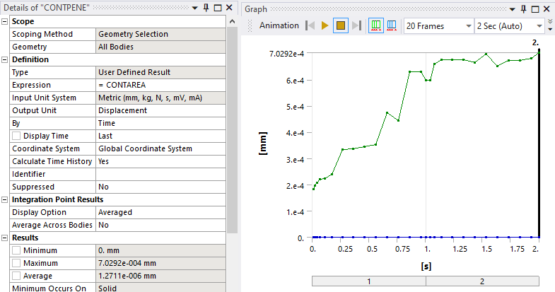

1) I changed "the Output Controls under the Analysis Settings to say Yes to Contact Misc," but I could not get the area values using "commands (APDL)" or CONTPENE menu. Could you take a look the attached?
2) Is your graph (the last figure) for depth (mm) or area?

September 29, 2021 at 10:14 pmSeptember 30, 2021 at 2:49 amsblee
SubscriberOk, I use 2021R2 and I could get the same plot. Thanks.

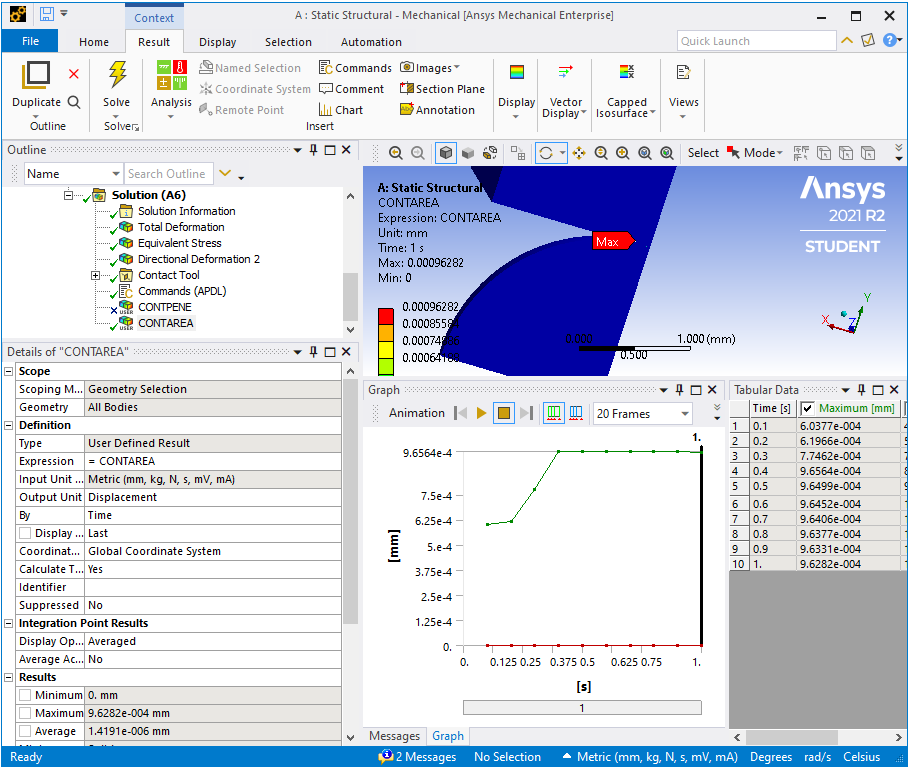

But I want to figure out the contact area (as number). I could get three different numbers from
1) CONPETE = 3.1826e-006 m (displacement dimension)
2) CONAREA = 9.6282e-007 m (displacement dimension)
3) command (APDL) = 4.1898e-008 (probably m^2)
But none of them looks close to my estimation from "pressure" contour (as you answered to my first posting) which is 2.25e-7 (m^2) - see attached.
Any thought to get an exact number for
contact area? Really appreciate it!
