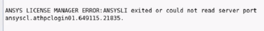

SubscriberI have Ansys Fluent, and workbench installed on an HPC, and a license server connected elsewhere.
There's another instance of Fluent running on a third machine, that will connect to the license server and validate properly. However, on our HPC we get an error when trying to connect to the same server.

Forum Moderatora successful ping of the license server doesn't rule out firewall or other connection restrictions. To test the access, you can use one of these options, please try for the lmgrd port, ansyslmd port and ansysli_server port, modify the command to replace "192.168.0.1" with the license server hostname.
Telnet 192.168.0.1 1055
nc -v -z -w2 192.168.0.1 1055
(echo >/dev/tcp/192.168.0.1/1055) &>/dev/null && echo "Open 1055" || echo "Close 1055"
Please make sure the port for the ansyslmd daemon is on the license server firewall.Starting with 2021R1 the applications must communicate through ansyslmd and lmgrd, where past releases used lmgrd and the ansysli_server process on 2325.
You can set ansyslmd to a static port by adding it in the license file on the VENDOR line.
For example:
VENDOR ansyslmd PORT=1056
On the Client side, please make sure there are no firewalls that could be blocking the ansyscl process from communicating.

SubscriberThank you for the response! I tried the first command, telnet to the hostname of the license server with all 3 ports, and was successful, I got "connected to {hostname} on all.
I confirmed with the team responsible for the licensing server that static ports are set, including the VENDOR ansyslmd, and those ports are opened on the firewall on both ends, the client and licensing server.

Forum ModeratorWhat is the OS on the HPC systems where you are trying to run?
May 11, 2021 at 10:46 pmjamiemjohnston
SubscriberRHEL 8.2
May 12, 2021 at 11:26 amANSYS_MMadore
Forum ModeratorRHEL 8.2 is not supported and is known to have serious issues. Please revert to a base RHEL 8.1 OS or other supported platform as noted in our platform page.
https://www.ansys.com/content/dam/it-solutions/platform-support/platform-support-by-application-product-2021-r1.pdf
You may try to downgrade to krb5-libs version 1.17-9 (sudo yum downgrade krb5-libs.i686 krb5-libs.x86_64).
May 12, 2021 at 7:22 pmjamiemjohnston
SubscriberThank you for the information! I will try downgrading the krb5 package and see the results.
Importantly, what should the ansyslmd.ini file look like? You mentioned past releases use ansysli_server and lmgrd. I'm still using that, how do I switch to ansyslmd and lmgrd in the client side file?
May 12, 2021 at 7:27 pmANSYS_MMadore
Forum ModeratorThere's no change needed on the client side for the change at 2021R1. You still have both entries to support versions below 2021R1. If you only have 2021R1 and newer there wouldn't be a need for the ANSYSLI_SERVERS line in the ansyslmd.ini file.
May 18, 2021 at 7:24 pmjamiemjohnston
SubscriberTook me a while to get back to this and respond, however your suggestions did work and Ansys is now running on our HPC! I can't thank you enough, excellent help!
