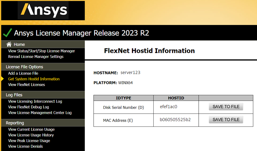

      / Setting up Ansys License Manager for Express Setup
      With Express Onboarding Setup, since there is no Active Directory, AWS DNS is used for resolving hostnames. For Linux machines the hostname is set appropriately and is of the format ip-x-x-x-x.region.compute.internal. Windows hostname should be similar but Windows OS does not accept “.” In the hostname. AWS instead creates a dummy hostname of the format “EC2AMAZ-xxxxx” which is not resolvable to an IP address. The hostname displayed on Windows VDI tile on Ansys Gateway interface of the format “ansxxx” is also a dummy hostname.
      To address above issue, Ansys License Manager should be configured to use private IP address instead of hostname. Before using the license file to setup Ansys License Manager, ensure that the private IP address of the server hosting the Ansys License Manager is used.
      1. Using the hostname as shown in Ansys License Manager below will not work due to the hostname resolution issue mentioned above. Use private IP address.

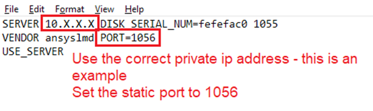

      2. When you receive your license file, you will need to edit the file to replace the server hostname with the private ip address of the license server.
      3. You will also need to add the static port for ansyslmd by adding PORT=1056 on the SERVER line.
      To summarize, using private IP address for any communication within VPC should work.
