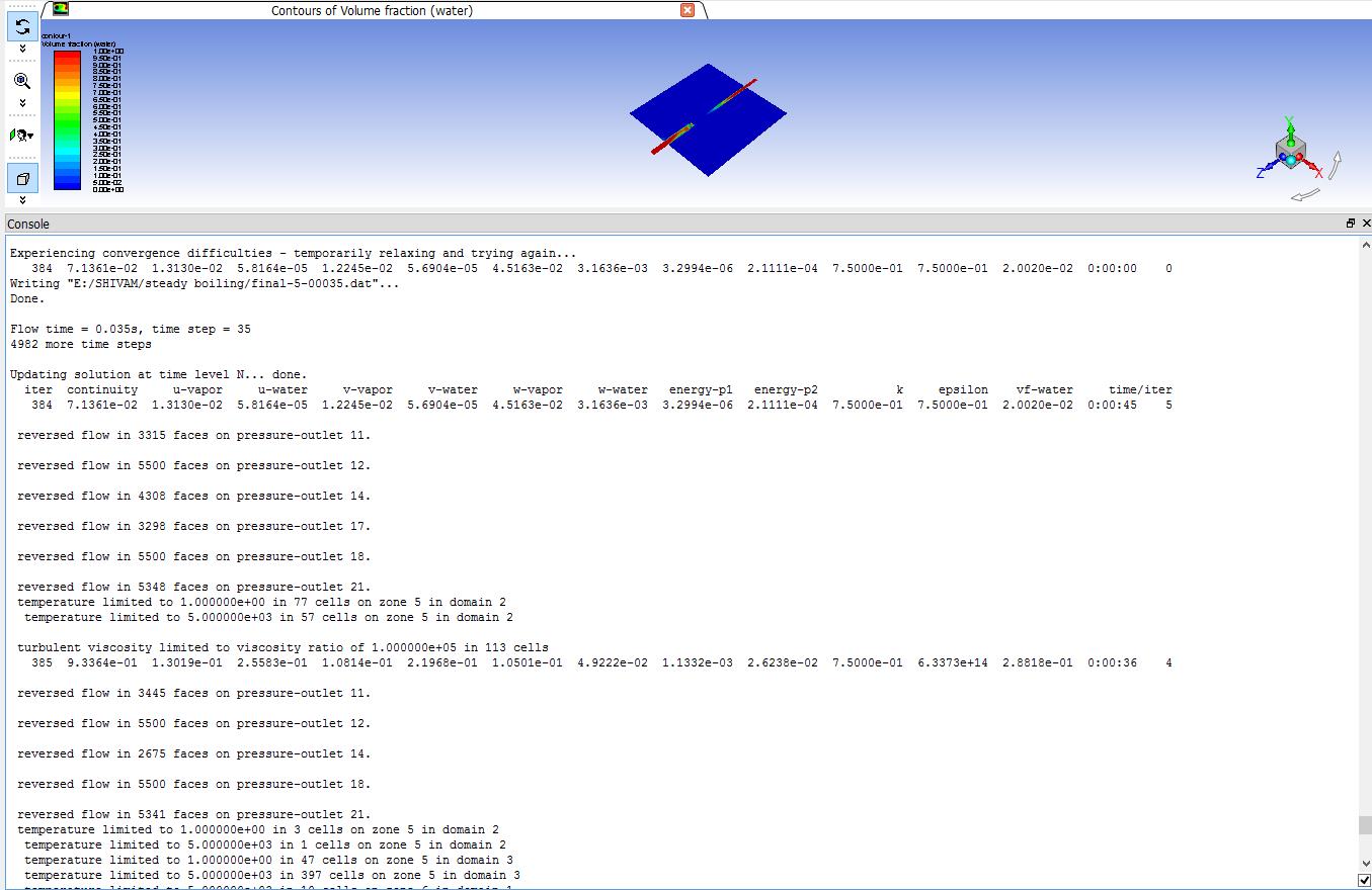

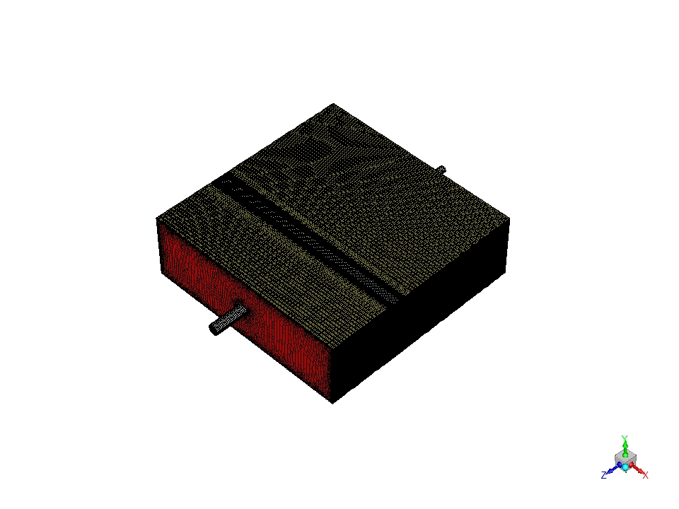

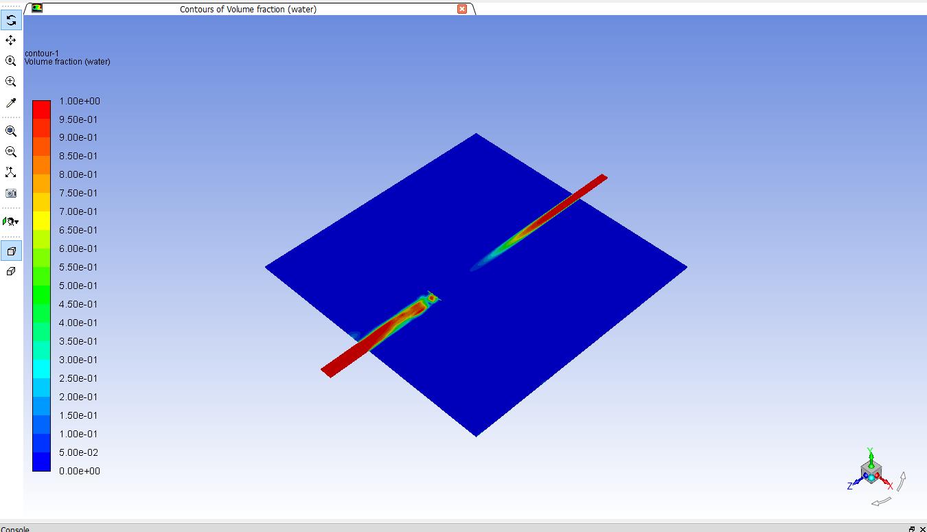

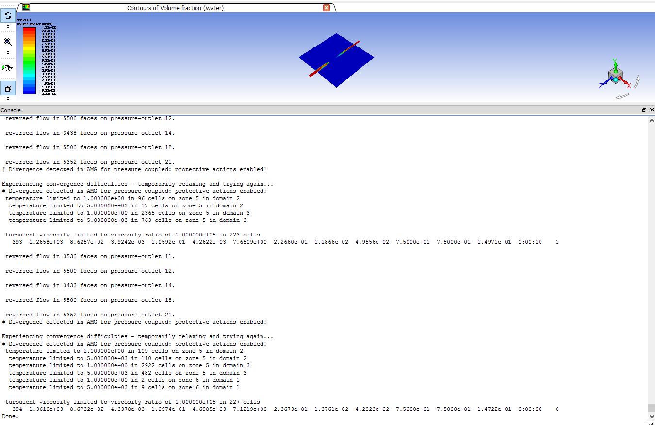

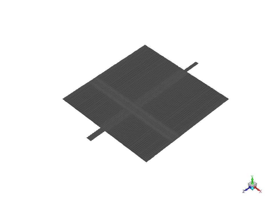

we have applied CHF boiling model to our multi-domain jet impingement geometry with heated solid as target plate. Model is applied on 2D axis symmetric single nozzle with successive convergence. Now, we are trying to implement same model for our 3D geometry, here some issues are occurring.
Fluent console is giving divergence when flow approaching towards solid domain. This problem is only observed when Boiling model is switched ON. When Boiling model is switched OFF successful conjugate heat transfer can be observed.Â
Number of meshes and time steps already tried.
February 4, 2020 at 2:29 pm
Rob
Forum ModeratorHow does the flow get around the plate?
February 5, 2020 at 5:24 am
ssshivam
SubscriberSir, its a jet impingement problem. As soon as the flow hits the solid plate, its diverges (blows up). Hence flow around the plate cant be observed from simulation.
