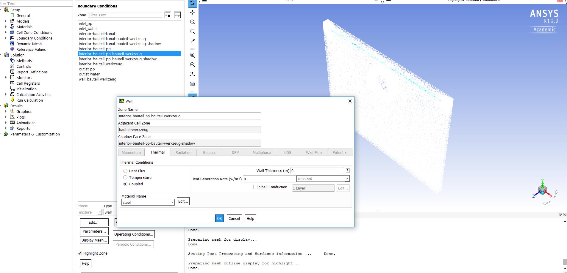

      Please post screen grabs of the thermal tab of the wall that separates the liquid & solid.
    • Jackely
       Many thanks for your answer
      I see now that that wall is deifying as Coupled.
      shall I define the heat generation rate?
      I have 4 walls in total!

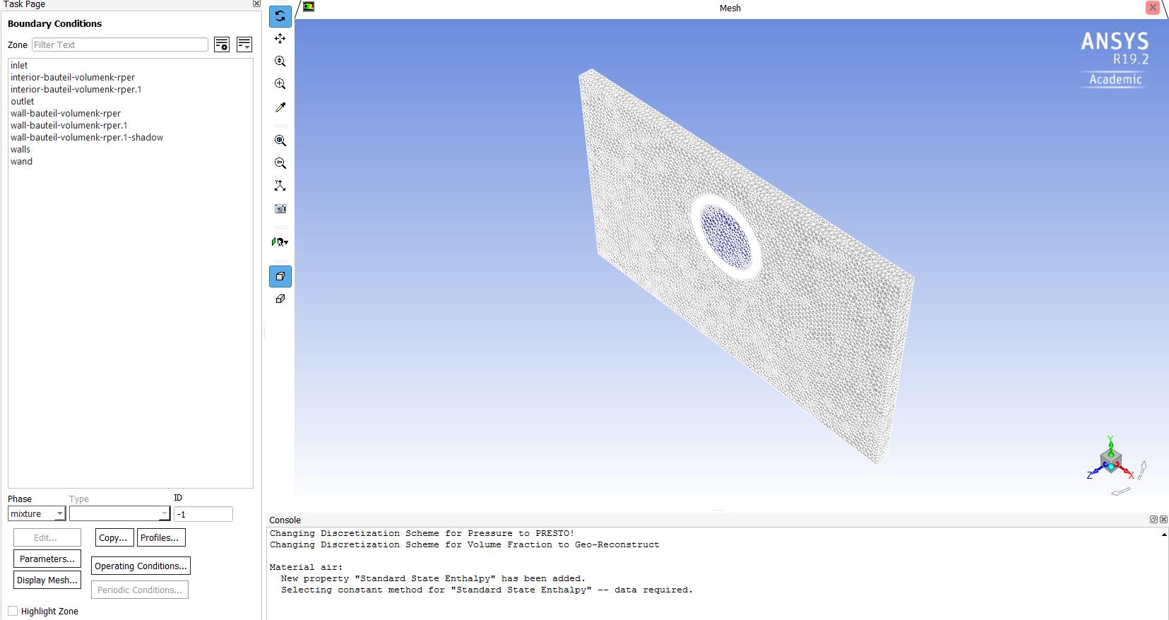

    • Jackely

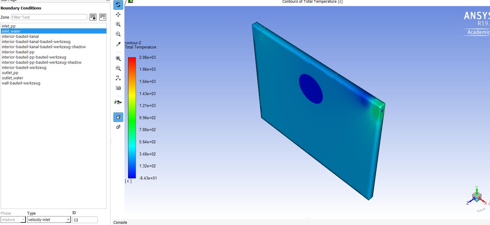

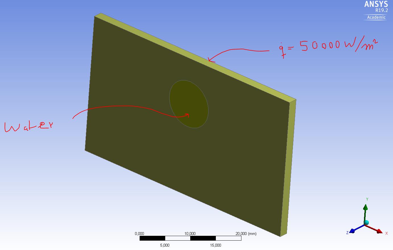

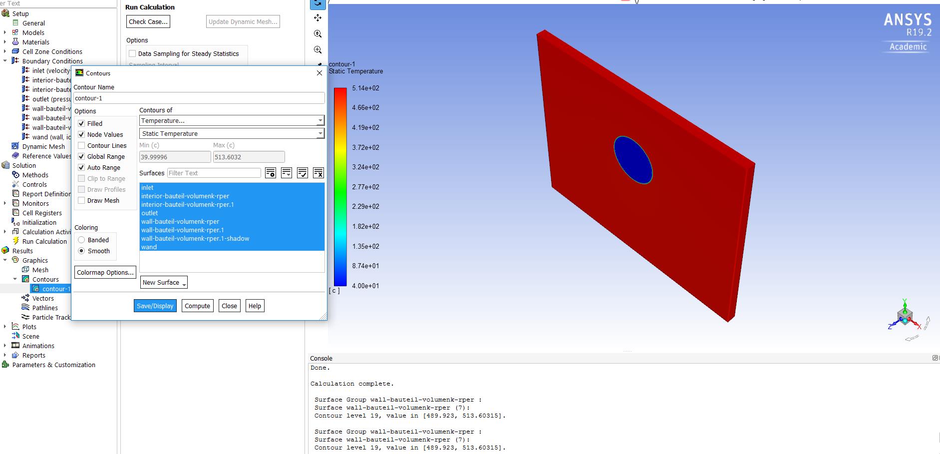

      I modified the boundary conditions and created a new geometry.
      I've activated three models: Multiphase, Energy and Viscous k-epsilon.
      a heat flux density of 50 000 W/m^2 flows along the wall.
      But the result does not look realistic (see last picture).

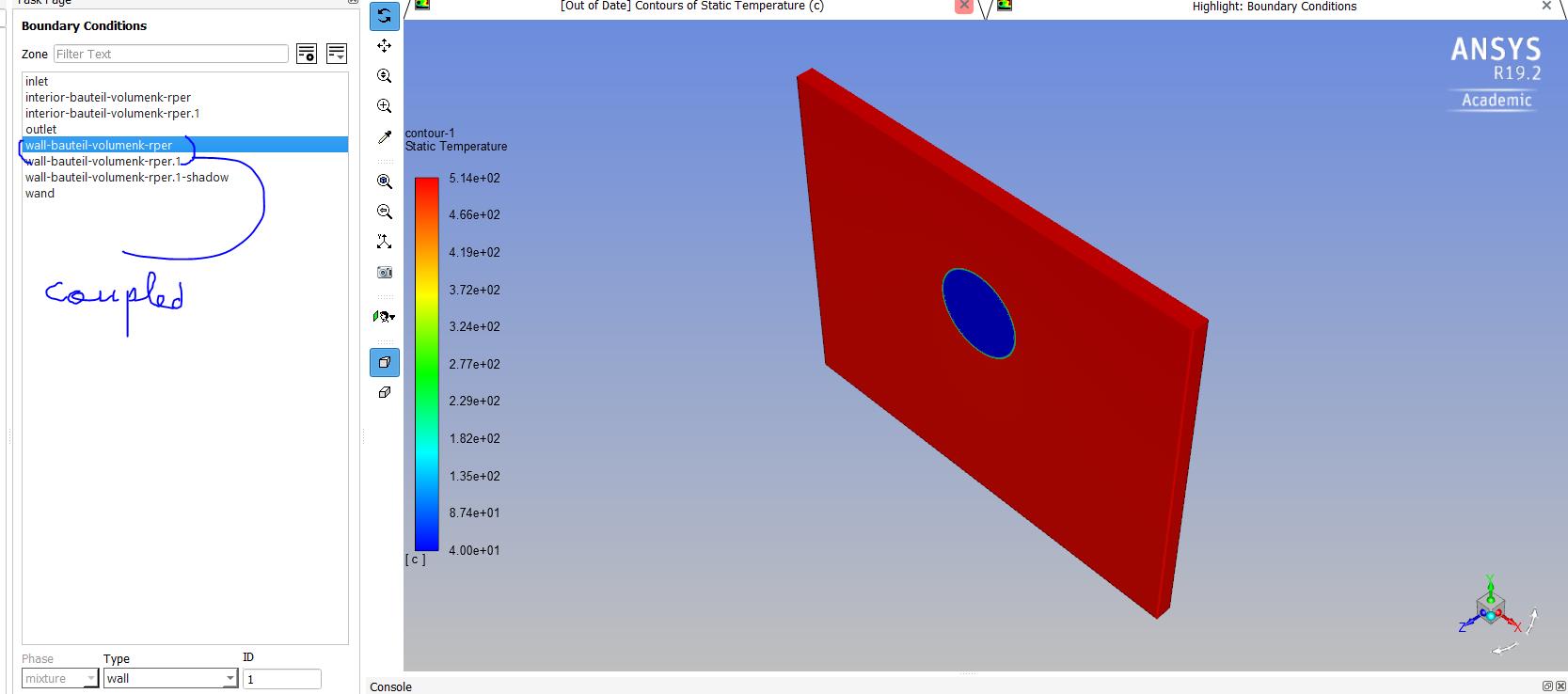

    • DrAmine
      Are you doing the full run in Fluent? Or are you coupling to structural/thermal?
    • Jackely
      i do full run at Fluent. into canal flows water by speed of 2m/s and 40°C and upside at wall affects heat flux density of 5 w/cm^2
    • DrAmine

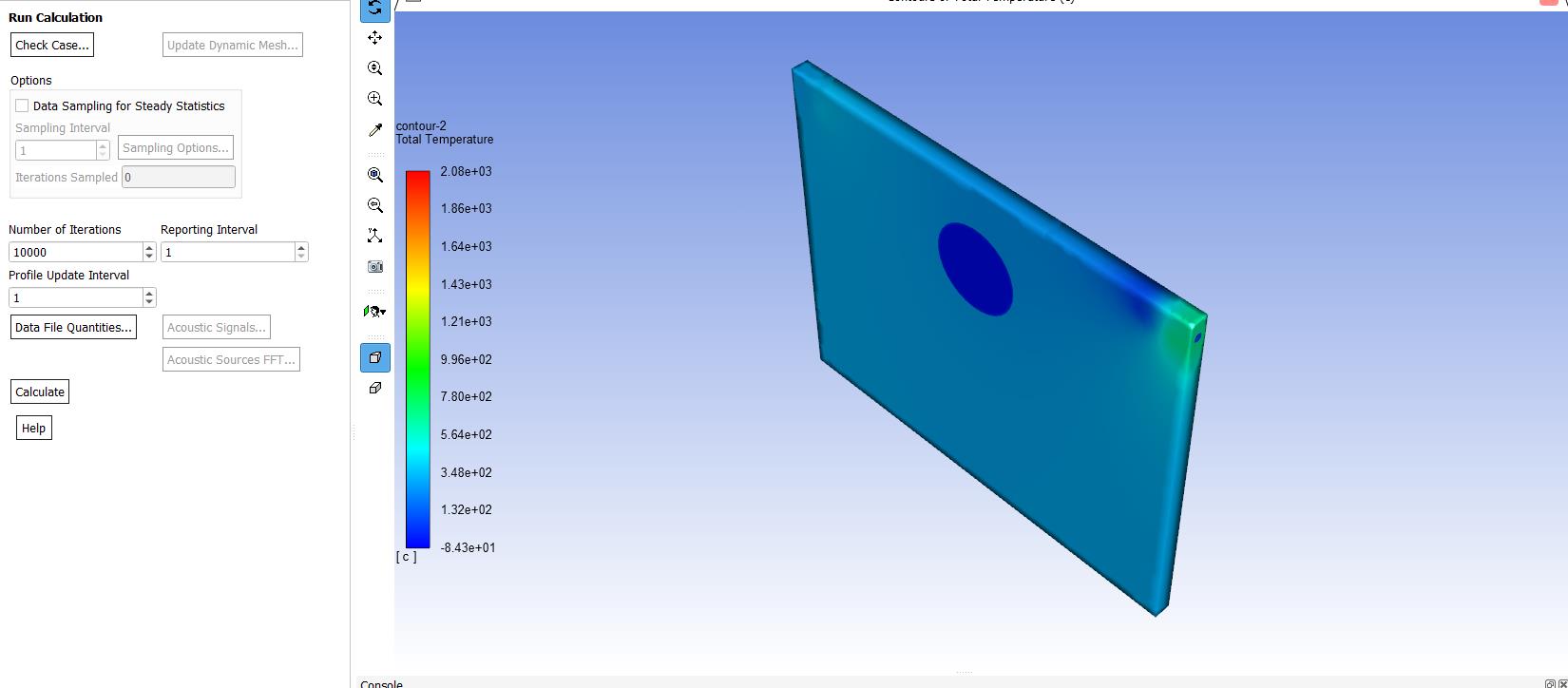

      Okay so water is located in that cylindrical part. If you want to visualize the temperature at the solids you need to use Static Temperature. Total Temperature is only defined for Fluids.
      Start at first without multiphase: just check if your setup makes sense.

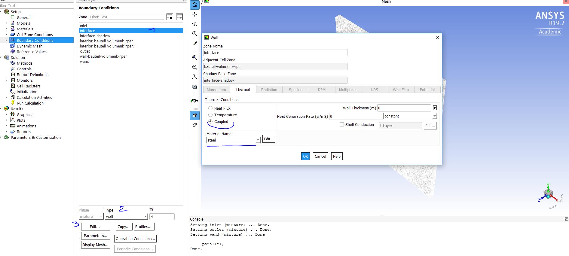

    • Jackely
      Thanks for your answer.
       i have now only activated the energy and k-e for Models
      I have researched the internet, and most of them say that the problem could be with the interface.
      i have defined the two interfaces as a wall (Coupled).
      The results are still not realistic.

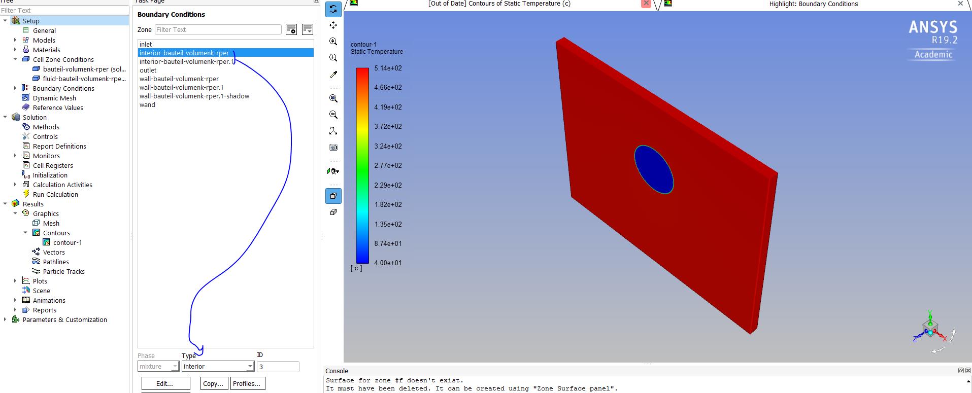

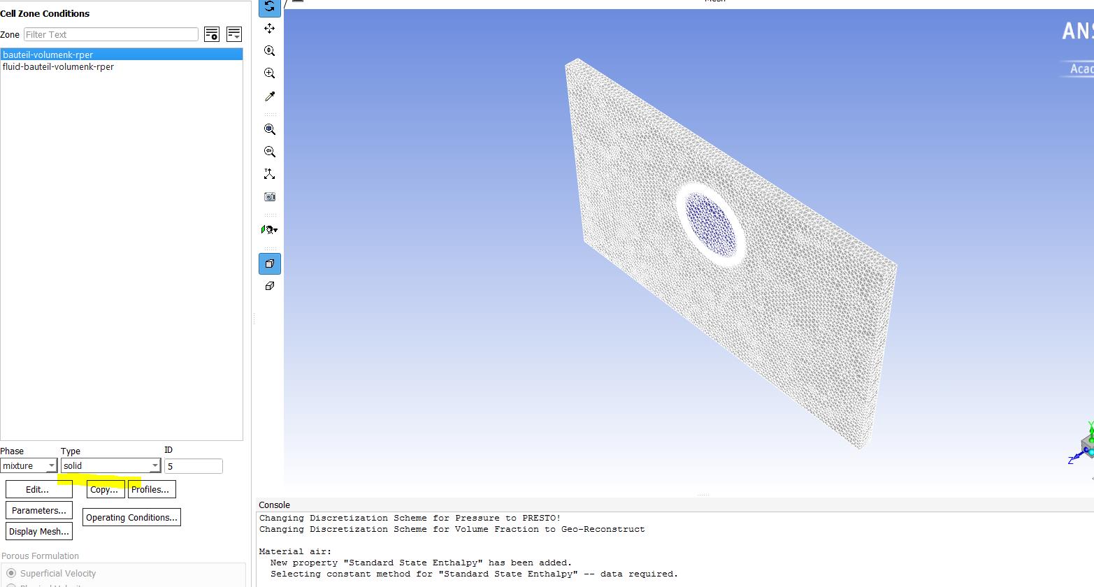

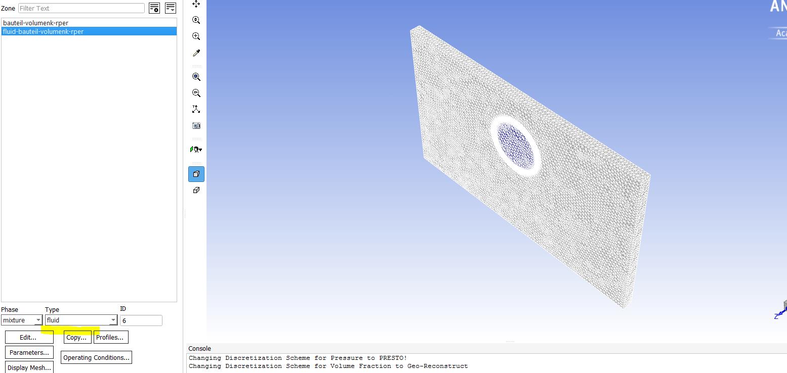

    • DrAmine
      But you do not have interfaces you have interior cells. Please do not change that type. Please show mesh lines to check if the mesh is conformal
    • DrAmine
      Please go to Flux Flux report and screenshot total heat transfer there as well as mass flow rates.
    • Jackely
      That's right, I don't have an interface.
      these are the pictures

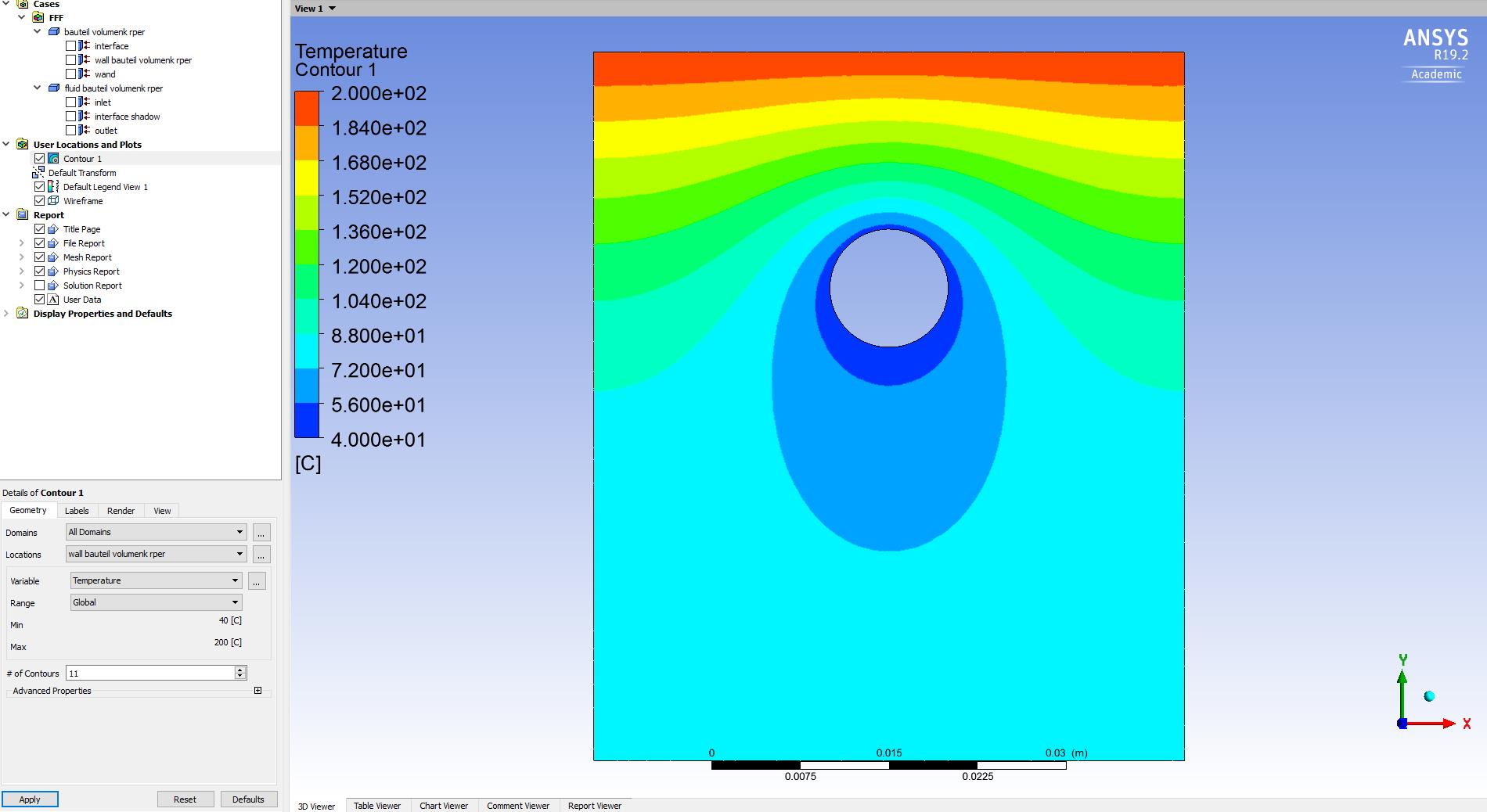

      I do not understand. You have a heat flow from solid to fluid so it is working. You can post process the temperature at the wall on the fluid side and its shadow on the solid side.

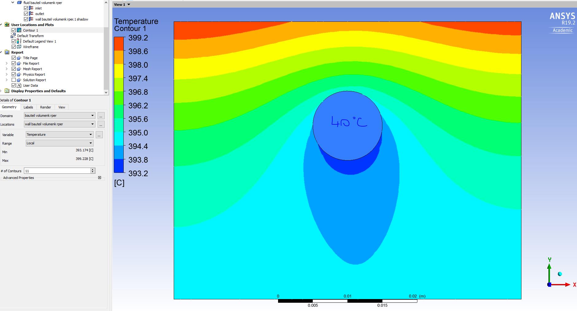

    • Jackely

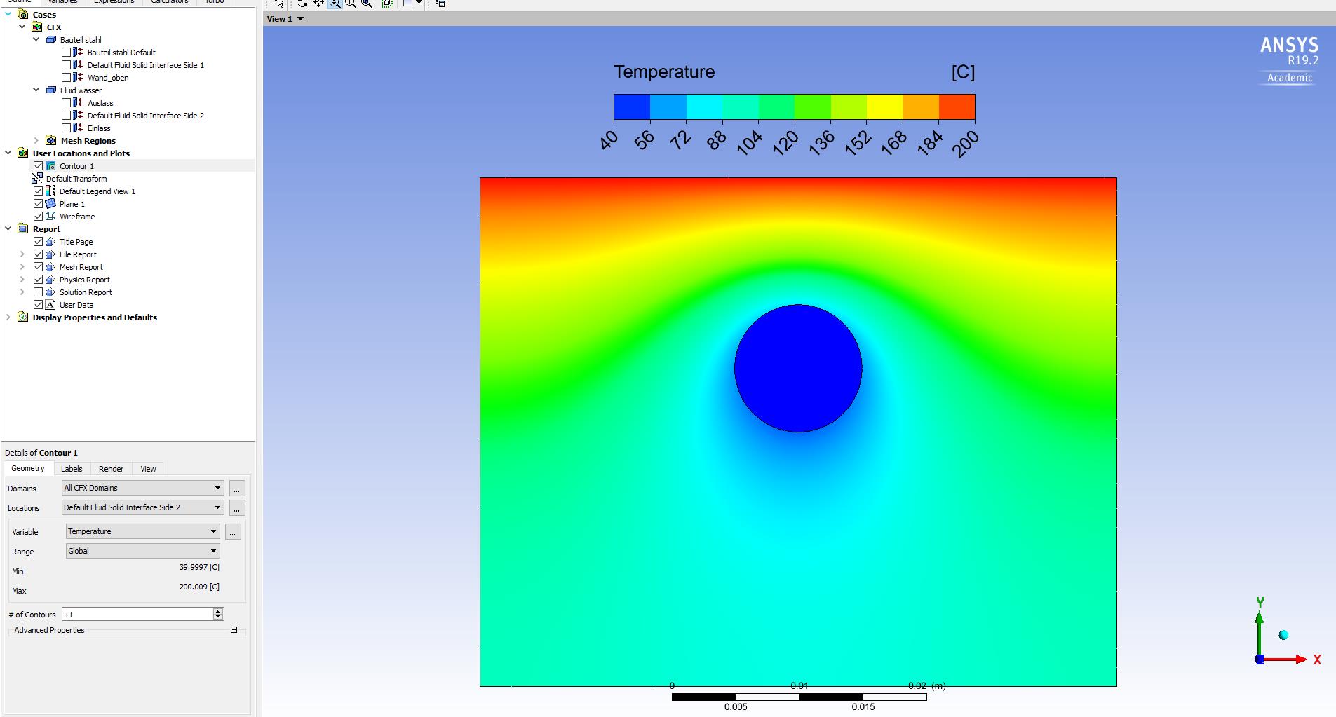

      i have now shown the temperature distribution, the distribution looks relaistic, but the values do not.
      Water temperature should actually only be 40°C.
    • Jackely
       with CFX The results look different.
    • Jackely
      Thanks for your tips

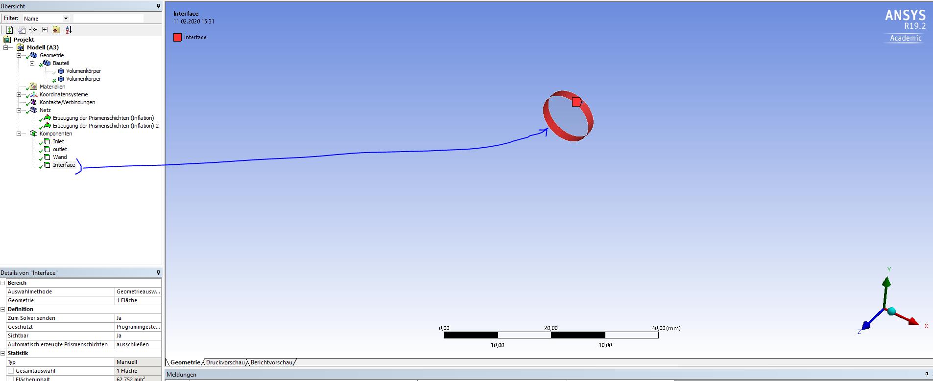

      The problem is solved, I defined a surface at Fluid (and called interface)
      and then changed interface to wall and defined as coupled.
