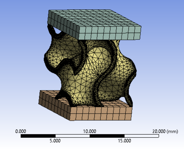

I want to simulate the compression testing of a gyroid unit cell using two rigid plates at the top and bottom. For this, I have imported the gyroid unit cell from nTopology and made bonded connection with two rigid plates at the top and bottom. The material used in the gyroid unit cell is Titanium alloy NL. But after running the simulation I am getting an error message which says:
"Element 30896 located in Body "Solid Body 1(External Model)" (and maybe other elements) has become highly distorted. You may select the offending object and/or geometry via RMB on this warning in the Messages window. Excessive distortion of elements is usually a symptom indicating the need for corrective action elsewhere. Try incrementing the load more slowly (increase the number of substeps or decrease the time step size). You may need to improve your mesh to obtain elements with better aspect ratios. Also consider the behavior of materials, contact pairs, and/or constraint equations. If this message appears in the first iteration of first substep, be sure to perform element shape checking. Named Selections for the offending element can be created via the Identify Element Violations property on the Solution Information Object."
I have already tried with auto time stepping ON and increasing the number of steps for the load. But I am still getting the same error message. Can anyone please tell me how I can rectify the error and run the simulation successfully?
The screenshot of the model is shown below.
Thank you in advance!!

Ansys EmployeeHi Ranjan You have the ability to store intermediate results - do you have any substeps that have a converged solution? If you review intermediate results, it may give an idea of what is happening to the model.
Also, what kind of contact do you have between the rigid plates and the gyroid part? If it is frictionless contact, the part can move laterally and have rigid-body motion. Do you have any constraints preventing rigid-body motion? Using frictional contact can work instead, as the coefficient of friction prevents motion in the lateral directions.
Lastly, the rigid plate seem to be the same size as the gyroid part. You may wish to make the 'rigid' plates bigger to prevent the possibility of some nodes of the gyroid slipping off.

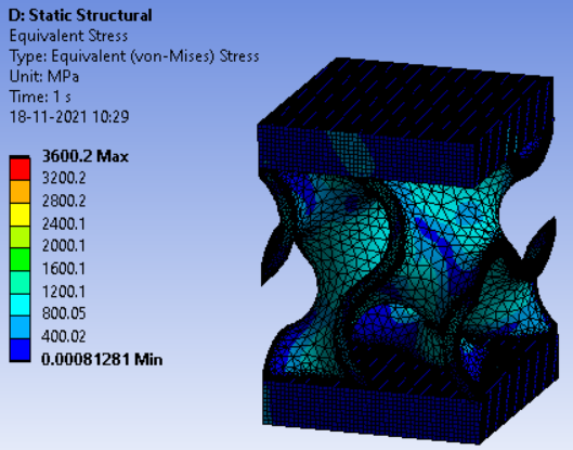

Yes I tried solving the problem using the Bonded contact between the plates and Gyroid structure. I was able to find the solution in this case . Please find attached the model of the assembly along with results.

If you are using bonded contact, that is similar to situation of frictional contact with very large coefficient of friction ("mu"). Using frictional contact just introduces the possibility of sliding occurring whereas bonded contact prevents any relative sliding between your gyroid structure and rigid plate.
If the plates have high stiffness, they will probably be rigid. You can scope results just on the plate to be certain that the plate has no local relative deformation. In such cases, you can actually use a much coarser mesh to speed up the solution, and you don't need to increase the thickness. Increasing the lateral dimensions of the plate is only needed if you have frictional (or frictionless) contact since relative sliding can occur between gyroid structure and plate.

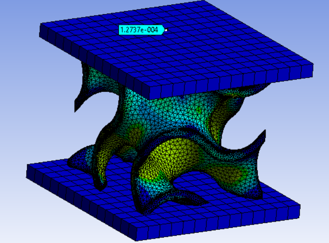

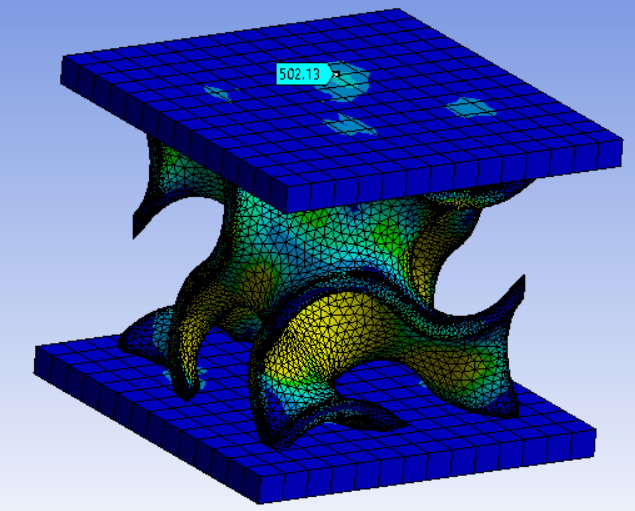

SubscriberHi Sheldon Thanks for the reply! I tried to change the modeling of my design as explained by increasing the lateral dimensions of the plate. I have also changed the contact type to frictional with mu = 0.01.
But I have got some strain and stress values in the plates as shown in the figures below. But I don't want any stress/strain values on the plates as I want the plates to behave like a rigid body.
I had previously tried two ways to define the plates as rigid:
i) By defining the stiffness behavior as rigid under the Geometry tab. But doing so, couldn't generate the surface mesh on the connecting side of the plates which are required to connect with the flexible gyroid (I imported the Gyroid mesh from nTopology)
ii) By increasing the elastic modulus of the material used in the plates to a very high value (2e20 MPa). But using this material failed to converge the solution.
So, please let me know if there is a better way to define the plates as rigid and perform my simulation.

Ansys EmployeeHi Ranjan You could try prescribing the boundary condition on all of the faces of the plate. Keep the plate with a relatively high elastic modulus (but not too high - 100x your gyroid structure is fine), and put the boundary condition scoped to all surfaces of the plate. That will prevent any relative deformation in the plates.
