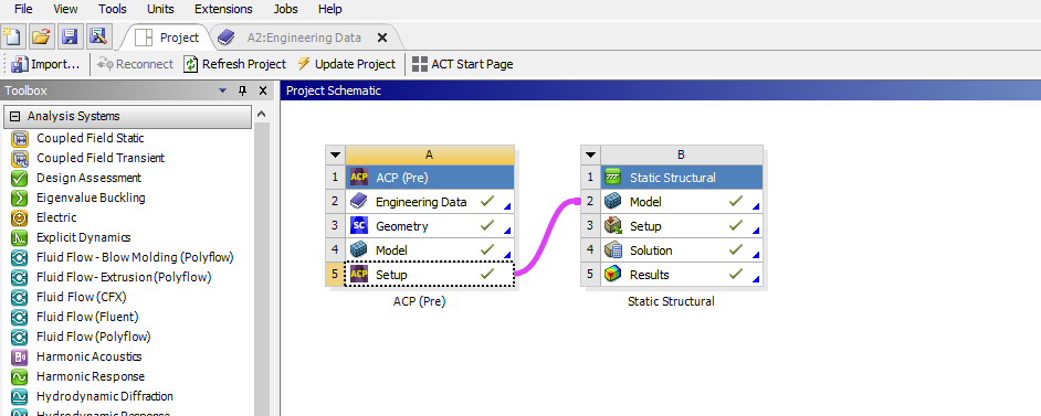

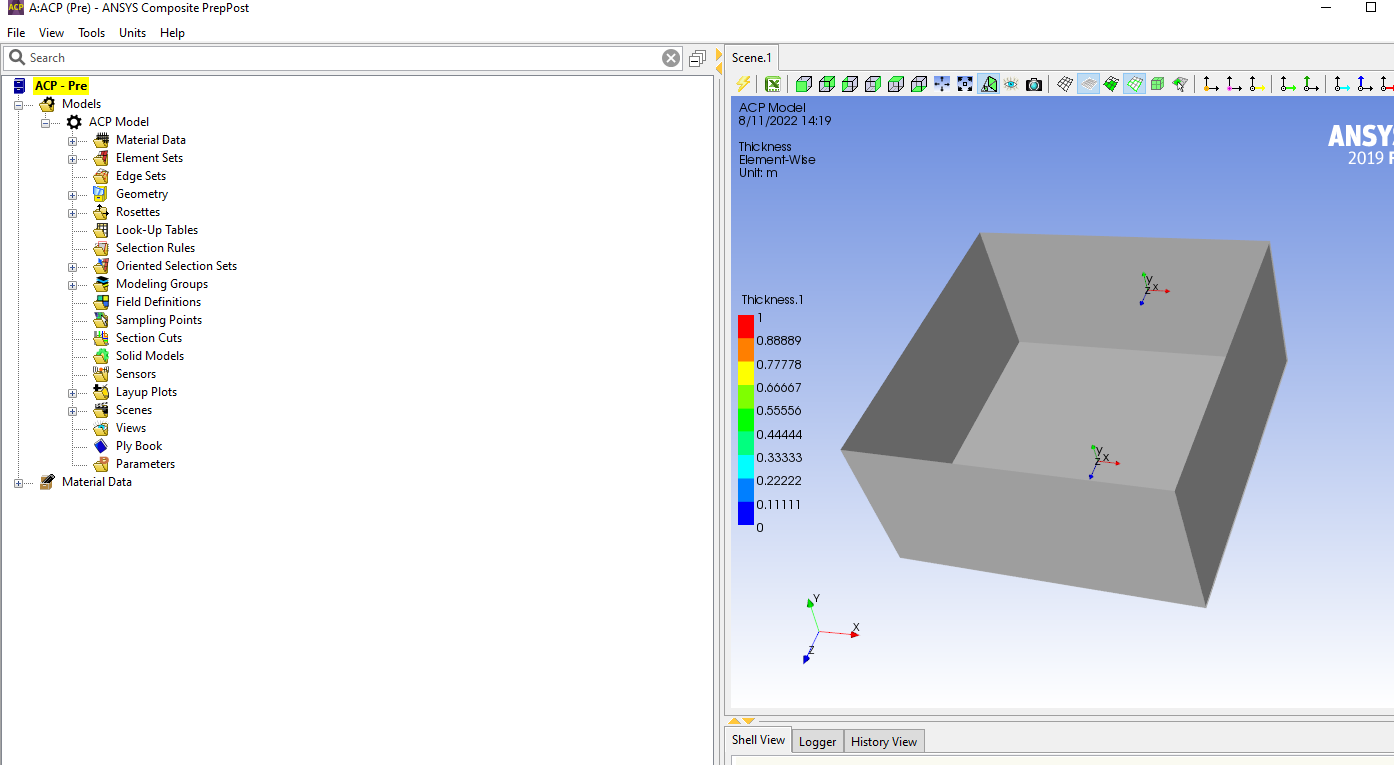

SubscriberHey thanks peter for reply..i must tell that these all parts say 15000 will be composite structural memebers in case of ship application.
i doubt if Composite ACP pre is suitable for such big assembly?
it looks to me slow process in ACP in defining plies and create laminate(sandwhich panel)?
what your views, is it possible to such big assemby in ACP Pre?
i also have one simple approach, instead dong detail material applying procedure to these 15000 parts by assigning indiviually plies and than make stack & finally composite part, i can use equivalent thickness and inertia approach to get equivalent required quality wiithout going in ACP by doing orientation of plies and stack stuff...but i am not sure hw good wil be than resultant stressess(my target results)??
Also just want be sure that for composite, we can judge stress by von mises or not? i am just interested in yield point of composite assembly.

SubscriberACP/Pre is very useful for layups on complex 3D shapes.
Structures bonded together from flat or cylindrical composite sheets and ribs don’t need ACP/Pre. Look up Defining and Applying a Layered Section in the Mechanical Application chapter of the ANSYS Help system. Insert a Layered Section into the Geometry branch of the Outline. In Engineering Data, add the Composite materials such as the Unidirectional Carbon Fiber Prepreg. In the Worksheet for the Layered Section, you can define the layup of plies. Each ply has a material, thickness and angle. Create as many plies as needed: 4, 8, 16 etc. Now you can select as many sheet body faces as you want for this Layered Section. You have a short list of unique layups. Create a Layered Section for each layup and give it a meaningful name. Select the faces that apply to each Layered Section. In this way, the correct composite material properties will be assigned to each sheet body of your structure.

To follow on to this discussion. Von Mises is not used for the strength evaluation of laminates/sandwich(of different materials and orientations). You would wish to use one of the composite failure criteria, with the simplest being max stress or max strain, but there are other that have interactions (Tsai).
Also, I agree with the approach Peter suggested, but one could also use named selections and a handful of oriented element sets and modeling plies to create layups on many parts at once. So it can handle large assemblies.
