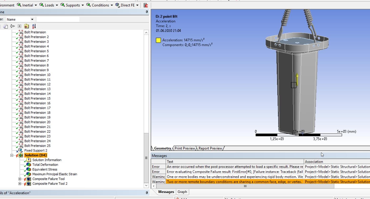

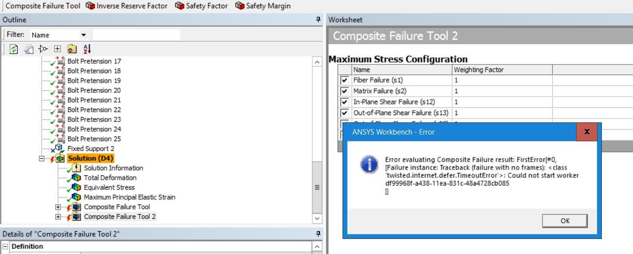

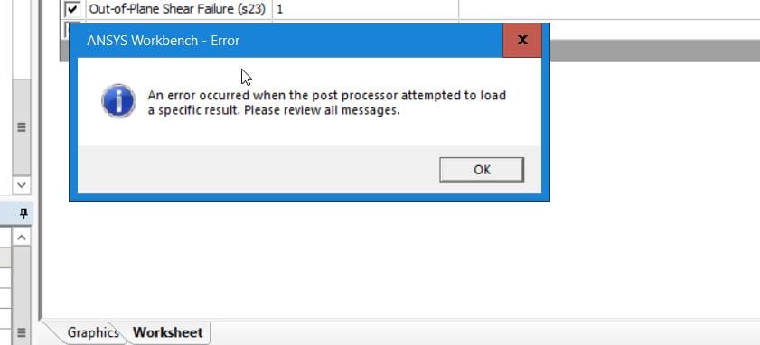

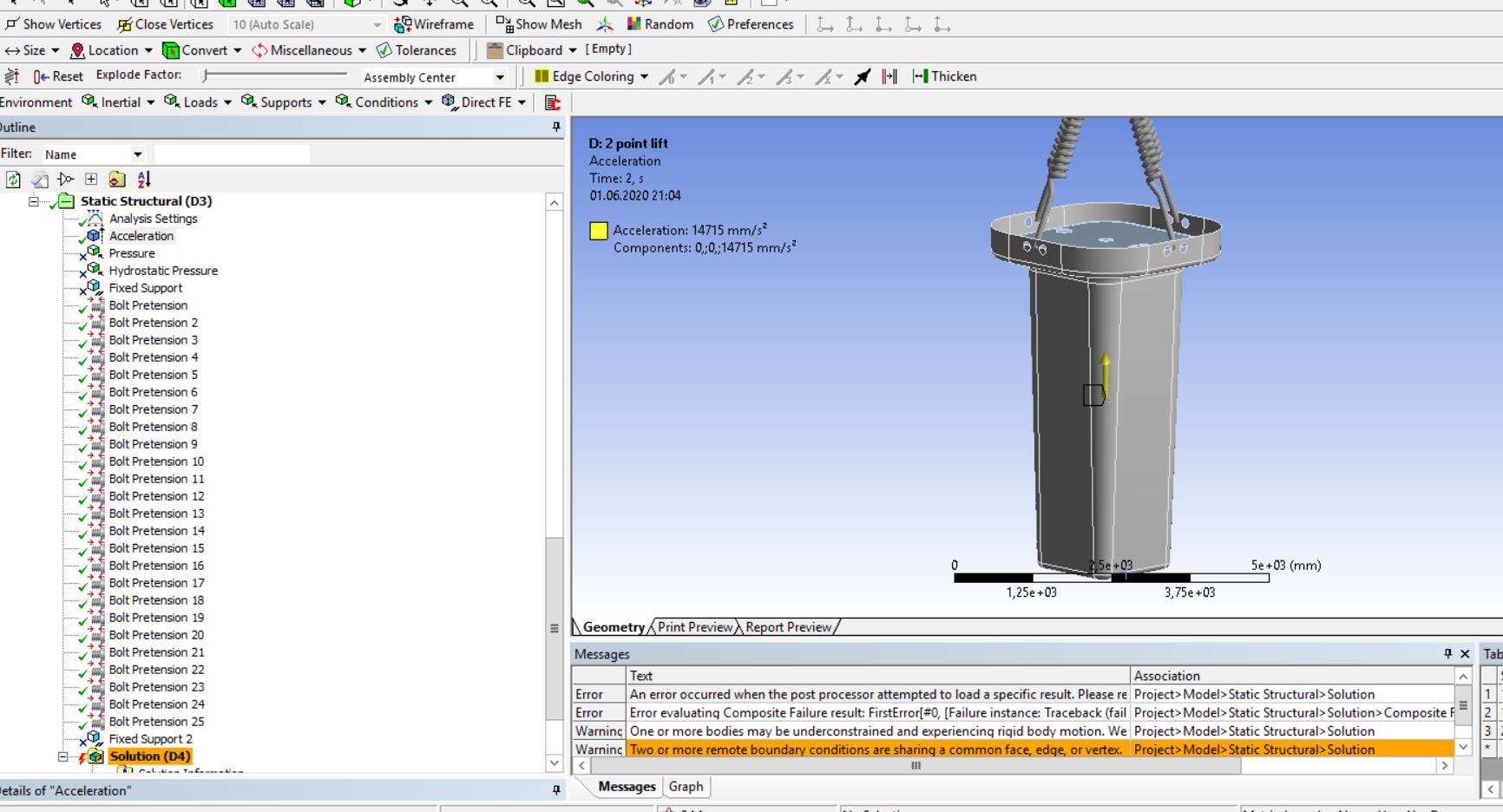

SubscriberHi, I have issue with running analysis, it works ok, but at the moment when I try to extract results for composite materials, then I cant get results.
I do not understand the reason, the model in ACP Pre looks fine together with layup, but when I run it, it fails.
I was told that the issue can be with upstream ACP model, but i do not understand what it is.
Can somebody take a look and please advise me on this matter?

Forum ModeratorThanks for the detailed post.
It seems like the analysis is solved but there is some issue with the composite failure folder is failing. Can you try to delete all of those and insert them again and see if that helps?
I checked our database for the error but did not get any hits on the error for the message.
Can you start ACP, maybe check with a very simple project and see if that works.
-Aniket

Subscriberthanks, i do not remember how, but I managed to solve it.
However it take som much time to define bolts with pretension,
At the end, I needed to delete all %appdata% to make ansys work, maybe this has helped to the error above.
