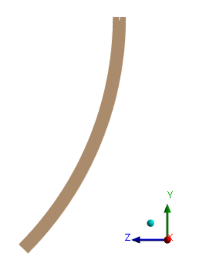

I'm trying to find the compliance factors of a curved beam flexure. The geometry is a simple curved beam (R=30mm, angle=45°) with a rectangular shape section (w=6 mm,t=1.2mm), like that:
I fixed one end and applied the force vector components (one by one) at the other one; then, I measured the displacements/rotations at the free end and divide displacement by force (or rotation by moment) to obtain the compliance factors, but I dind't get the correct results.

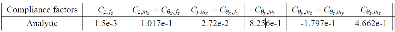

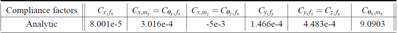

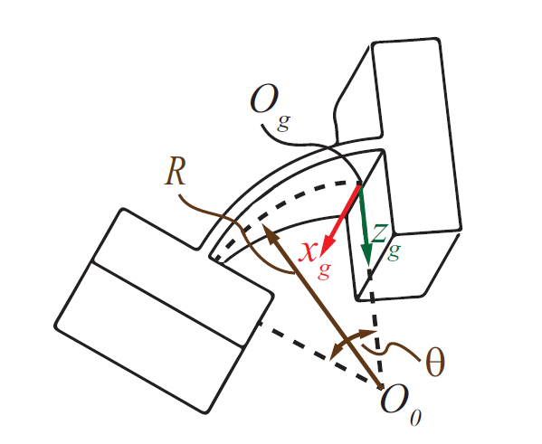

The correct compliance factors are analitically calculated (m/N or rad/Nm) compared to coordinate system "g" fixed at free end (like in previous picture, where x_g is red and z_g is green):
How can I do to obtain the same results with a FEA?

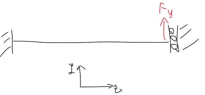

To calculate compliance factors for a straight cantilver beam you have to apply the components of force vector (one by one) at the free end constraining all the others DOFs. For ex., to measure compliance factor Fy - y:
The boundaries conditions are: fixed support at one end and sliding climp at other one. Solving the equation of the elastic curve of a beam, you can find the relationship between Fy and y (stiffness Fy/y, compliance y/Fy..)

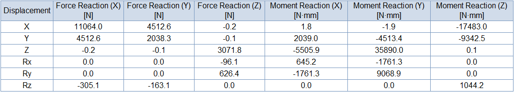

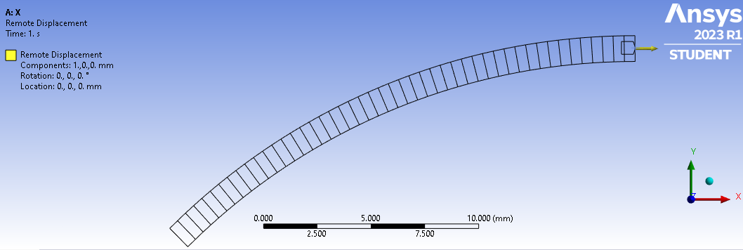

SubscriberYou are describing what I call a stiffness matrix. The lower left end of the shell mesh is a Fixed Support. I displace the right end with a Remote Displacement, Behavior = Rigid, keeping all other DOF = 0 except for the one unit value.
I will skip the other three load cases. In each case, I Probe the Force and Moment Reactions of the Remote Displacement.
This is a stiffness matrix. The inverse of this is the compliance matrix. This is for your geometry using Structural Steel.
Note that Finite Element Models are an approximate solution. Better approximations are obtained when the mesh is refined.
This model gives results that are closer to the expected zero values for the moments about X and Y.

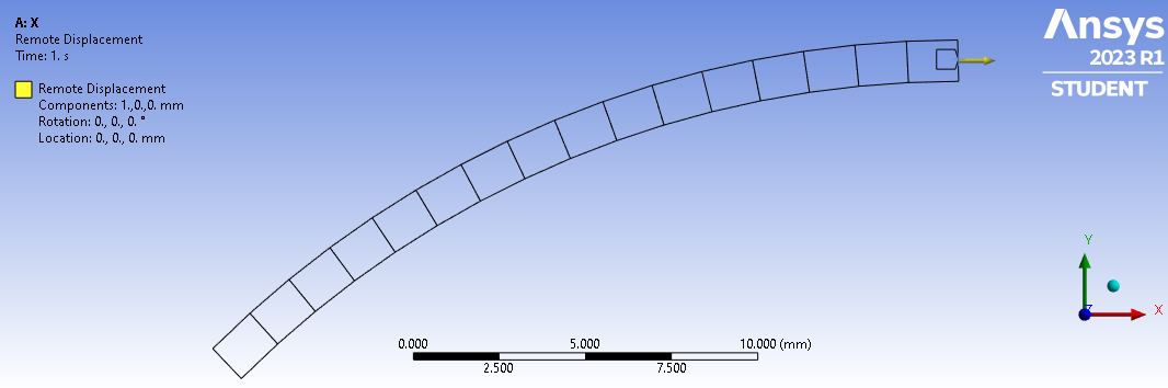

Subscriber- I used SpaceClaim to draw an arc, then extruded that into a sheet body with a width of 6 mm.
- That sheet body was meshed with shell elements and assigned a thickness of 1.2 mm.
- If I had used solid elements, a minimum of 4 elements through the thickness is required if using linear elements.
- Don't use Large Deflection. You want the stiffness/compliance for small displacements/rotations from the undeformed geometry.

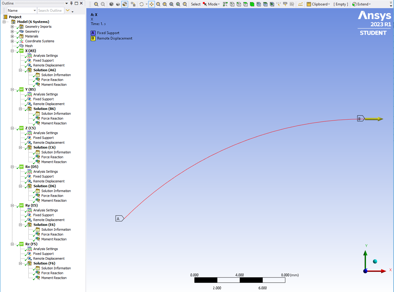

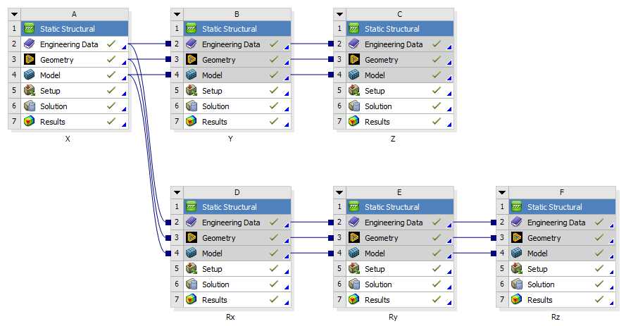

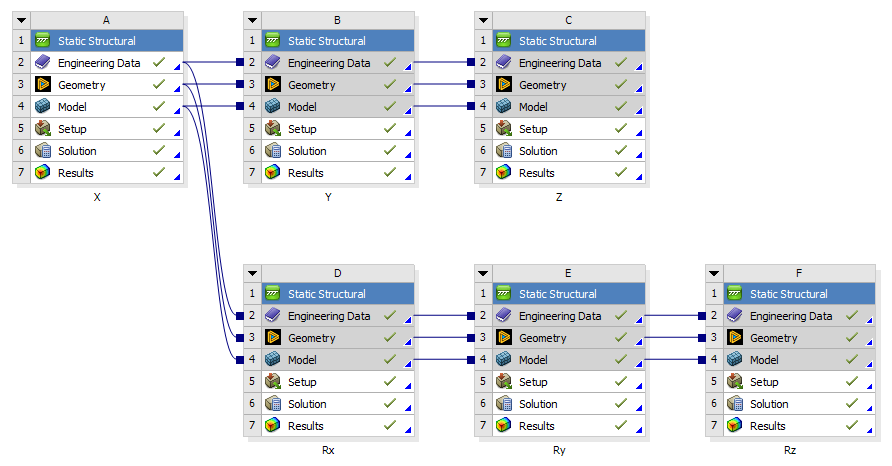

Use six Static Structural models to solve the six load cases. Do this by using a Drag and Drop onto the Model cell so they all use the same mesh. Note: to open Mechanical, you must double click on the A4 cell and not the B, C, D etc Model cells.
Inside Mechanical, you can see them all. You can drag and drop the Fixed Support and Remote Displacement from the first system to each of the other five Static Structural branches, then edit each Remote Displacement to move the unit displacement from X to Y to Z etc. You can drag and drop the Force Reaction and Moment Reaction probe from the first system to the other five Solution branches.

SubscriberDrag a new Static Structural out of the toolbox and drop it onto the Model cell of your first Static Structural analysis. Repeat this 4 times.
Open Mechanical from the A4 Model cell. Drag and drop the Fixed Support and Remote Displacement on every Static Strucural analysis, and edit each of the five Remote Displacements to move the unit displacement down the list of DOF.
