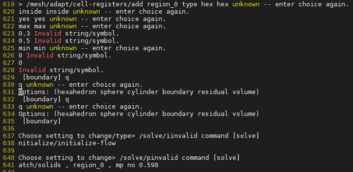

SubscriberSo, I was able to compile the udf, although I have an issue in one of those adapt/cell-registers command mentioned above.
It works fine on the windows testing phase, but, fails on the batch submission. Could you help?
This is the console output on the batch submission,
same command on the windows run, is
So I know this thing works there, but not on the cluster. Could you help?
Example is example 24 of fluent 22 manual./file/read-case /scratch/aus1n19/for_davidB/udfexample/fluid-bed.msh

q/mesh/adapt/cell-registers/add region_0 type hex inside yes max 0.3 0.5 min 0 0

Ansys EmployeeTry entering the full command (TUI might be auto-completing your arguments).
/mesh/adapt/cell-registers/add region_0 type hexahedron inside yes max-point 0.3 0.5 min-point 0 0
"inside" might need to be replaced as "inside?", I invite you to try this.
One way to test what the full command should be is to write it in the TUI as multiple lines. The TUI will then suggest to you the full input.
For example,
region_0
type
hexahedron
inside?
yes
max-point
0.3
0.5
min-point
0
0
