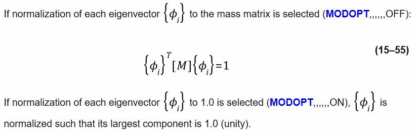

    • Surendrasg1
      Can I know, how the mode shapes are normalized conducting Model Analysis in Ansys Workbench?
      You can choose between two normalizations and I think the mass matrix is the default.
    • Surendrasg1
      Thank you peteroznewman for answer. But how to change the option to normalize making largest component to Unity in Mechanical Workbench 19 R1.
      Click on the Modal branch of the outline, click on the Environment tab in the ribbon, click on the Commands button.
      The Worksheet will replace the Graphics window where you can type the command shown below, which requests 12 modes, then you can Solve.
      MODOPT,,12,,,,ON

      I've tried to run these two different normalization methods to the same pre-stressed model together with the maxpand. Element stress results are both available and they seems to be in a linear scale relationship. I doubt the stress outputs are based on the model shape displacement fields applied to the structure. If so, then the stress results are not really meaningless, however I'm not sure whether the large deformation is considered since then the structural stiffness is not linear. Can anyone here confirm this?
      Regards
      Zach
      MODOPT,,12,,,,ON
