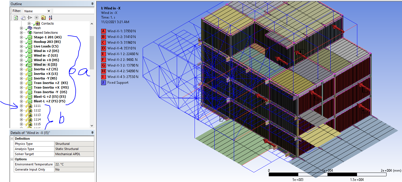

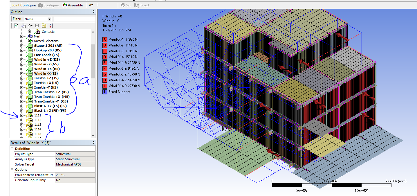

      I am performing static structural analysis of offshore Living Quarters module in Ansys 19 Workbench.
      We have multiple basic load cases and I have created multiple solutions for each set of loads as shown in below screen shot.
      These basic load cases are combined with respective factors in “Solution Combination”. We have around 50 to 75 such combinations for different directions of wind and inertial loads for different return periods.
      I want to see summarized results from all these “solution combinations” as different elements will be stressed differently in each case.
      Please let me know how I can get the summary of stresses, reactions and deflections.
      Please let me know if you need any additional information.
      Please see attached screenshot of the model. (a) is basic load cases and (b) is 'solution combinations'
