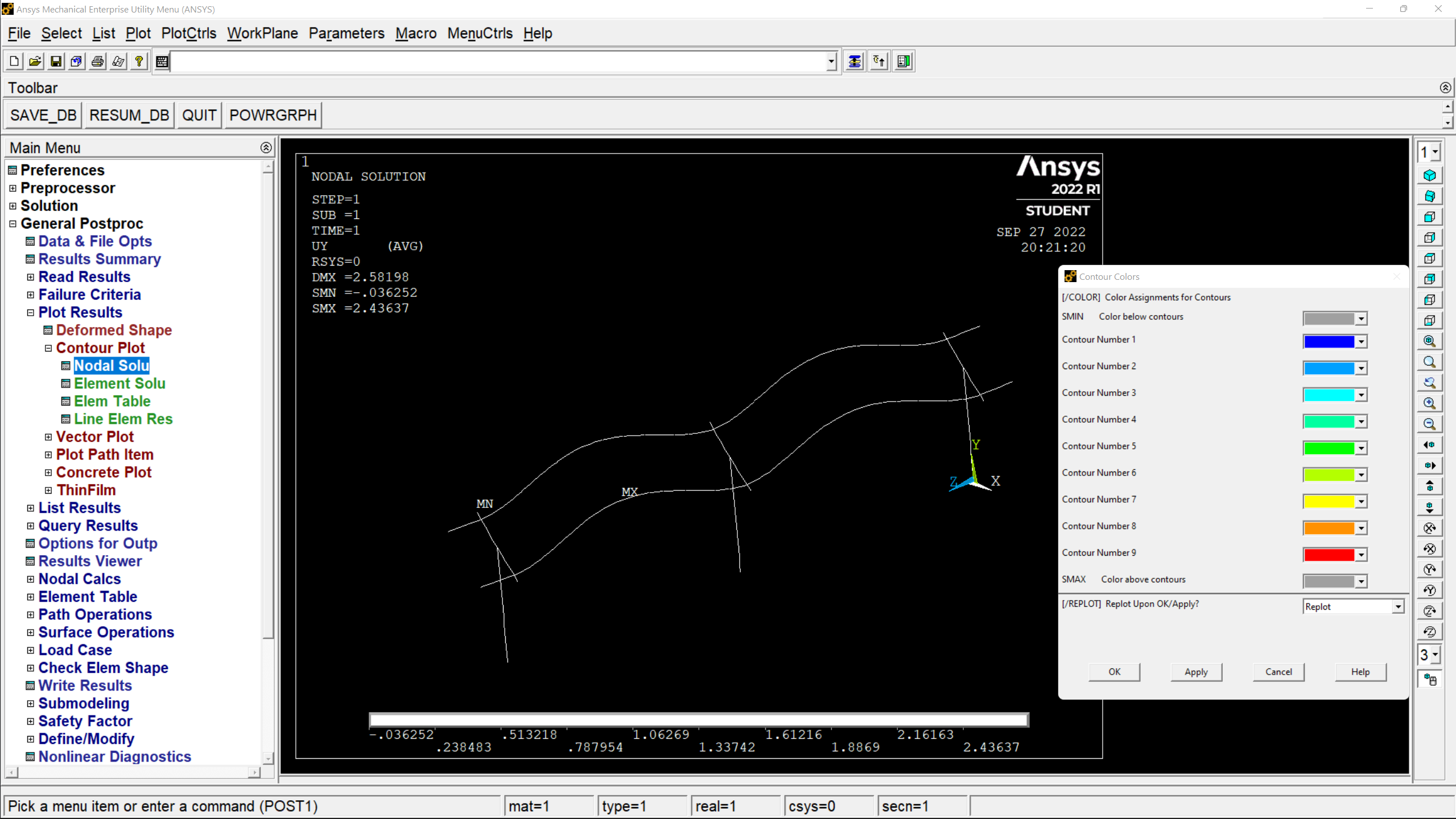

SubscriberHello, I was modelling a simple support for solar panel and eventually came across a problem. Briefly: after inserting all infos about materials and sections, i created the kps and all of the lines. coupled dofs of purlins with beams and inserted a gravity load on the structure. The problem is that no matter the stress or displacement i want to check on contour plot, i can't visualize colours, everything is white (also values are definitely off).

Issue:
/COLOR, DEFA
to go back to default settings.
Hope this helps

poldsnake
SubscriberI tried but nothing. By the way I never modified any of the colour table. Any other suggestions?

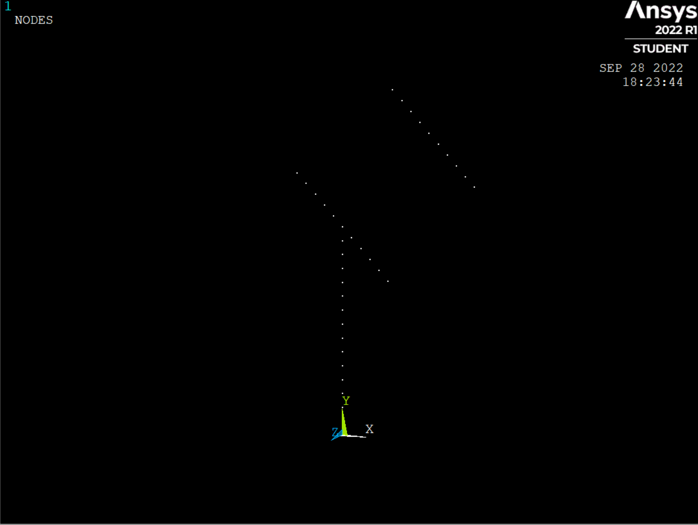

Well, thank you anyway. I have another question, I was trying to redo the exercise for the 1000th time, is it normal that whenever I mesh the inicial structure I get 2 lines of nodes for the oblique beam? For your information: I used beams188 for all of the elements, an Omega section for the oblique beam and a HEB100 for the vertical pillar. I dont know which nodes i should choose when coupling dof’s with the purlings. Also I used an external Keypoint to orientate the section.
